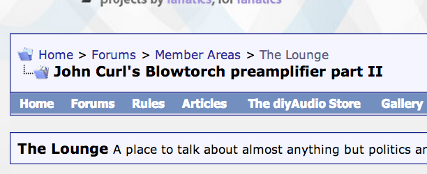

I will help, give me a sec.
Click on forums above. Pick a forum. Click on 'new thread'. Use the search function to see if the topic already exists. If not continue with the new thread.
