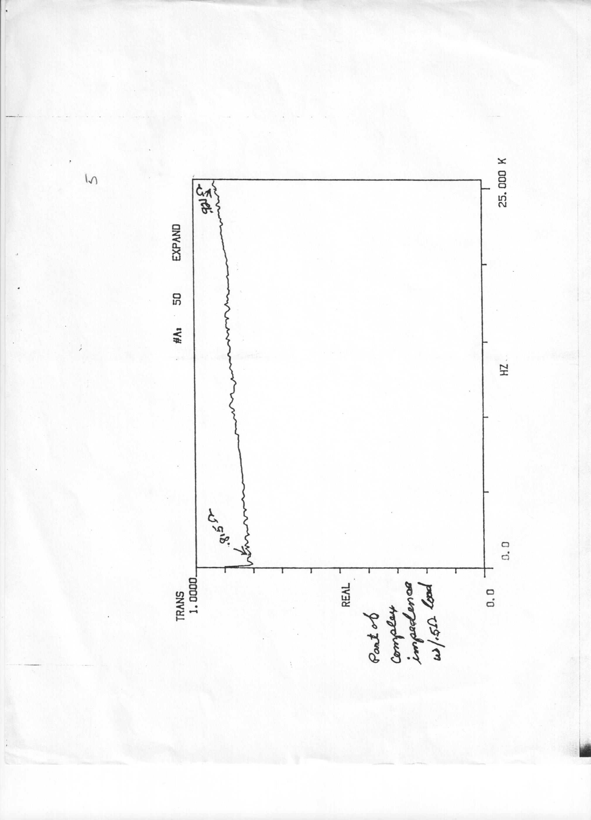

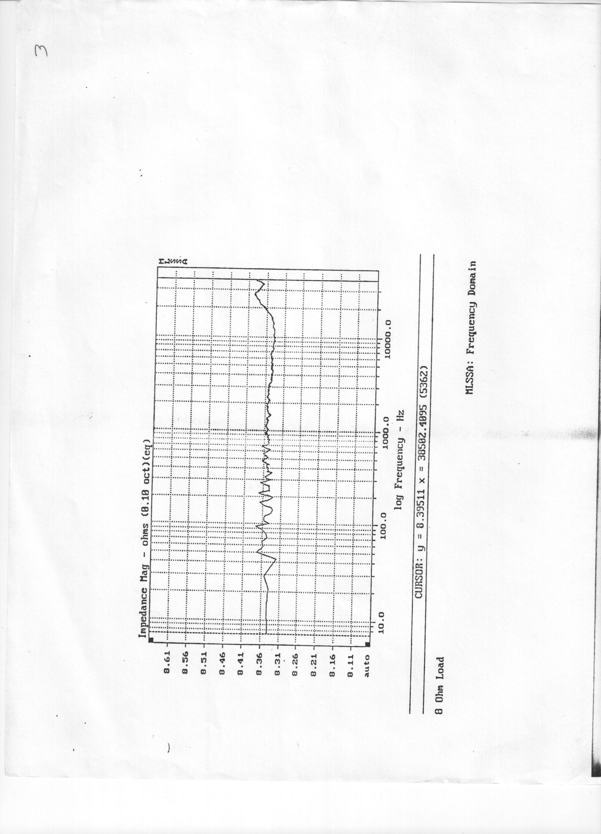

Tommy1000, just to keep speculation to a minimum, this was what earlier devices measured about 20 years ago. The resistive value was about 0.3 ohms then. Today, it is 0.025 ohms.

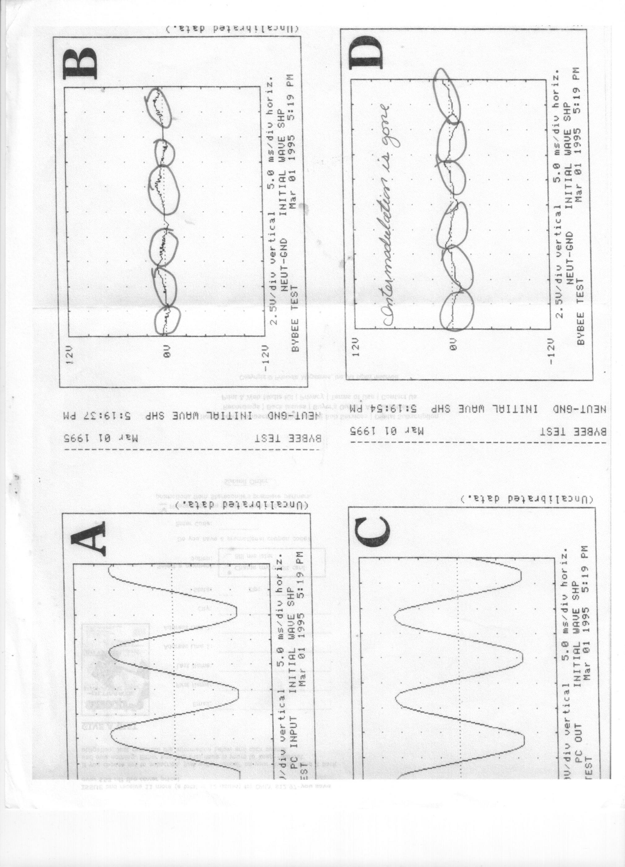

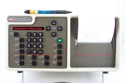

This is a slightly clearer version of the noise test. I was told this was made at Ames Research in or near Mountain View, CA with a BMI 4800.

john curl said:
This is an earlier (20 years earlier) explanation of a Bybee device
That is not an explanation, but a collection of scientific words in valid but meaningless English sentences. It claims to be able to isolate and absorb specific electrons. Two problems with this: signals (and noise) are not carried by specific electrons but by the whole ensemble of electrons; there is no such thing as a specific electron, as all electrons are indistinguishable. Mr. Bybee will have to do better than that if he wants to be taken seriously by scientists.
