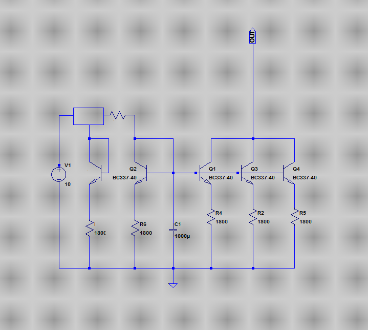

scott what you think about the #44657 circuit ?
Do you see another way to optimize it.
I would like to find alternatives to lm134.
A few ideas from me :
1) replace R6 with a single LM329AD.
2) replace I1 with a degenerated 2SK246BL to 2.7mA.
3) replace V1 with 3x 3.3V lithium batteries, probably with caps in parallel
4) add a 2SK369V to each of Q1,3,4 as cascode, with the gates tied to the top of C1.
Especially (4) will equalise the dissipation of all 4 BJTs.
Patrick

Now you are simply multiplying a floating current source up, sort of begs the question of why not setting up the LM134 for 8mA in the first place.
If you go back to a voltage reference and resistor but stand the reference up on a diode connected transistor you get pretty close. If you use a reference with very low supply current the current density coming and going is pretty close.
EDIT - LT6656 has only 850nA, so stick the diode connected transitor in the ground return of your first circuit and recompute values keeping the current densities all the same. At 8/3mA out of the reference the 850nA will be a trivial error far better than the matching of the discretes. Of course we might have an equivalent part. 😀
Patrick
You could get away with 1 FET with BJT collectors tied. Did you get the gist of that last comment? I should have said take the circuit with 4 BJT's, replace I1 back to a resistor, take a series regulator with very low Isupply and put another diode connected BJT and 1.8k in its ground lead. Now the circuit forces 5V across the R (2.7mA) and all the Vbe's are compensated. I don't think 2.7mA vs 2.70085mA will be your limiting error. 🙂

Scott,
Why is it important that the series reg has low I_supply ?
So that the current can get through the diode connected transistor ?
How low is low ? <<1mA ?
Patrick
Patrick

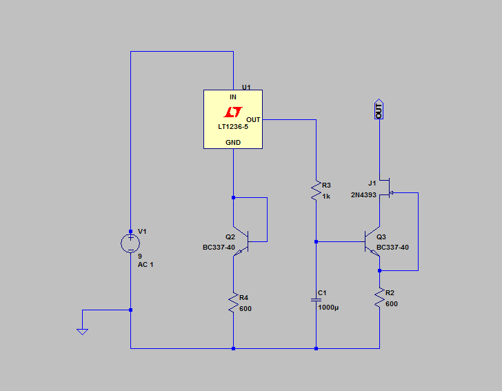

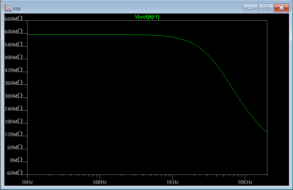

This is what I going to use,
the current variation between 10º and 40º Celsius is only 600nA, and that is less than I was needing.
I may or may not use J1.
To change the current out, alter R5 with ( Iout=1.25/R5 ).
Thanks for all the sugestions 🙂
PS: Q1 and Q2 are dual version.

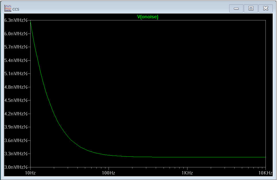

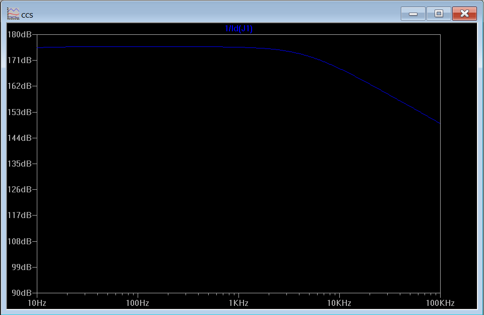

With J1(2n4393) the current variation is only 300nA (10º to 40º).
first image is output impedance
second image is noise in a 350R output resistor.
third image is PSRR.

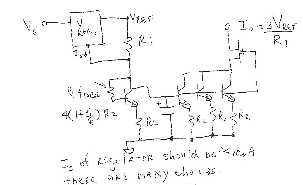

To keep all legs at the same current, I guess I need to provide a schematic.
scott, can not understand sorry. 😕
I guess today Im slow, only with a drawing 😀

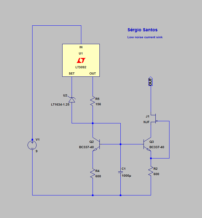

🙂 thanks, Dimitri.
I think the circuit will not work , but give me an idea.
🙂 thanks, Dimitri.
Yes I mis-spoke the reference should just be on top of the diode connected transistor. Also these circuits can have considerable beta errors which can be fixed first order if the betas sort of match. Sorry Dimitri you drew exactly what I said, I just had the wrong picture in my head.
Regulators with <1uA standing current are available, that is far better than one could ever count on matching base currents at 8mA collector current. This circuit wraps up nicely also as floating current source, with care a 2.5V reference could be used and the compliance could be 5V or so with no real penalties. Current is then 4X rather than 3X.
So... you use a 3 terminals voltage reference as a current source .
But that Beta fixer is interesting. I dont find that necessary in #44667.
The circuit I post on #44678 also work quite well, with very low power waste.
The two terminal floating current source is on the LT6656 datasheet in the apps section. It uses a R-R in and out op-amp plus the LT6656, cute circuit.
An ordinary current mirror always has a beta error.
