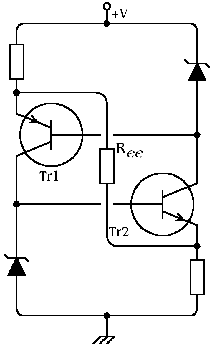

Scott,
A quick question .. would the stability of the 1mA CCS of the diff pair affects the output ?

Pretty second order, mainly the Zener's have some finite series R. You could sub an adjustable shunt regulator IC that allows a big filter cap, but here the Zeners are passive so the cap can be as big as you want.
Scott's circuit is pretty good for what it does. My personal 'headache' is a truly floating current source that is both low noise and low tempco.

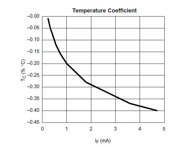

http://datasheets.maximintegrated.com/en/ds/MAX6126.pdf
P.15 Fig.2.
Take the 2.5V version.
Noise at 0.1~10Hz is 1.45µV p-p, and 45nV/sqrtHz at 1kHz.
To get 8mA, one would need to use a current setting resistor of 313R.
On top of that you also need to add the noise of the pass device ......
Patrick

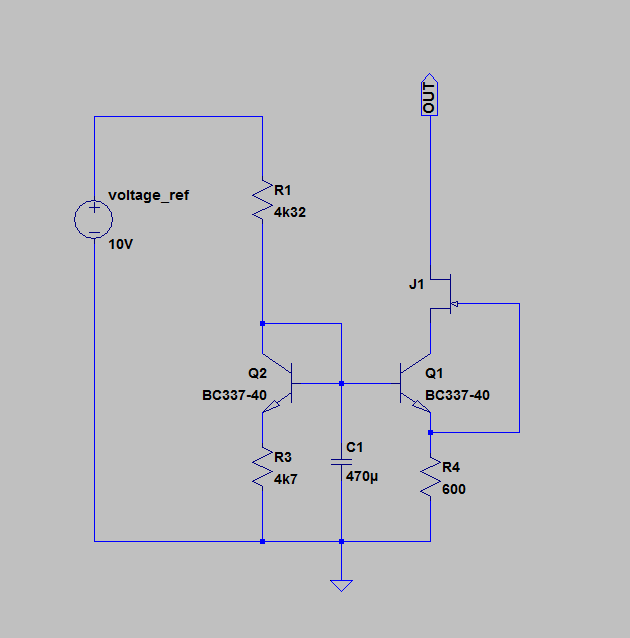

I can do some simulations / measurements...Dimitri, what is the effective noise contribution from that circuit?
I normally use something like this, use a voltage reference chip of 10v with low Temperature Drift, better to use a dual transistor for Q1, Q2.
C1 will filter the noise from the voltage reference chip and will shunt the base of Q1 to ground, j1 is optional and serves to increase the output impedance (I never use J1).
Even with a tl431 the noise is very low. but of course a low noise chip is prefered.

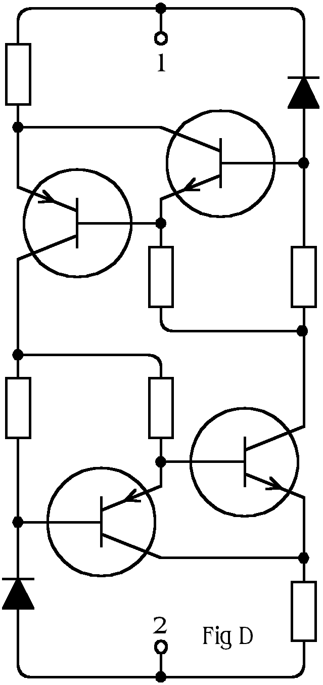

Here a link to the Baxandall & Rudge discussion :
http://www.keith-snook.info/wireles...ld-1966/WW 1966 Dec Letters to the Editor.pdf
