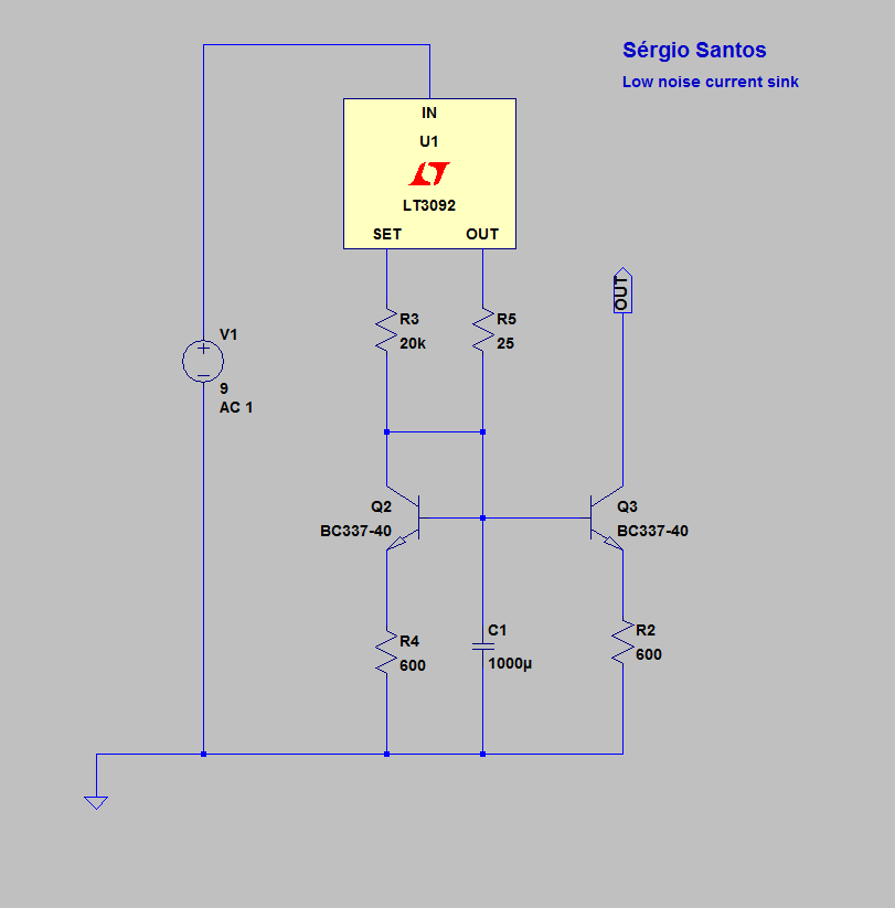

🙂 that depends, in my application I need a low noise current sink with the lowest possible temperature variations to get rid of using a d.c. Servo. So it seems a good tradeoff, in my particular case of course.
I think this circuit is relativly simply, for the benefits. only one IC ,1 dual bjt, 4 resistors and a capacitor.
But mr. Curl is right for some applications a simple jfet will be enought
PS: with this values , Iout=8ma.

The two terminal floating current source is on the LT6656 datasheet in the apps section. It uses a R-R in and out op-amp plus the LT6656, cute circuit.
Scott there is a potential problem with your circuit, the lt6656 need at least 1uf at the output terminal for stability.
Using the lt3092 in this case is preferable as this is a true floating current source with very good specifications and relatively inexpensive.
look at the datasheet of lt3092 and see how they create the floating current source , is also ingenious and interesting.
Yes I mis-spoke the reference should just be on top of the diode connected transistor. Also these circuits can have considerable beta errors which can be fixed first order if the betas sort of match. Sorry Dimitri you drew exactly what I said, I just had the wrong picture in my head.
Regulators with <1uA standing current are available, that is far better than one could ever count on matching base currents at 8mA collector current. This circuit wraps up nicely also as floating current source, with care a 2.5V reference could be used and the compliance could be 5V or so with no real penalties. Current is then 4X rather than 3X.
Scott question on that large cap from B to Gnd, wouldn't that cause a delay in the temp tracking between the input Vbe and the output trio? Even assuming all is isothermal?

🙂 low accurate current sources can also be very noisy. And unfortunately there is a lot of bad examples.
Jan
Most attempts to heavily filter the noise can be problematic, I'n not sure how thermal tracking at frequencies over 10Hz is much of a problem. If you want high output impedance in a floating source at audio frequencies the FET probably wins over ones using lots of feedback.
