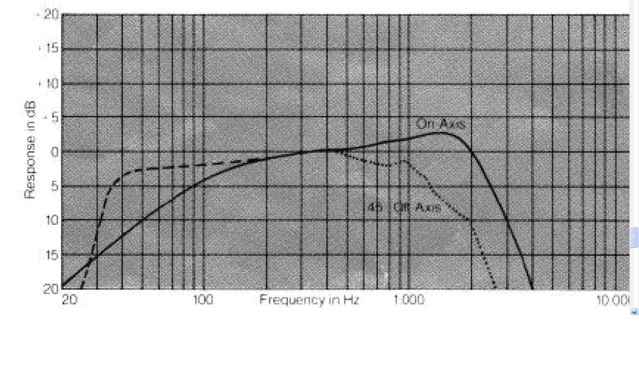

Attached is a frequency response curve of a woofer. Over what frequency range is it useful? Over what frequency range is it most efficient.
