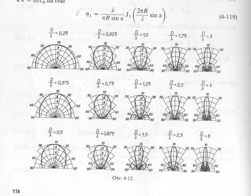

Yes, always directivity, but the reason I ask is because I'm pretty sure the dispersion patterns will be different with different shaped "perfect pistons" and I would be interested to understand this more.
for example, for me there is something about the sound of a whizzer cone that is truly appalling and I'm pretty sure it's connected with the steep sided cones they use for these. Other distortions may be there also but I'm talking of that focusing effect of the whizzer cones.

Different shape cones/domes show very little difference in dispersion pattern; key is circumpherence (or diameter).
The problems with whizzer cones are too numerous to mention and not worth the mental exercise of sorting them out.
