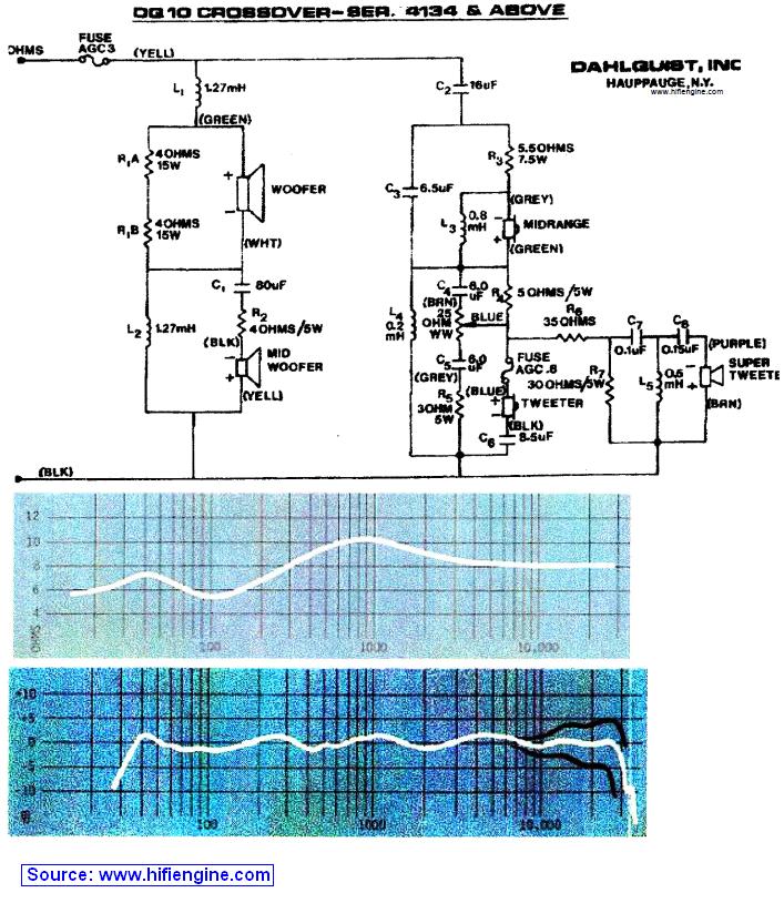

Drive your DQ10s with a bit more powerful amplifier or at least beef-up the psu of your t-amp.
If you only look at the x-over schematic ( and touch the resistors while speaker operates), you'll realize the need for some current delivery from the amp.

The DQ-10's are gone, it's a long story but they got put out in the yard without my knowledge and left there in the winter weather for several months.
Sorry to hear that (and my apologies for my misunderstanding).
Nevertheless, here is the x-over circuit and the published impedance curve.
Note the paired series topology and the low value resistors utilized for smoothing the impedance peaks.

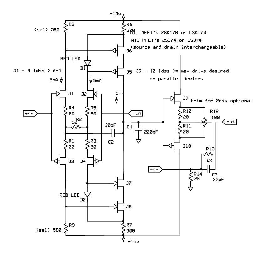

While listening last night I fiddled around with my circuit. The lower gm version makes more sense for low closed-loop gain applications. Here is a quick version that goes down to 6dB. This might not be perfectly optimum but one suggestion for starters. Pretty good full step response (130v/us) and THD at 20V and 20K still in ppm's (2K load). At normal signal levels should be low ppm distortions. Remember this was an exercise in taking JC's classic and using it in a conventional op-amp context (126dB Aol, 30Hz OLBW, etc.).
