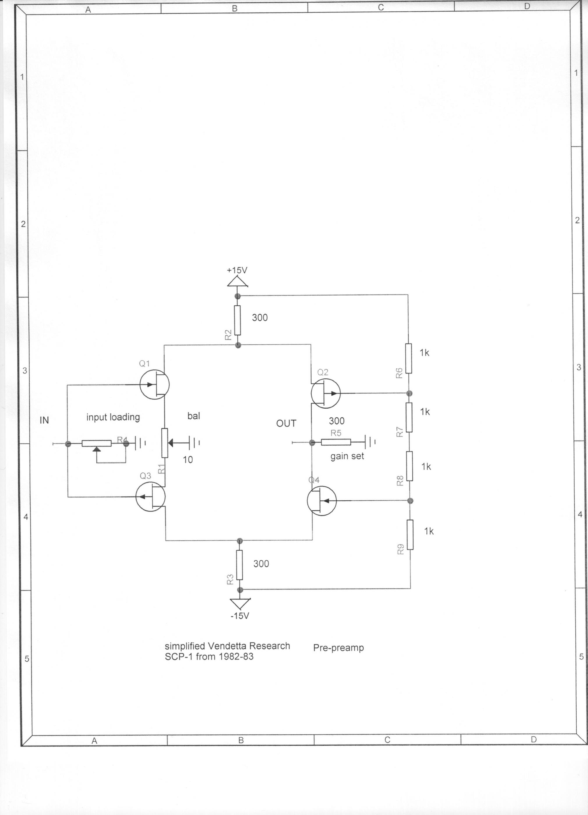

OK, here is the Vendetta input stage schematic, again for reference.
Now, where is the discussion? Advanced enough for you Scott? Understandable at all, most of you? '-) Yes it works, and has worked for the last 30 years. NOW do you understand WHY I did not publish the schematic, until recently?
Now, in all fairness to most of you here, who are usually repair techs and technical support engineers, the ambiguity of the active symbols might throw you off.
However it is called a COMPLEMENTARY FOLDED CASCODE input stage. And this describes what is shown on the schematic. It is about 100 times lower distortion and with perhaps 40 dB more dynamic range than the original JC-1, with the same input noise. It was originally designed to OBSOLETE the JC-1 type circuits that were still being manufactured. We did NOT call the company VENDETTA RESEARCH for nothing! '-)

John,
I have also used complementary folded cascode JFET stages, but with an integrated (in parallel to the input JFETs) DC servo also using JFETs so I avoided the IC you used for the DC servo.
The reverse engineering done in this link have a lot of errors (but as the drain and source are interchangeable it is maybe not so bad anyway), but if one take into account the DC voltages it is easy to flip some of the JFETs correctly.
http://www.amplimos.it/images/Vendetta.jpg
I discovered this schematic a couple of days ago when you started putting out the pdf files and it was thus I quickly observed it when your pdf´s had the same kind of errors as the reverse engineered schematic..
Ray, I see where the 'reverse engineered' schematic was drawn with reversed D-S in many instances. I don't normally put D-S markings on the schematic. However, it should be understood that MOST jfets can work about as well with reversed D-S leads, because the jfets are mostly symmetrical in construction. My mistakes were from poor eyesight these days, and the wish to put the schematic up.
