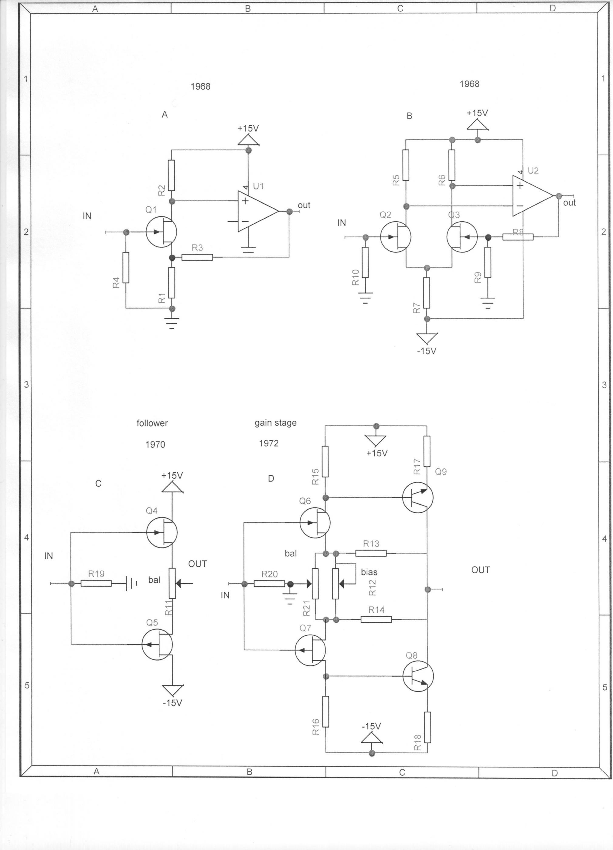

Well, this is the 40th year since I developed the complementary differential jfet line amps for the Grateful Dead. Yesterday I got a book: 'Grateful dead Gear' 1965-1995 by Blair Jackson, a GD roadie. I knew Jackson when I worked with the GD, and he always treated me OK. Anyway, the complementary differential input stage based line amp was described in this book, along with the rest of the gear for the 'Wall of Sound', originally developed in 1973. I am thinking of showing a few jfet input stage topologies that have been extra successful.

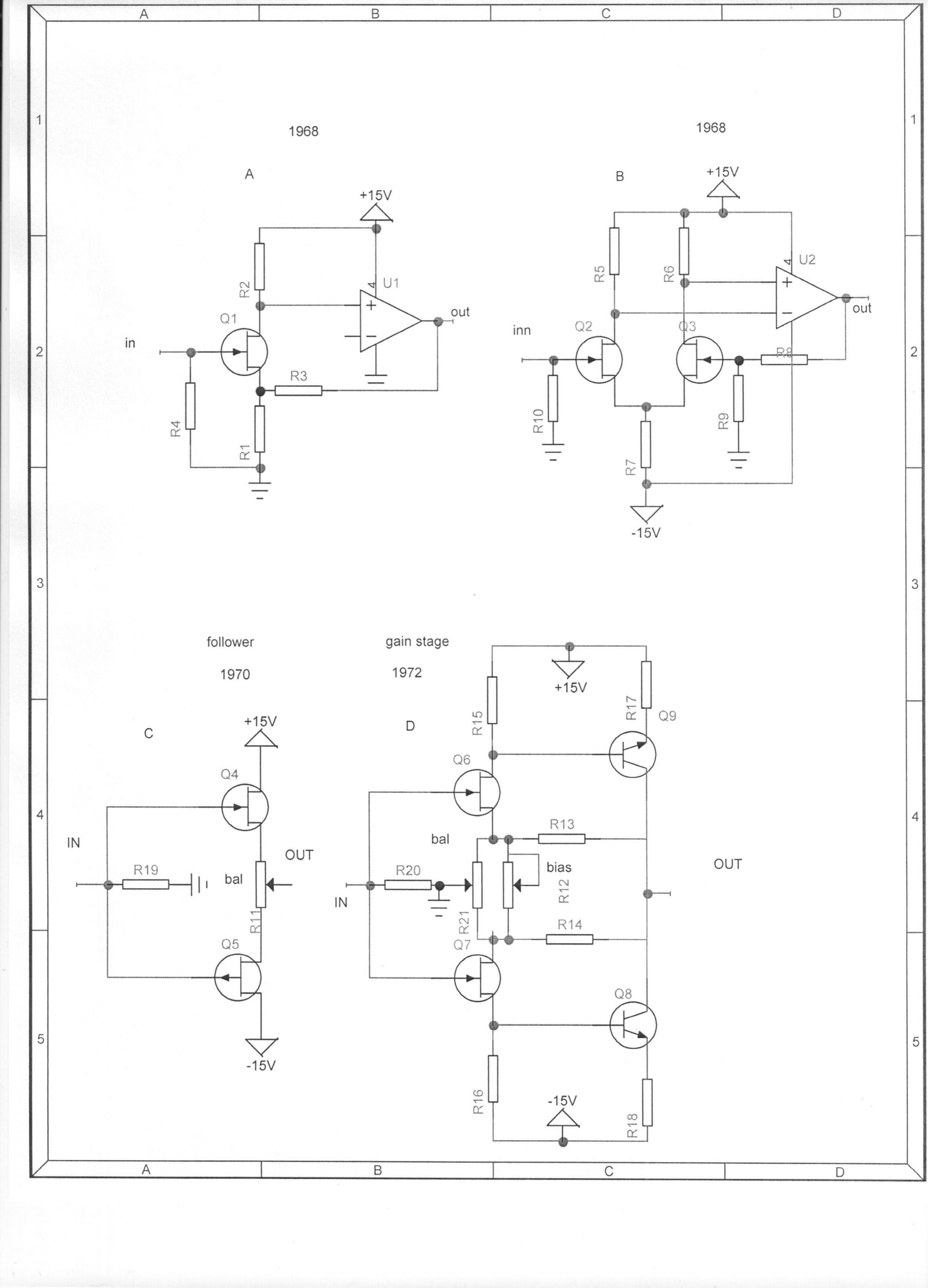

The truth is: I developed a number of topological solutions in the 1970's that are often 'rediscovered' today. Now, I will show some of these topological solutions for others to learn from.
A few examples: (simplified without proper biasing in some cases)
More advanced examples, later.
Thanks Ray and Max. I did miss the typo.
The triangle symbol is what the computer defines as 'op amp' in the drawing program, but it can represent following gain stages as well.
Before the uA741, and LM301, we also had the uA702 and the uA709, both designed by Bob Widler, first with Fairchild, later with National.
OK, a fast critique of the different types of jfet input stages:
A is the traditional approach in the 1960's for audio. It is potentially fairly quiet, but it has no significant power supply rejection, is usually used with single supplies, and is somewhat 'awkward' to bias. Cap coupling is usually mandatory.
B is the easier to build choice, BUT it is usually 3 dB noisier than A. It has the advantage of direct coupling and better power supply rejection.
C is really just a complementary follower, but it is interesting how it is similar to D which came later.
D is where new ground is being made. The self biasing nature of the jfets is used here to make a simple, yet elegant input stage, with balanced drive to the second stage.
It's drawbacks can be difficulty in keeping it temp stable and initial set up. This is still a very high quality input stage, if chosen. The complementary fets are in 'noise parallel' so they potentially REDUCE input noise, contrary to the simple differential pair that INCREASES input noise.
