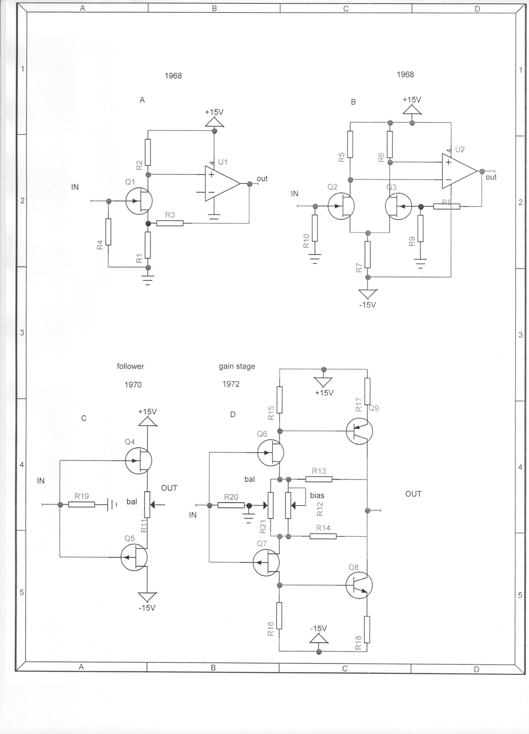

Yet another correction:
Bob Pease was doing them in 1963, and Dick Burwen at least by 1966. Interestingly the little triangle symbol is pretty old in the analog computing world.

The triangle symbol is what the computer defines as 'op amp' in the drawing program, but it can represent following gain stages as well.

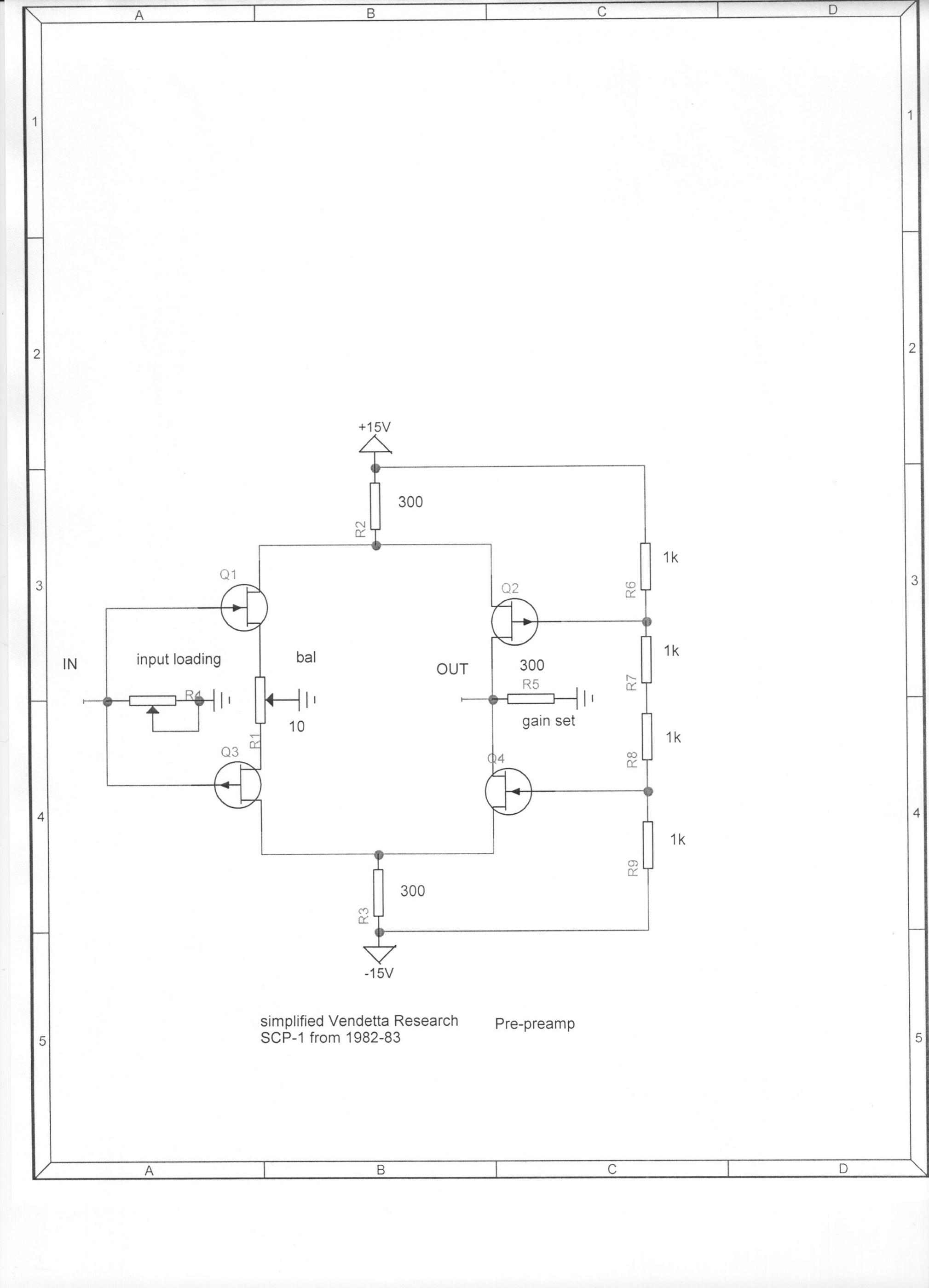

I would start with the cart makers who design both cart and their own (optimized) mc pre-pre for that cartridge.... Such as, the one Erno mentioned in his article.
In my case, it sounded better. I had a transcription Thorens and 12 inch SME arm and I also had a highly tweaked Rabco on a Mapelnol TT with vacuum suction. And I also had a Grace uni-pivot arm (silicon damping - if used in various amounts to damp it in various amounts... mounted on same Thorens TD124. ETC. A Denon 103 cart in the Grace on the Thoren sounded much better with the common-base MC pre-pre. This was compared with my JC-1 pre-pre and Denon MC step-up transformer.
I don't think I would have ever drawn a firm conclusion from a particular arm/cart alone to compare pre-pre.
If you start with Borbely's reference to cart maker and that cart makers patented preamp for it and other patents related to it etc... you can decide 'on paper' what you think it will sound like or not. Or just make it and measure and listen to various combos. But, I would start with an under-damped cart, first.

A quick check of an old mc I have here (Monster Alpha 1) indicates 5 Ohms and 5 uH internal impedance. A quick check indicates that a 5 Ohm load loses 6 dB of output (of course) and produces a additional .5 dB rolloff at 100 KHz. Not especially significant. and a higher load impedance would have a smaller effect (and more output + better SNR).

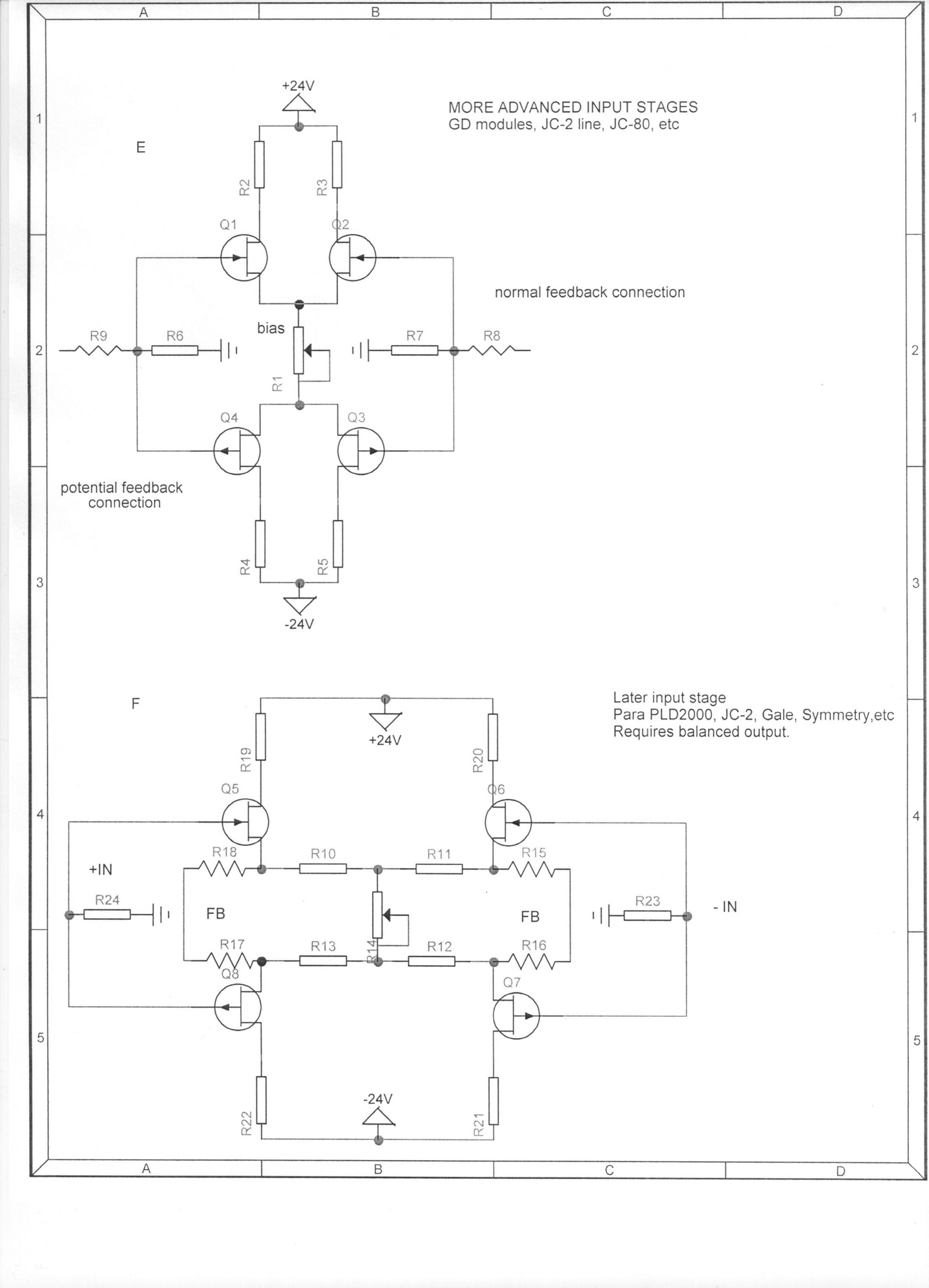

Yes, the COMPLEMENTARY TRANSISTOR was fairly new in the late 1960's. However, we had complementary Germanium transistors first, like the 2N1305, and 1306. And small signal silicon complementary transistors, like the 2N2219 and the 2N2905, and finally, the 2N3716 and 2N3792 power T0-3's, that came out in 1966-7. The silicon complements were adequate to make the complementary differential input stage, and a completely complementary design by 1968.
I think that 'improvements' in solid state technology have been highly exaggerated since the late 1960's, at least with American parts.
Just look at the bipolar transistor part numbers that are still in use today, and you will find that many of them come from about 1970, or earlier.
