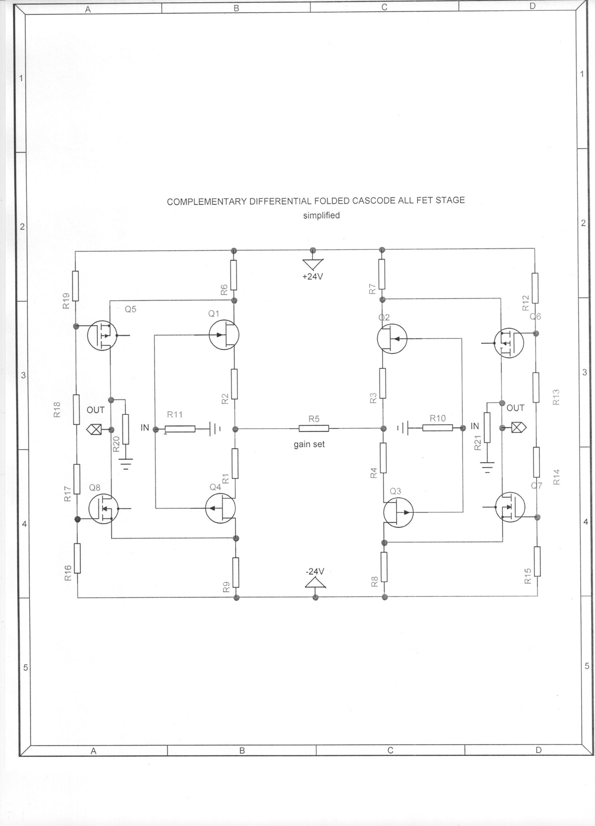

OK, this is the final schematic of this series.
It is what we often make preamps with, today, including designs like the Blowtorch, Constellation phono input, and even the new Vendetta. You will find similar circuits in both Charles Hansen's Ayre, and Nelson Pass's AWARD WINNING DESIGNS.
We go to these lengths, BECAUSE WE CAN. And we like to win listening contests. '-)
Woops! Forgot the schematic!
The Toshibas have become the solid state version of Telefunkens I suppose. They are nice parts but not magic. The circuits are the interesting part.
JC has a life time stash of his favorite fets so not much need to change to something else. But I wonder how the new Linear Systems fets will do in many places.... they seem like a great new part... low capacitance as well.

I have in several places here. I did it in my basement so it must be over three years ago and posted it here. They were pictures of taking any two, unmatched FET pairs as an op-amp input and trimming both offset to 0 and OLG to infinite at the same time. You could just as well trim offset and TC to 0 with a little more work. Your hand matched FET's are only matched in 1 dimension. I demonstrated at BA that FET's with as much as 100mV offset, after trim, do not have extra 2nd harmonic distortion. The trims are relatively cheap and virtually all commercial modules used them even after starting with matched pairs.
If you want Linear Systems to succeed in selling FET's it does not help to have threads where a bag of 50 NOS Toshiba's only yield 2 sets of matched quads and applying the same logic.
