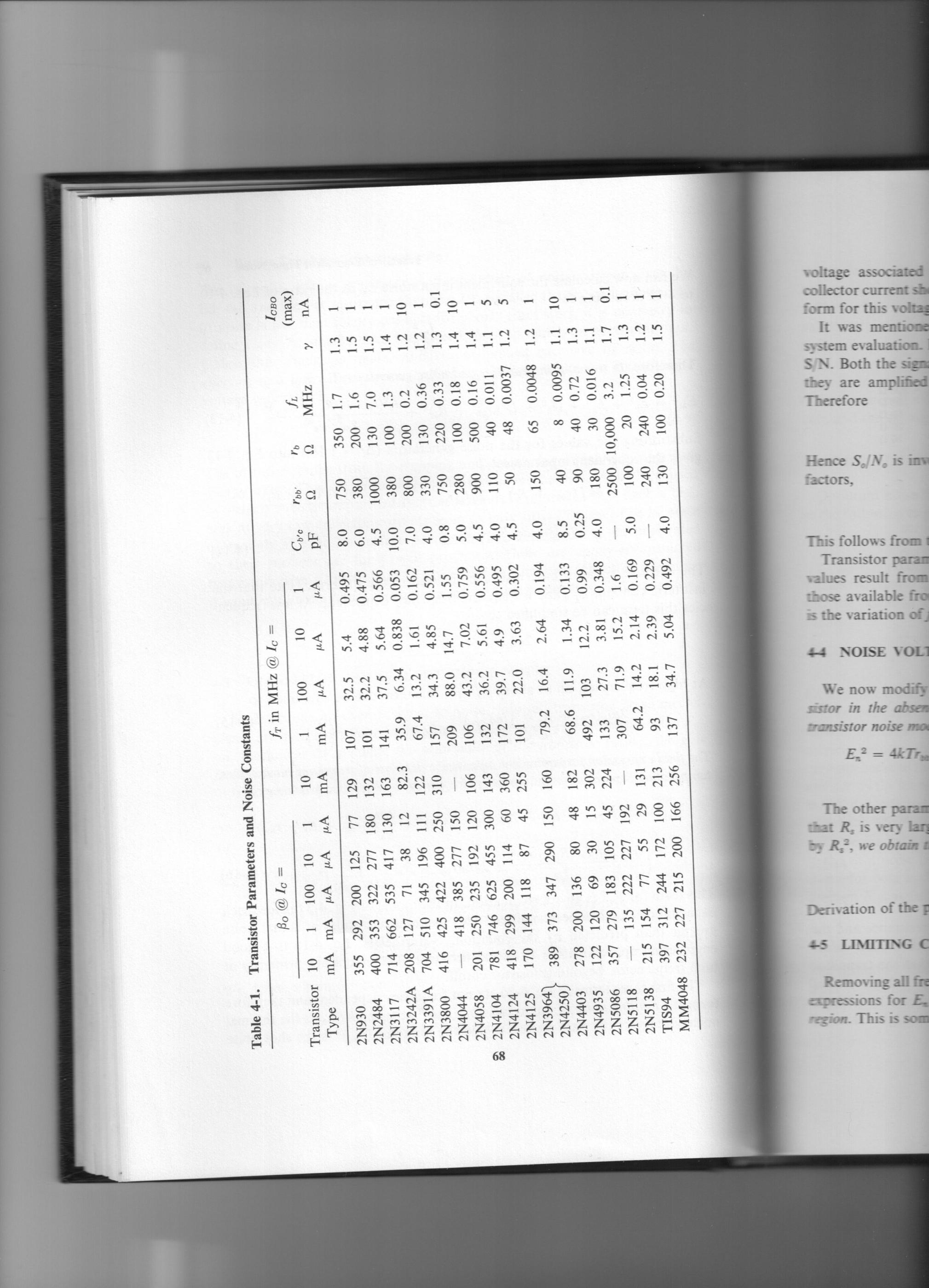

Sorry, I have been offline for a day, but please look at this chart that came from p.68 of 'Low Noise Electronic Design' , Motchenbacher and Fitchen' 1973.
Unfortunately, while this chart shows a number of 'low noise' devices, it is almost random in its composition.
The BEST comparison is comparing the Rbb' of the 2N4124, NPN; and the 2N4125 PNP. IF you check the spec sheets you will find that these are 'complementary devices, especially using the 2N4126, that is the hi beta select of its part series.
Also note the Rbb' of the 2N4403, PNP transistor that I found in 1978. Note that it is the lowest on the chart.
Personally, I found out from my boss at Ampex instrumentation in 1967, that PNP's were intrinsically quieter than an equivalent NPN, because the PNP has N material in the BASE REGION. Hundreds of tests with the QuanTech have shown this to be true.
Even the Rohm low noise devices have a different Rbb', where the NPN should be 4 ohms and the PNP is 2 ohms as I recall. Anybody have the Rohm data sheets handy?
For the record, I found devices just as quiet as the Rohm from Fairchild in the USA, but I don't know if they are still made.

John the Fairchild version of a Sanyo part is still around the KSA992 but the data sheet isn't much help without some guessing and calculation. Noise is listed as 25 mV 10 hZ - 1K @ 80 dB in some circuit. I would just measure one though as a professor years ago said to me, why calculate when you can measure. He was also yelling with a large hammer in his hand at the time.
Joined 2002
I just suggested the KSA992 on its own not as a replacement for something else. I will have to measure them and see how they look compared to the Rohms and the others you suggested. I don't have a Quantech but I did a circuit board for a modified version of one of Mr Wurcers old noise amplifiers and it works nicely to compare things.
