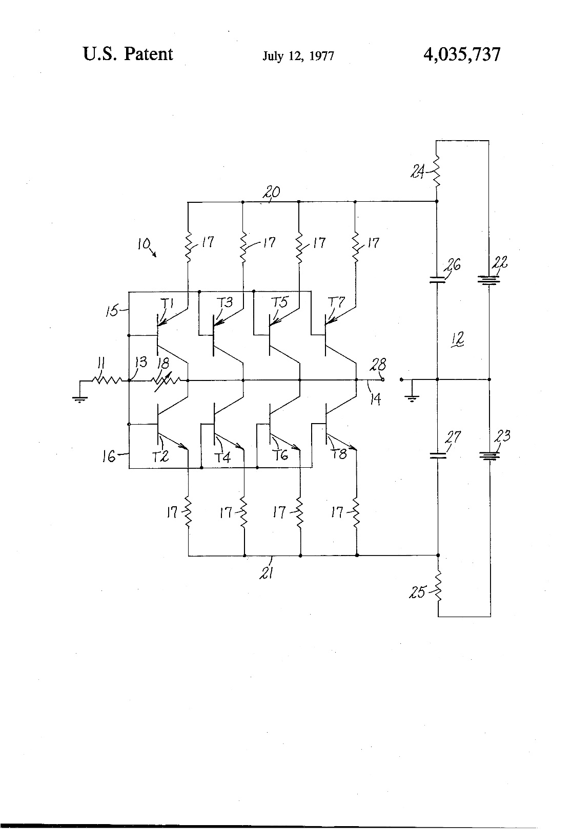

Now, if I can, I would like to give an alternative approach to the low noise problem.
This is not necessarily a universal solution, and I personally haven't used it for the last 30 years, BUT this does give low noise without an input transformer.
The advantages of this design is that it can run on a couple of D cells, and this lowers the price and gives a relatively quiet power supply. It is direct coupled both input and output, BUT it does not amplify DC. Even 45 years ago, (if I had thought it up at the time) it could achieve the equivalent noise of a 10 ohm resistor, and this became the Levinson JC-1, in 1973. (schematic as soon as I find it)
schematic

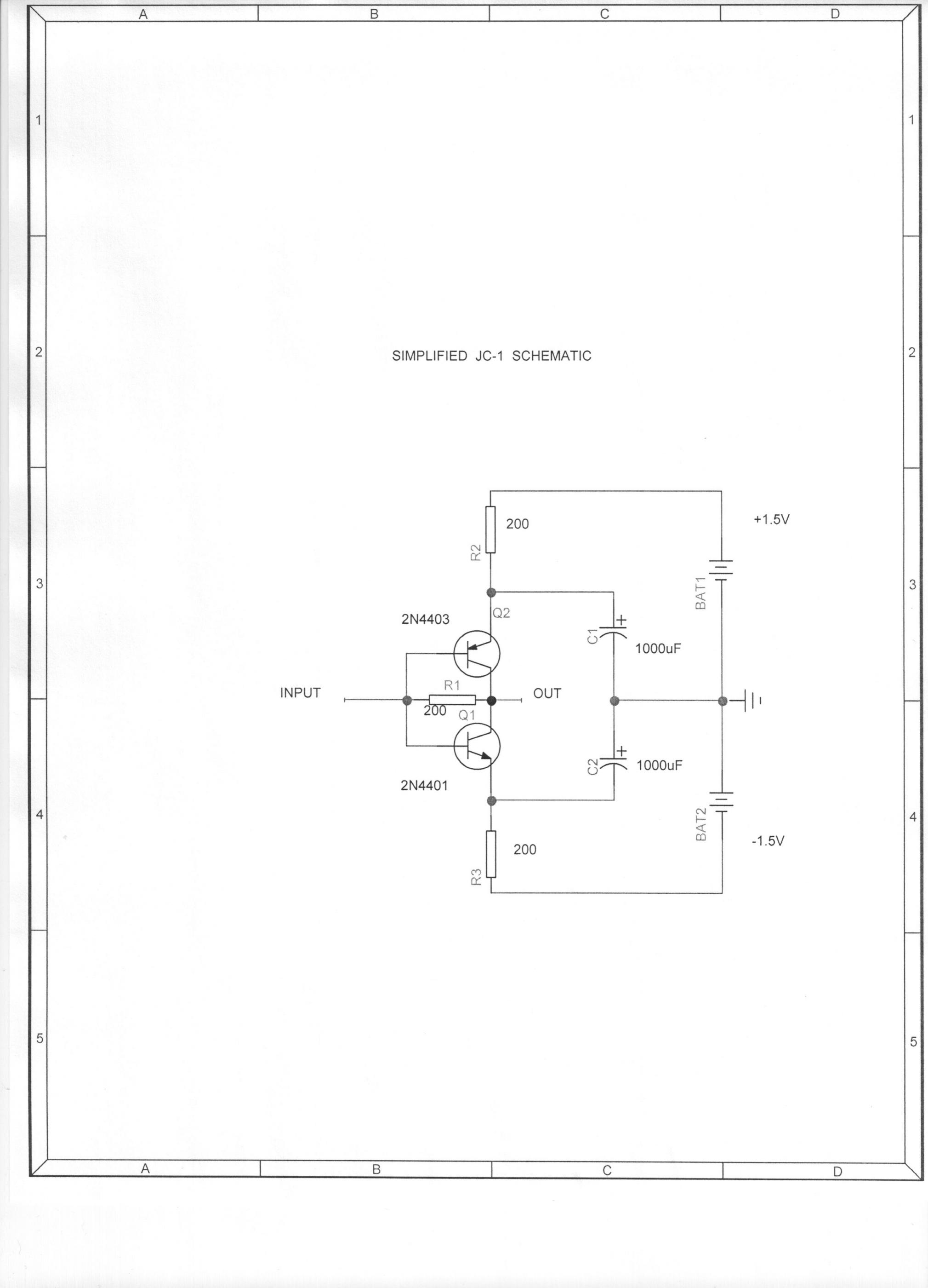

Here is a simplified schematic of the same topology. With IMPROVED transistors,(different part numbers), this was all that was necessary, 33 years ago. However, for the 2N4401-3 combination, multiple pairs were necessary.
I don't see different part numbers, do you mean the Rhom complimentary pair?
BTW, someone showed me a fully complimentary npn/pnp amp from 1967 (high speed not audio).
so what "isn't equal" in op amps? - the low noise bjt inputs I see in simplified schematics are NPN
This is a really funny issue sort of like righty/lefty. Single supply op-amps frequently are pnp input so they go to ground, but without this constraint folks go right to npn's and you know I never did an rbb study for the 797. The beta/VA is inferior on the pnp's and that also goes with the dopants, this is true until you get to some of the exotic processes they have now. This might be the real issue.
