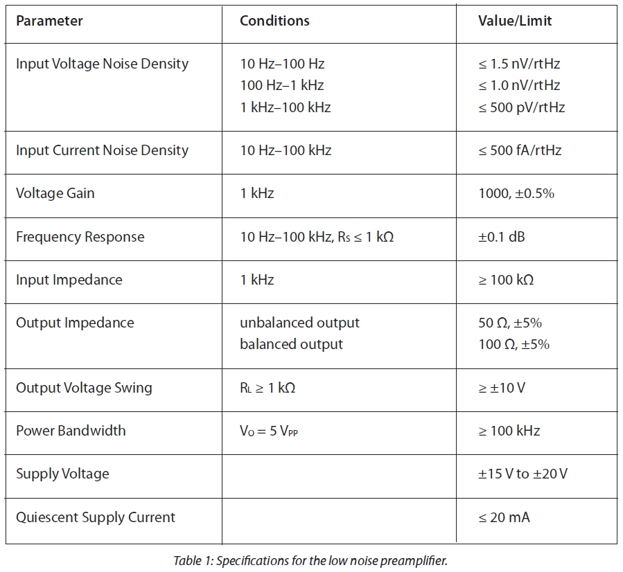

Not that it matters much anymore but a gain of 1000 composite amp and your average sound card can do this.

Scott, do you have the circuit you used for your noise measurements with a sound card? Might make an interesting group PCB design/ buy/ build.
There was a super nice unit like that published in Linear Audio- I don't have them at hand right now, but I think it was by Samuel Groner.
Thanks Jan.
I'll order that edition later tonight. Anyone going to volunteer to arrange a GB?
