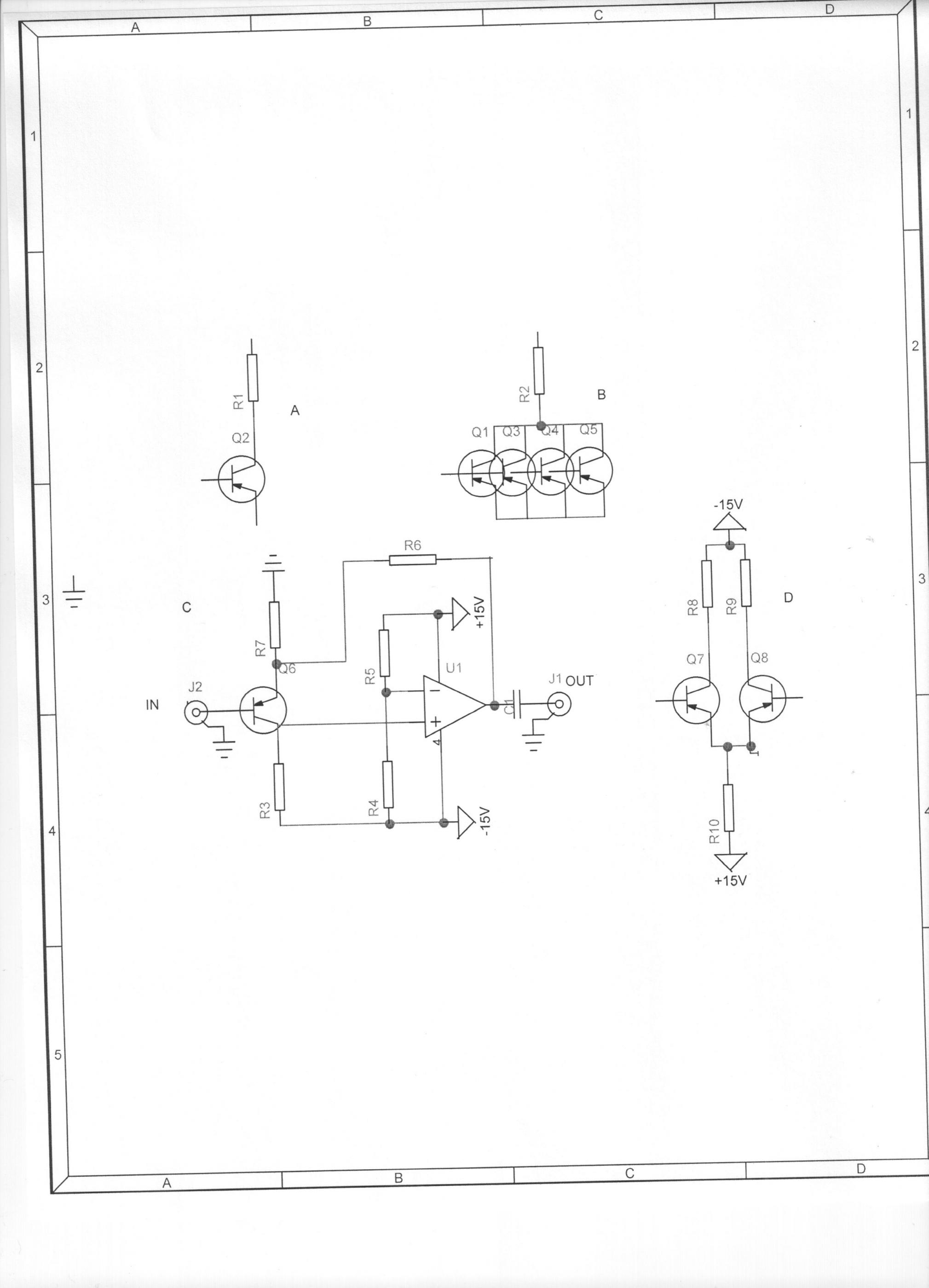

I would like to further comment on what is necessary to make an 'exceptional' audio design. As I said before, knowing your 'building blocks' can be very useful, even giving someone an engineering 'edge', over the competition, until they can find out what you know and do the same. And 'Thus it is always so!' '-)
However, I achieved 0.4nV/rt Hz capability in 1968, but the JC-1 did not come out until 5 years later. Much of the difference between early discovery, and proper implementation came before finding an OPTIMUM TOPOLOGY to utilize. This took me several more years to develop.
Now what is the problem? Well, it is a matter of distortion, cost, and low noise, and these requirements can be contradictory at first application.
For example: One could just use a single transistor, or even better, parallel a bunch of them, and then use an op amp for rest of the gain. This could have been done with four paralleled 2n4405 devices and a uA709, back in 1968 and we would have had ultra low noise and low distortion too! Yet, what are the 'drawbacks'? Cost might be one, because a low noise +/- 15V power supply could be expensive, and any IC op amp was not 'dirt cheap' in those days. Another design decision was whether to cap couple or not. The input bias current could be somewhat high, was it too much for a MC cartridge to bear?
If so, what relatively high value of input C would be necessary to not add excessive 1/f noise to the equation?
What about the optimum input impedance range? I would think 100 ohms or less would be best in this design. That sort of leaves out a making general purpose test amp this way. In other words, to get the BEST low noise performance, you have to direct couple the input, if possible, and keep the useful impedance range limited to perhaps 100 ohms, to get the lowest noise with this method.
Now, should the discrete transistor array be cap coupled to the IC? Here, there is a trade-off between size, voltage rating, and value of the cap. Cap quality might be important too. Of course, even in 1968, we could DIRECT COUPLE the discrete input stage to the op amp, BUT we would have to offset voltage in both op amp input terminals. This could be done, even then. So then what? We make something that meets a noise and a general distortion spec. for a MC input, but is it worth doing? We have replaced a very cheap and compromised input transformer, with a solid state gain stage, but will it be really better, and worth it? Why not just use a better input transformer? (more later)

Negative on top John? Are these germanium designs? Silicon was in popular use in 1968. Even the Quan-Tech from then had a mix. In fact, in many places you can swap the germanium for silicon and it works fine.
PNP transistors are always quieter than NPN transistors. This is because the BASE of the PNP is N material. The Rbb' of the PNP is usually about 1/2 the value compared to NPN transistors with similar construction.
Demian, please look up the part numbers that I spoke about. 2 types are the 2N4403 and the 2N4405.
