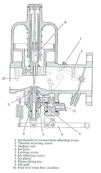

Jim Williams gave a talk on this at the ISSCC. An ancient mechanic gave him the secret sauce. You need to modify the viscosity of the damping fluid on the SU carbs according to "feel".

You wouldn't believe the amount of times I asked someone with one of those old British cars when they were running rough when they last checked the damping fluid in the carbs and they looked at me funny! Oil in the carburater, they though I was nuts. Much easier on a Holley carb, just make sure the power valve diaphragm wasn't broken and the fuel levels were set and they would run.
SU Carburetters Introduction
Most S.U. carburetters incorporate a piston damper, the function of which is to restrict the speed of lift of the piston on snap throttle openings, and to allow the piston to fall at its normal speed on throttle closure. This one way damping is obtained by means of a non-return valve situated at the base of the damper.
When the speed of piston lift is retarded an additional air depression is put on the fuel in the jet resulting in an increase in the quantity of fuel discharged. A richer mixture is thus obtained until the piston resumes its position of equilibrium. This enrichment is necessary to provide satisfactory pick-up. The piston damper also improves cold starting and driveability from cold.
After the carburetters have been correctly set it is necessary to check that the oil damper reservoir in the piston rod has sufficient oil. This operation should, in any case, be carried out periodically at about every three months, and it is usual to use an oil of grade SAE 20 (it should be no thicker than SAE 30). The operation is not a critical one; simply unscrew the damper unit and pour oil into the hollow piston rod until it is within t in. from the top of the rod.

George

Triple SU carbs....once setup correctly they never gave an ounce of trouble and remained stable very long term.
SU carbs suffer wear badly...the moving piston and metering needle incur wear that causes binding and non return to idle.
Yes, the dashpot oil is very important to driveability....IIRC I used Dexon II auto trans fluid.
