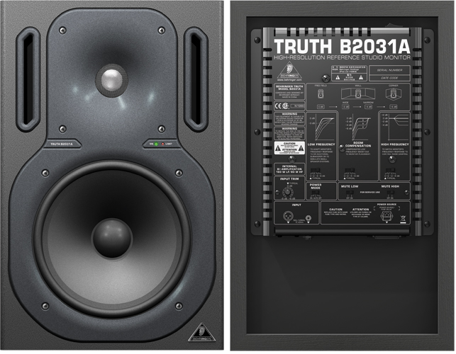

Max, do your active speakers have a switched power supply or a mains transformer? Just trying to figure it out. I can follow your logic, but have questions too.
Standard toroid transformer/rect/caps driving LM3886 amplifiers.
Line level/crossover stages hanging off LM7815/7915 regulators.

It probably IS possible to eliminate the effect of a small change in frequency, but WHY did the original design have this sensitivity? That is what we have to pursue.
Hi John, see my above post, including schematics.
These boxes run simplest PSU arrangements possible, so AC line dependency is to be expected IMO/IME.
