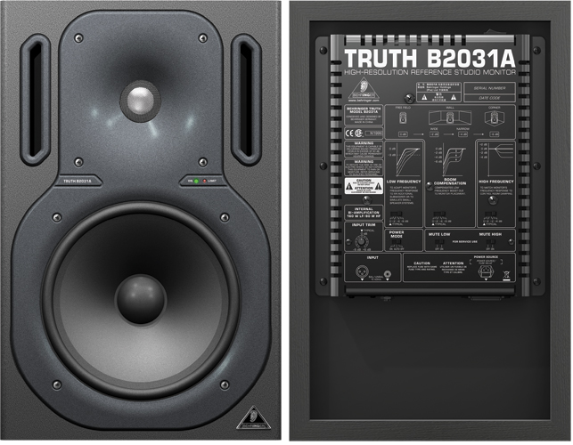

Agreed the Behringer (standard consumer PSU topology) PSU arrangement is hopelessly transparent to incoming AC borne noise, and the 3886 amps are not particularly immune to DC rail noise also.
So these active speakers reasonably duplicate the supply dependency of any normal (suboptimal) Pioneer, Sony, Yamaha etc amplifier or receiver....DIY stuff too.

Come to papa ...!!Standard toroid transformer/rect/caps driving LM3886 amplifiers.
Line level/crossover stages hanging off LM7815/7915 regulators.
Dan.
Very amusing - these are precisely the units I have here, one of my Round Tuit projects, to sort them out. Were the best of the bunch when I did an auditioning tour of small pro actives, but still have pretty severe failings in raw form - especially the usual, collapsing power supplies when asked for decent output levels.
So, IMO just about anything you do within a mile of these will make a difference ... will be interesting ...

Max, thanks for your courage in reporting what you have found, so far.
It does seem that your audio equipment is probably part of the reason that you can hear this difference, but it is typical of much that is thought here as being as 'good' as anything else in audio reproduction by many.
Looking at the schematics, I see 'design to a price' and this leaves little 'guard-band' to get it 'right'. Parasound makes a lot of products in a similar manner, but not MY designs. That is why my Parasound designs cost more than many other Parasound products. I, personally, don't get that much from my efforts that would raise the price significantly, BUT it is my insistence of a standard of design that often eliminates the very 'cheapest' parts and circuitry to just get the job done, makes these products to sometimes standout when a difficult load or power supply condition is encountered. Unfortunately this costs more money to make the product, and this is multiplied by the usual markups to a much higher end price.
I suspect that a number of other audio products will be sensitive to this line frequency change. I would doubt that more 'hi end, well engineered' products would show the same change with frequency, but it is interesting to note. Who knows, until we try?
Thanks John.
Yes, I fully agree that the Behringer's lack of engineering renders it prone to PS ripple causing IM at any signal level.
On first inspection the schematic looks to be quite ideal, and ought to work reasonably flawlessly......ditto just about any other piece of mid-fi gear, however, in common practice this is not quite the case.
The current state of subjective experimentation has opened my ears to how much damage is done by typical standard power supplies, and the importance of very low noise/ripple supplies and high PSRR circuitry.
