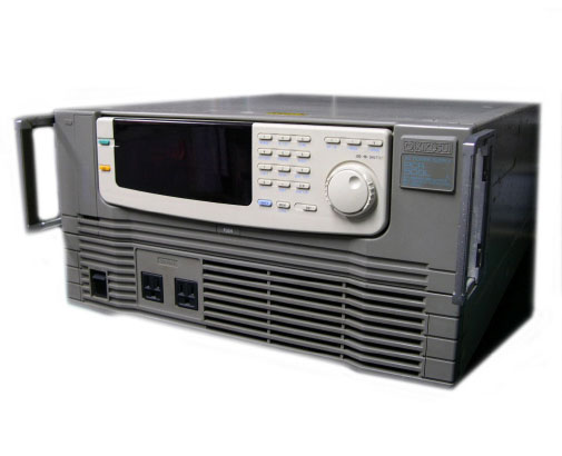

Recently I bought one of these via Ebay.
Kikusui PCR-500L AC/DC variable voltage, variable frequency power supply.
http://www.kikusui.co.jp/kiku_manuals/P/PCR_L_E7.PDF
It puts out 0-300V AC, 1Hz-999Hz, 500VA at 0.3% THD, or 0-420V DC, or AC with DC offset, or DC with AC ripple !.
An experiment I have wanted to try since forever is to run musically related power frequencies and hear what happens....now I can. 😛
Preliminary findings so far, confirming suspicion is that neither 50Hz or 60Hz are actually ideal on gear with less than perfect power supply/earthing arrangements.
Switching to 55Hz causes an immediately subjective cleansing of the sound, reducing a veil of intermods and harshness.
Bass gains solidarity and 'correctness', mids lose harshness, highs gain extension.
This is on active speakers fed by directly USB soundcard (Edirol UA-25ex).
Of course this is probably not revelatory news to advocates of high quality DC regulation stages and high PSRR stages (JC and others).
Currently I am running clean sinewave output...programming via GPIB interface, this box can output clipped sinewave, sine plus noise, DSO captured waveform or just about any arbitrary waveform, including varying/stepped output voltage, varying/stepped frequency and momentary brownouts/surges.(once I get a USB-GPIB interface cable 🙁)
All in all an interesting and very useful piece of gear for simulating/measuring power quality effects on audio gear.
Dan.
Well, that would be me, but if it's actually true, it would be revelatory news. How have you verified that this remarkable observation is correct?
I suspect that if all mains equipment ran at 55hz that the same test would indicate that 50 or 60hz sounded best.
Hi Dan,
Nice piece of kit, good to see you are putting your money where your ears are.
Much interested in further results. I hope you will be able to objectify your findings by doing some controlled listening tests.
One question I have is about your suspicion that 55 Hz would be better than 50 or 60. What is the reasoning behind this? I can imagine that a marginally designed transformer with a core that saturates @50Hz might benefit from more cycles per second. But why would 55 be better than 60 Hz?

Not Interested In Any ABX Arguments For Now....
Testing regime for now is sighted testing with one other person present...we both expressed the changes in the same ways.
No blind testing yet...that will follow when I get a GPIB interface.
Another observation is that US (60Hz supply) recordings sound slightly less bad with 60Hz supply than with 50Hz supply.
I find also that the converse is true...I have always found AUS/European recordings sound subtly more correct with my local 50Hz mains than do US recordings.
110Hz sounds good, 100Hz and 120Hz sounds less good also.
Just some preliminary informal findings so far, maybe a heads up for some.
Actually it confirms justification for very high performance regulator stages, power amp capacitance multiplier power supply stages and importance of correct earthing arrangements.
These factors are typically to be found wanting in 'average' audio gear.
Dan.
I'm saying that power frequency injected hum, ripple, etc is discernible on sub-optimal gear.....it's a modulation in addition to the audio modulation = intermodulation.Well, that would be me, but if it's actually true, it would be revelatory news. How have you verified that this remarkable observation is correct?
Dan.
Thanks, Dan, it will be interesting to see your results in the testing round. That's a very nice piece of gear that you scored!
