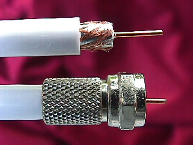

F connectors are really best suited to solid cored cable. Also the surface area of the connection is small. I wouldn't think they were a good choice for audio tbh.
No personal experience, but Horowitz & Hill pour deep scorn upon the type F connector as an example of bad design ...
And since the BNCs are good, available and quite standard, there is no need to seek something else but courage to use them.
F connectors often use the coax inner as the centre pin, so oxidation could be a problem.
Also, in my experience, F connectors can get confused between the screw thread for attaching to the socket and the screw thread which attaches to the coax outer. When you try to remove the plug you end up accidentally dismantling it too.
Stick to RCA or BNC.
there are a few positive things to say about the F-type--- the dielectric is low loss and low capacitance and often can be had with triple shielding all for very low cost. And, if you do not plan to be frequently unplugging/plugging, it makes a good ground connection and wont loosen or fall out. The center pin is gripped by a hard enough contact pressure to break thru oxidation and makes a good contact. At least it isnt worse than an RCA. It is reliable and can be had in air/water tight for outdoor use for years if not decades.

You can get RG59 with a silver plated center conductor. It is called head end cable. I also have cosmetically gold plated F barrels.
The advantage of F connectors over RCA is that besides being coax and constant impedance, it is a screw compression shield contact.
You can also get RG6 with a silver plated conductor. But the core usually is steel on those cables.

A good Type F connector and coax (good to 1 GHz) is far superior to any RCA-type that I've ever seen. BNC-type is probably 3X better than type F (and is good to 3 GHz). But neither of those is available in a metrology-grade version.
Of course, I'm talking about RF usage. But maybe what's good for RF is good for everything. (Bloody unlikely... but still far better than RCA.)
The very best commonly-available connector type would probably be 3.5 mm (NOT SMA-type), in metrology grade (good to 33 GHz). But those might be a couple hundred dollars per connector, if from a reputable manufacturer. (But don't EVER mate them with anything SMA, even though they appear to be compatible.) Or instrument-grade or production-grade could be used, for a much lower cost.
TNC type is OK. It looks like a BNC diameter, but with threads. They're good to 11 GHz but are not available in metrology grade or instrument grade; only production grade.
I really like the Type N metrology-grade connectors (good to 18 GHz); maybe with some nice LMR-600 cable.
But beware! Even the very best RF connectors are usually rated for only up to about 100 mating/un-mating cycles. After that, the high end of their frequency response starts to measurably degrade. (Little-known fact: Until relatively recently, SMA-type connectors were only available in "crap" grade, and were only rated for up to ONE mating/un-mating cycle!)
But I doubt that we're worried about what's happening up at 18 GHz, for audio connections!
Still, if you have an expensive piece of RF gear with built-in connectors, it would be a good idea to install M-F adapters (which don't change the original sex), so that you can replace them after every 100 mating/un-mating cycles. That way you can get 10,000 mating/un-mating cycles, instead of 100, before the built-in connectors would need to be replaced.

Of course I agree BNC is a better connector for repeated insertion/removal, but at the downside of more tedious fitting of connectors to cables.
For permanent/semi-permanent connection F connectors ought to be close to electrically ideal.
