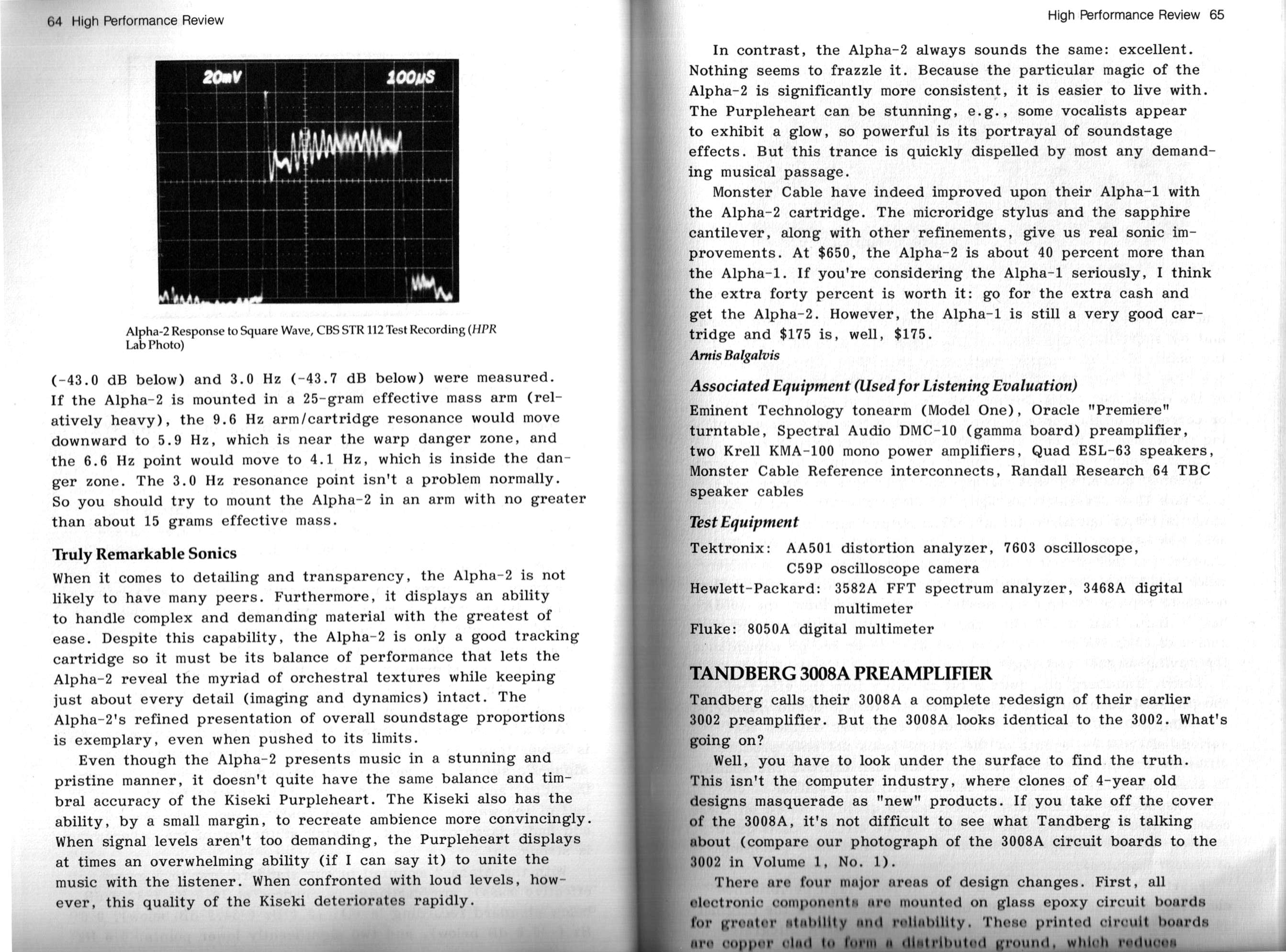

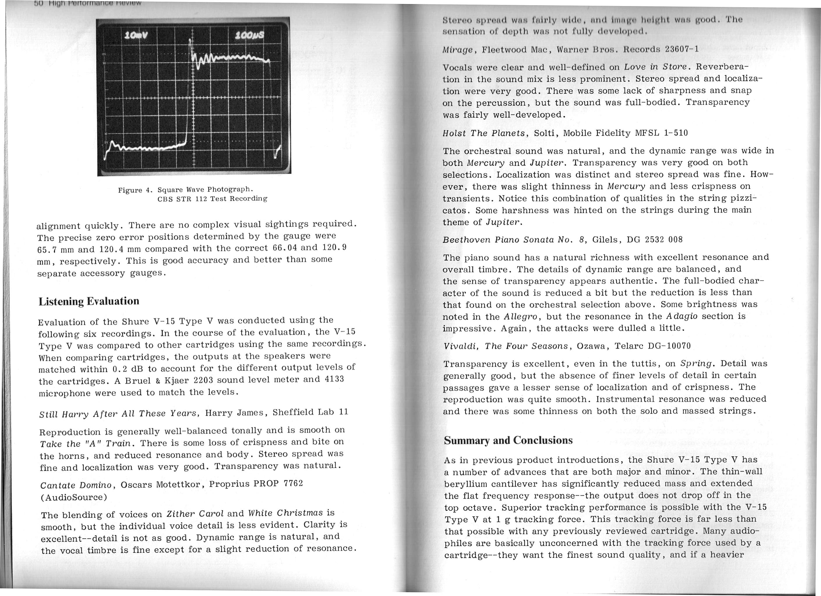

Let me show what the subjective difference between two cartridges available from the mid '80's. One is the Monster Alpha 2 (made by Namiki, Japan), this was the cartridge that I used for evaluation for a time, until 1991, when it was lost with all the other audio equipment.
The other is the famous V15, by an audio review magazine, called 'High Performance Review' that seems to know what it was doing.
Please note the SUBJECTIVE impressions between the two cartridges. Which would you use for serious evaluations?
The V15, properly set up. It will be much more truthful- which is a different matter than "preference." The horrific ringing of the Alpha 2 is pretty much impossible to correct, though one could play with the EQ to get rid of the upper midrange sag.
