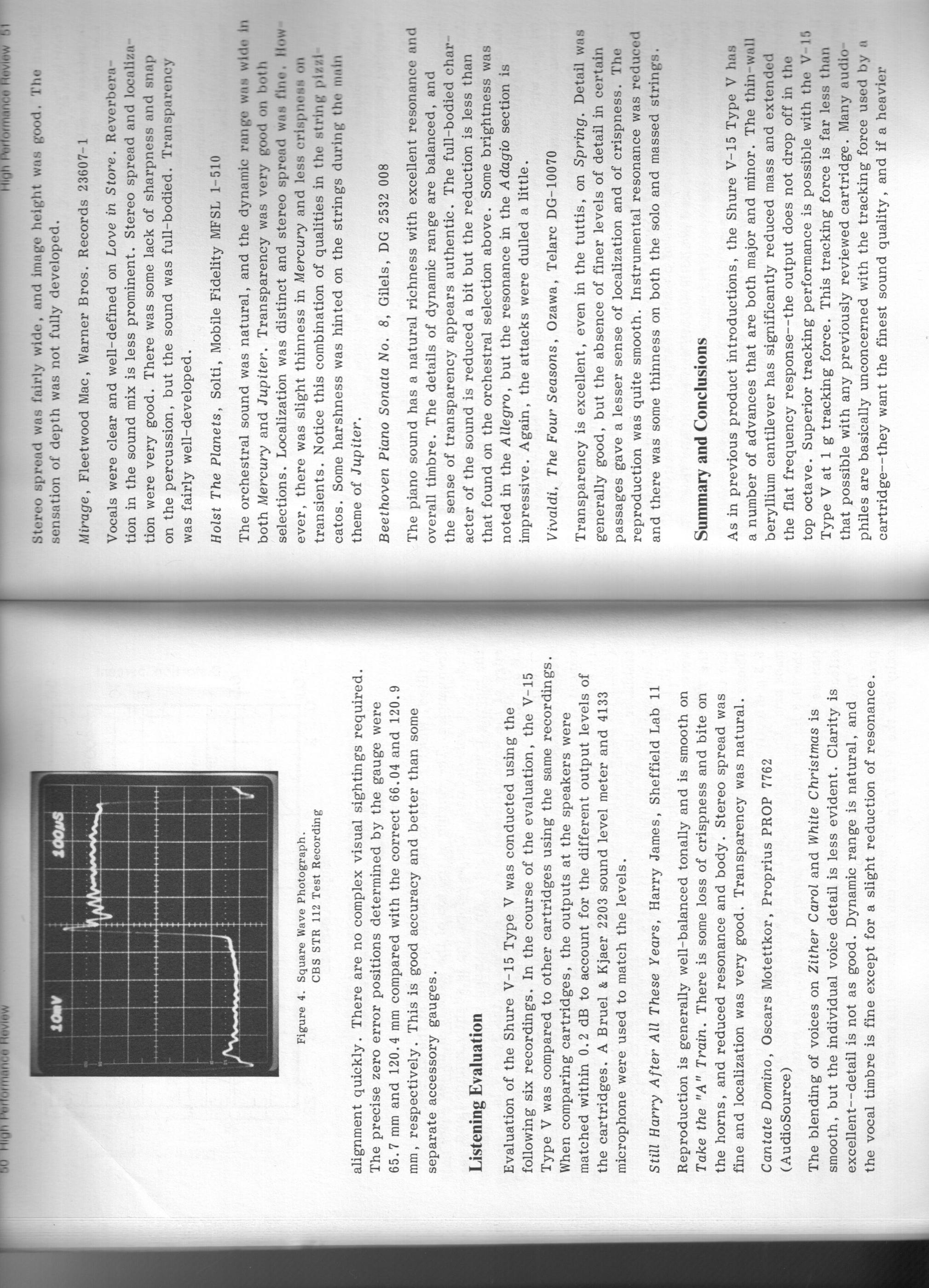

Yes, a V15 will sound very SMOOTH. Just what most of you want.
Jico is making a stylus for the Shures:
Jico S.A.S. Shure VN-5MR stylus,Jico S.A.S. Shure VN 5MR stylus,Jico S.A.S. Shure VN5MR stylus,Jico S.A.S. Shure VN-5MR needle stylus,Jico S.A.S. Shure VN 5MR needle stylus,Jico S.A.S. Shure VN5MR needle stylus,Jico S.A.S. Shure VN-5MR stylus needle,
I might have to get one for my old Ultra 500 body and see if my tastes have changed. (I've been using and recommending Denon DL-160's for many years, but they don't make 'em anymore.)

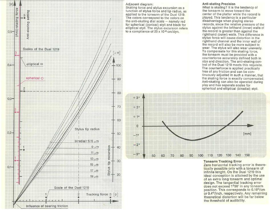

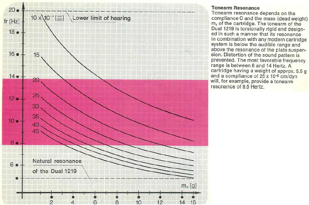

Just curious why you would spend time on a Dual 1219 turntable? I have one that has been sitting for a long time
It’s a real piece of engineering. When you will study it in detail, you will be amazed. It has many automatic functions but none of them interferes with the arm or the platter during record playing.
When restored with care, it easily meets it’s excellent specs.
A very good idler.
It has a lot of adjustments and set points but when you will decide to bring it back in life you will understand that it is classes above Dual’s later belt driven turntables.
It was equipped with Shure M91MG-D (spherical). It can take any cartridge with ½” bolt spacing.
PM me for documentation. Don’t proceed without it.
George
