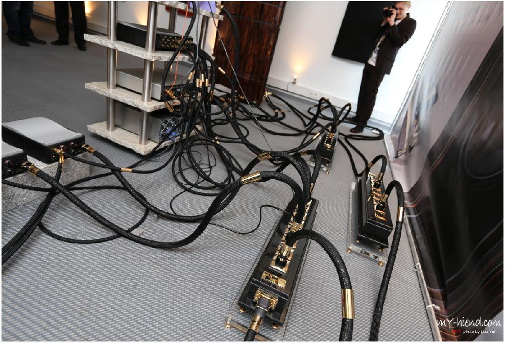

True, but I see a lot of fancy power conditioners in audio show demo rooms.
And outrageous obsession with main's power distribution.
George
