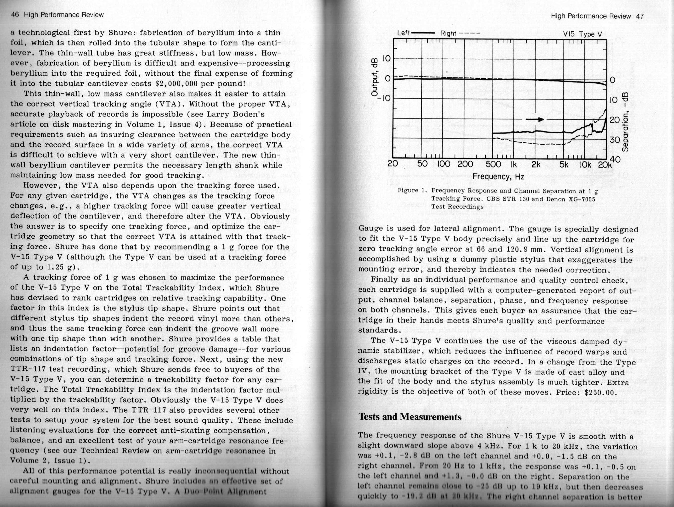

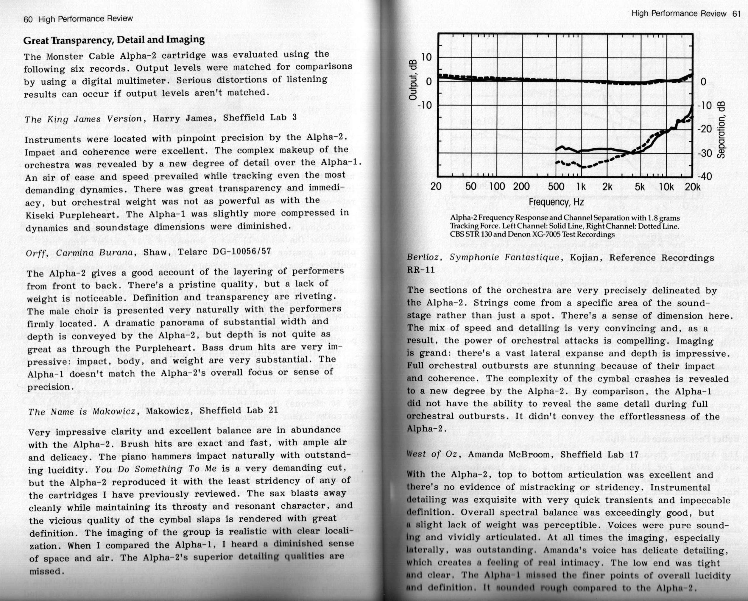

Here is the frequency response of both phono cartridges:

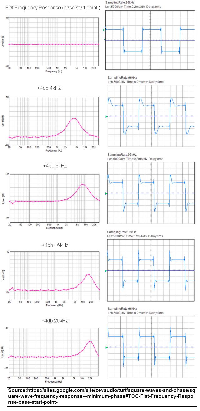

Thank you M. Curl.
Now I understand what you were doing.
I am afraid that they were many variables in the mix.
It seems that many things are predictable and explainable by theory (which I didn’t know).
Attached, some telling FR/SQW
Source: https://sites.google.com/site/zevaudio/turt/square-waves-and-phase/square-wave-frequency-response---minimum-phase#TOC-Flat-Frequency-Response-base-start-point-
If you will read this https://sites.google.com/site/zevaudio/turt/cartridge-comparison-list/shure-v15v
You will find a way to separate electrical from mechanical resonances, at least applicable for MM cartridges.
In some of the FR plots shown below, you will find cartridges with HF peaking continuing raising past 20kHz https://sites.google.com/site/zevaudio/turt/cartridge-comparison-list
George
