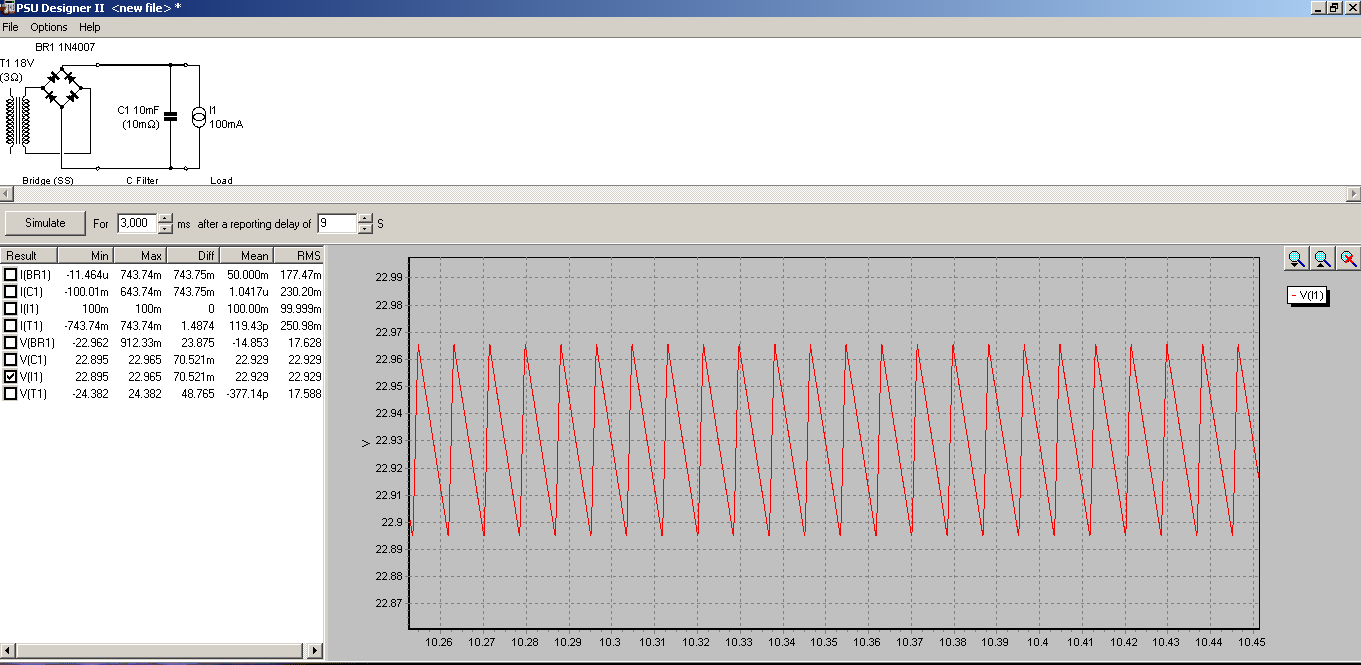

edit: Here's my "work" to show the actual ripple. Plugging in values for components I had on hand, I find that my 120mV estimate was indeed too high- it's ~70mV p-p. Makes the concern even more ridiculous. PSUD2 is a "known-good" sim- I'm not a big believer in sim software, but again and again, it's given me (and thousands of other users) accurate results.

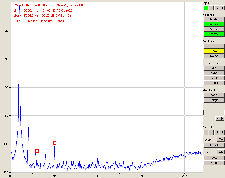

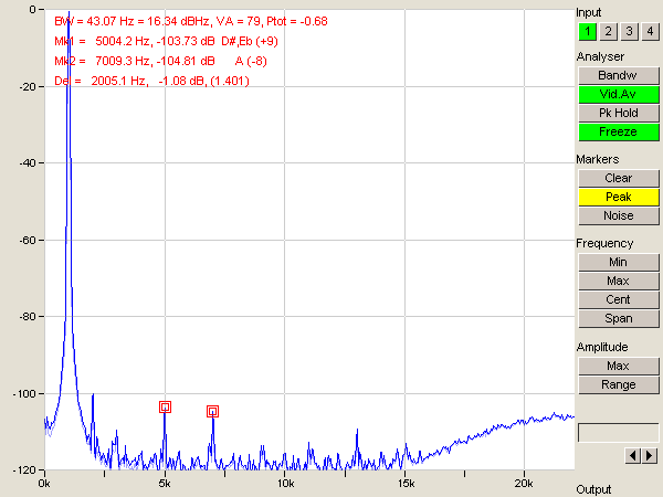

Some 7th in a "real world" circuit:
Some years ago I tried different opamps in the input stage
of a Sony A6 DAT recorder.
Except for the LM4562 (second picture) all opamps tried (AD8620 here as an
example) showed clearly visible 7th.

PSUD2 is indeed a fine SW tool.
PSUD2
I have verified (when modelling is performed with care to details) it’s accuracy to uV level on dynamic Vs and Is through measurements on actual circuits.

Except for the LM4562 (second picture) all opamps tried (AD8620 here as an example) showed clearly visible 7th.
So you listen with your eyes? 😉
Sorry, couldn't resist that one...
I am puzzled by your post though.
I agreed that it exists. I questioned the audibility at extremely low levels.
Now you come along to proof it exists.
So do you actually agree with me or what?

I do not want to enter a discussion about the audibility of the 7th harmonic, but just
wanted to show that in real circuits (as opposed to datasheets with measurements at
unity gain) it´s obviously there. If -105 dB (not "-10zilliondB") for high order harmonics is an "extremely low level" or already to high is debatable of course. A line stage I´ve built based on Johns
JC-2 (ML-1) circuit doesn´t show anything above the third as a matter of fact.
