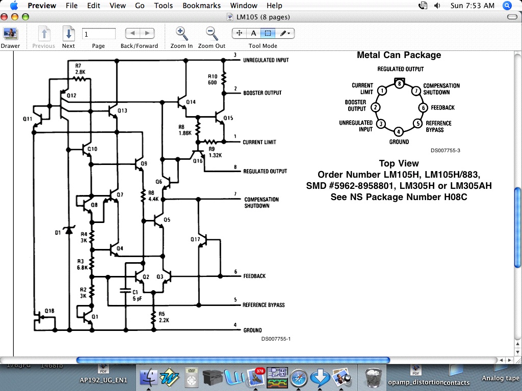

It's the reference that is really quiet - about 7uV IIRC. And, you can decouple it easily so it really is low noise. The LM3xx are about 30uV/V of output, to a 15V output has nearly half a mV of noise.
As Ed says who knows what's happened to the 723 process(es) now. The TI databook of 1996 shows a 5V output configuration as having 20uV of output noise 100Hz-10kHz with no lowpass filtering of the reference voltage of 7.15V, dropping to 2.5uV with 5uF bypassing the reference divider equivalent resistance of 10k. That's pretty decent. As this is certainly including some of the 1/f corner noise, and there is input diff amp current noise, that's still reasonably consistent with 7uV of mostly midband for the raw reference.
I should pull one out of ancient parts stock and measure it. I think I still have a couple in metal cans.
