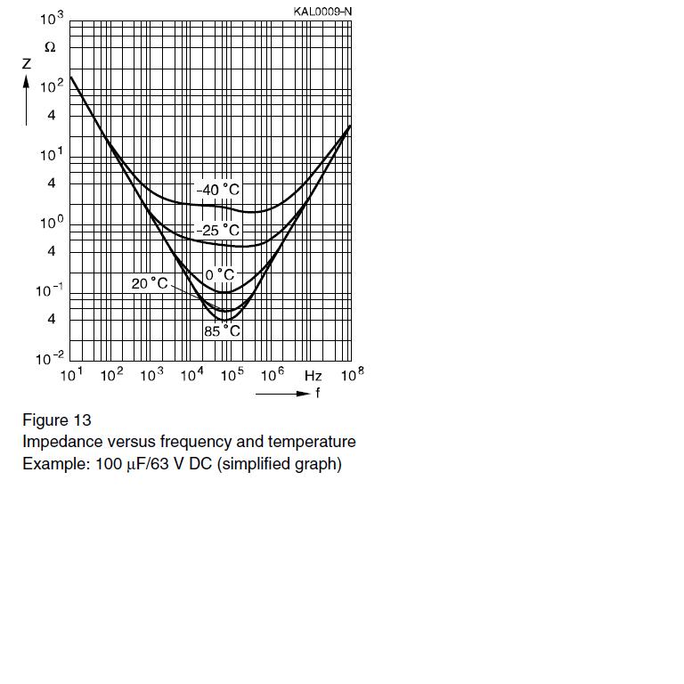

Now I see the source of confusion. The Equivalent Series Inductance (ESL) of most electrolytic capacitors is measured at .5 Volts AC RMS 100 or 120 Hz. Not at higher frequencies for data sheet use, as they are usually considered inappropriate for such use, unless specially constructed. The Equivalent Series Resistance (ESR) is the part of the equation that is considered to vary with applied DC voltage, frequency and temperature. Note these are modeling values not the small signal ones.
I have attached the graph showing how the attenuation varies with frequency and temperature for a 100 uF capacitor. I think it clearly shows the limits of such a capacitor. Note the dramatic change with temperature. real inductors don't do this.

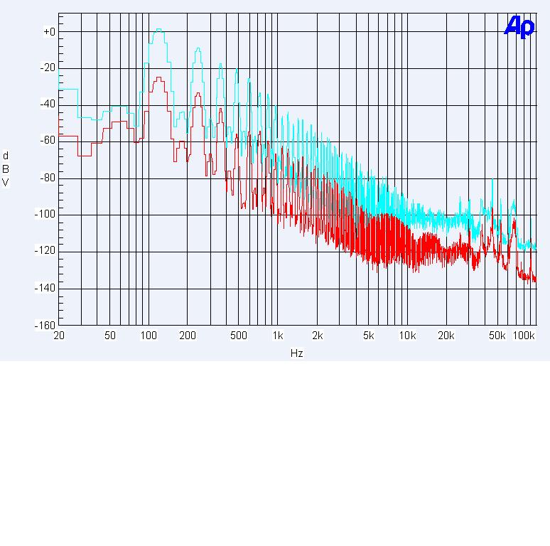

Now when you try to scale things such as this there is often a square or square root involve. However as shown in the second measurement the filtering effect of a .01F capacitor does begin to limit in the audio band. It shows the filtering comparison of a 470 uf and a .01F. The 470uF does not show the issue in the audio band. That is why many use equal value parallel capacitors to make the total filter capacitance. These are also augmented with smaller capacitors to extend the filtering range.
You are welcome to do your calculations showing - infinity or -165 or -220 or whatever you want. When you measure a real circuit you will be hard pressed to get -150 (all re 1 V RMS).
Now my listing of noise values is also based on measured performance. Interestingly Bonsai seems to have the same numbers.

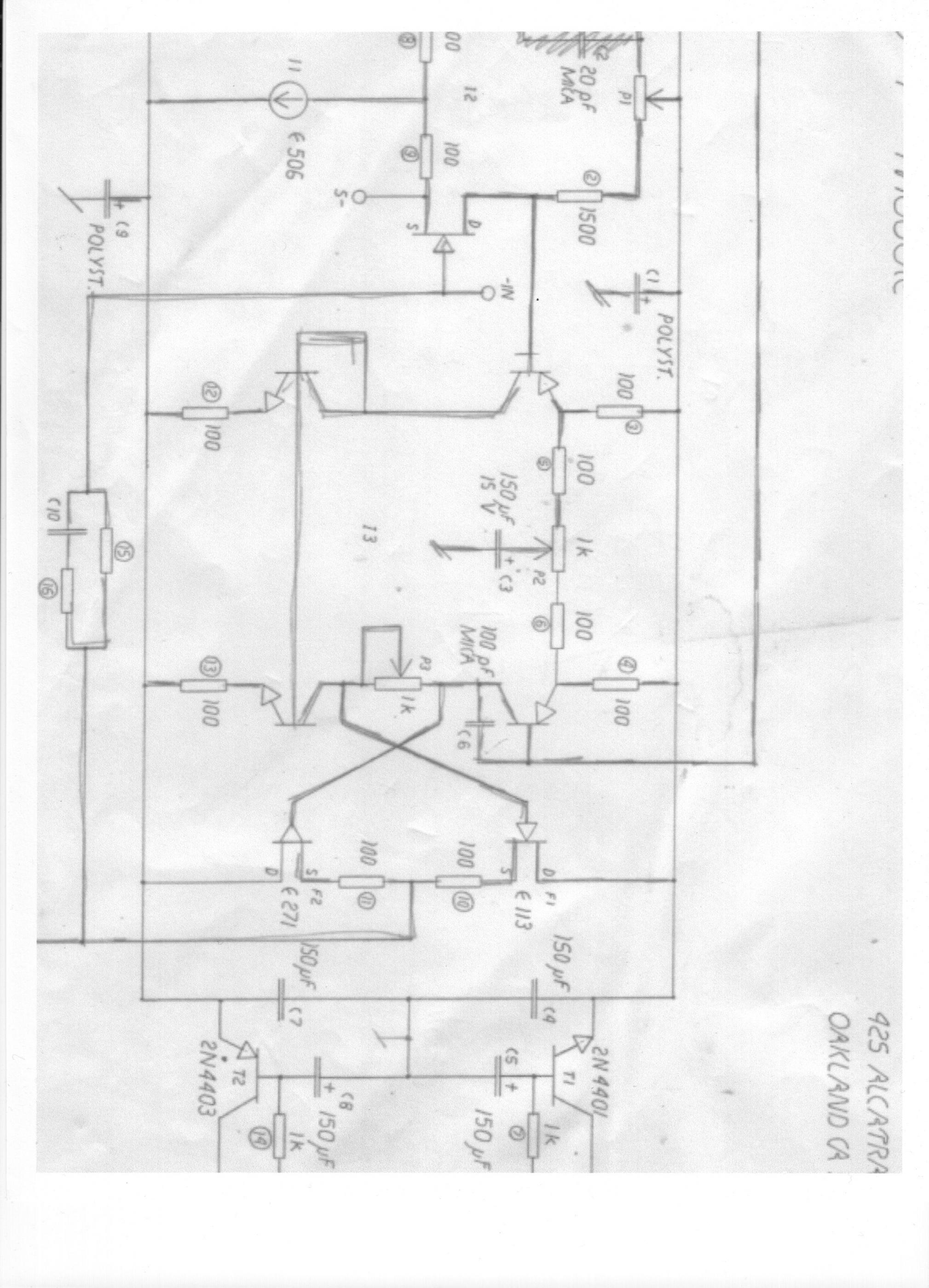

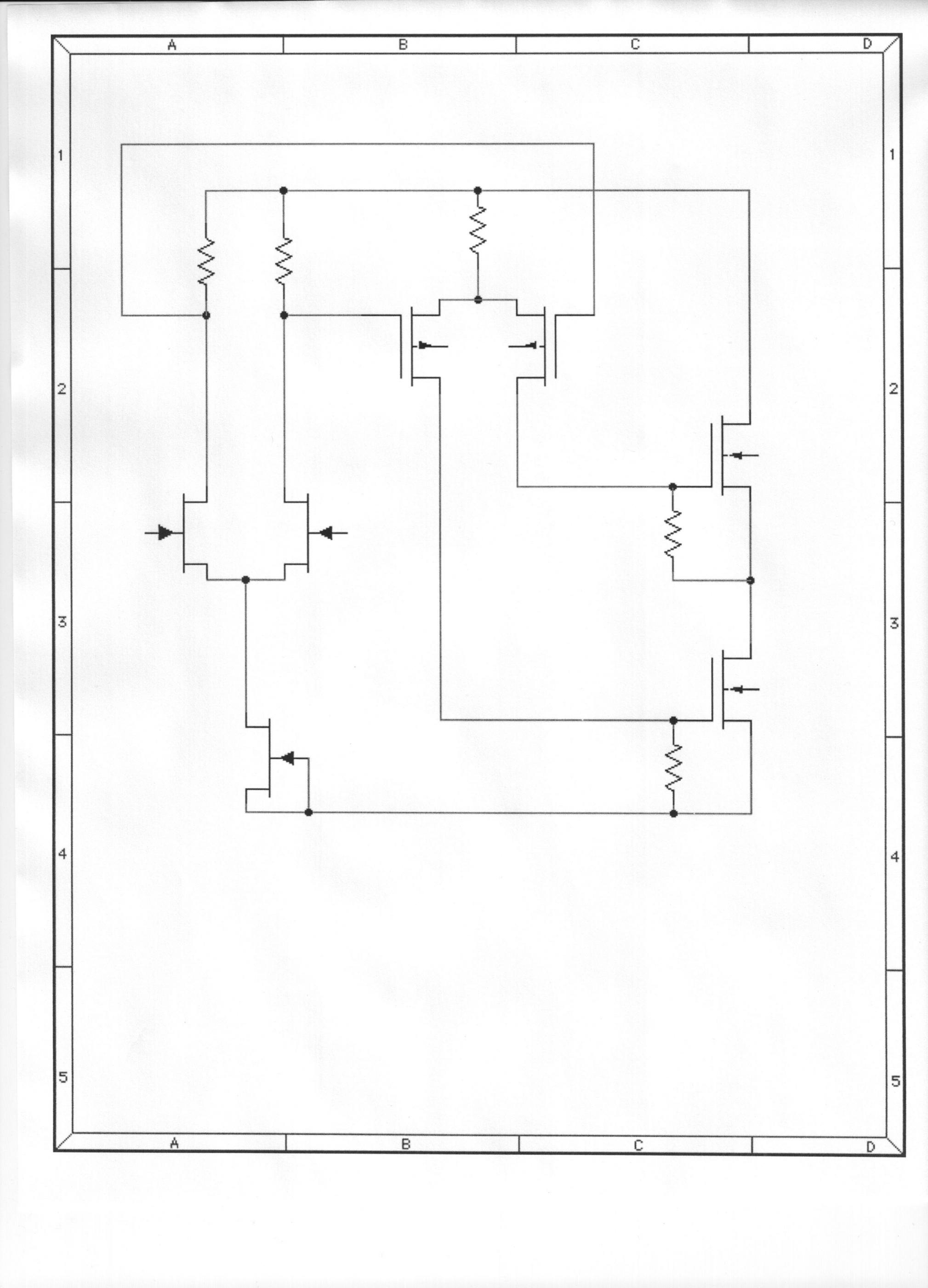

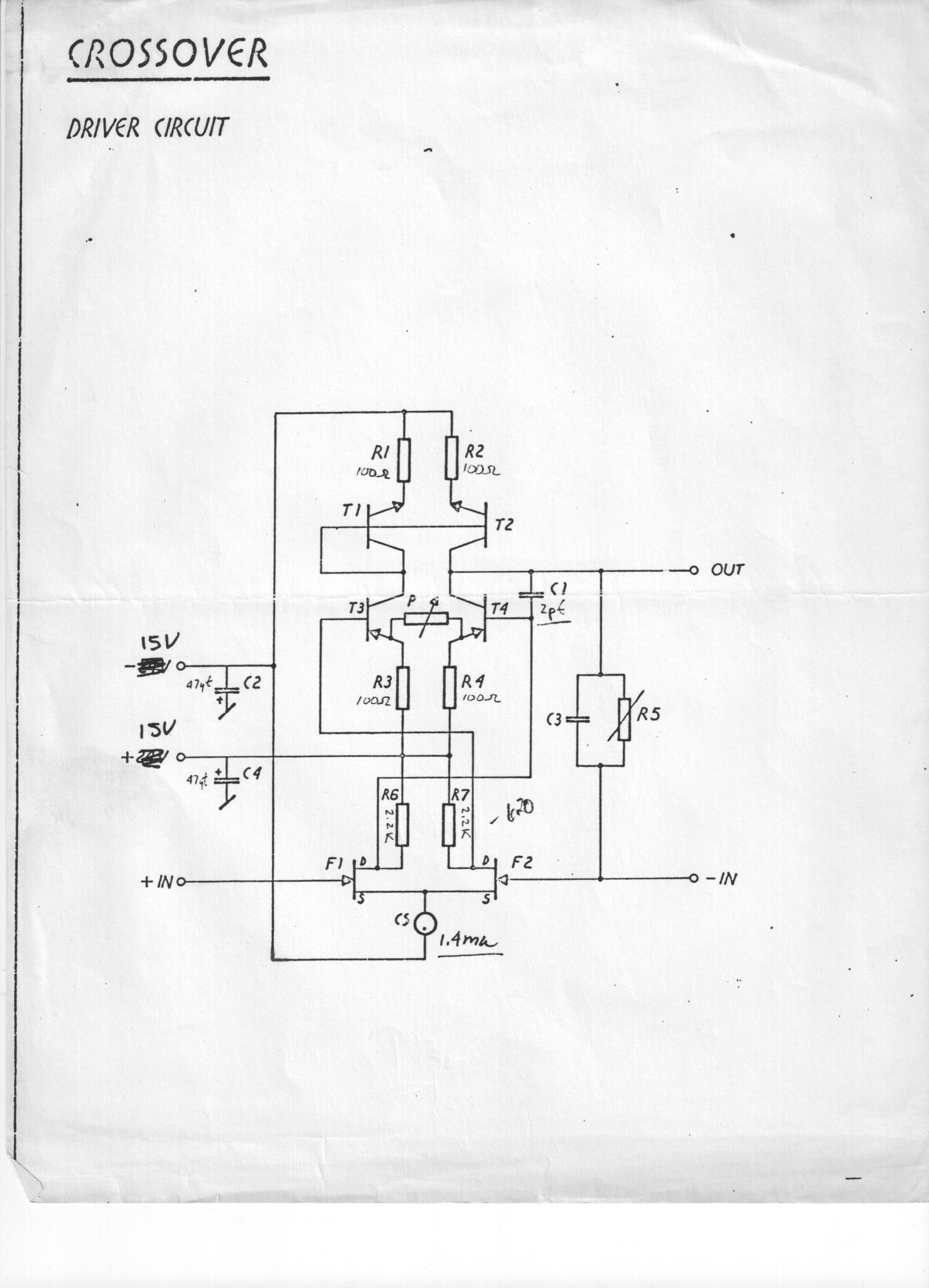

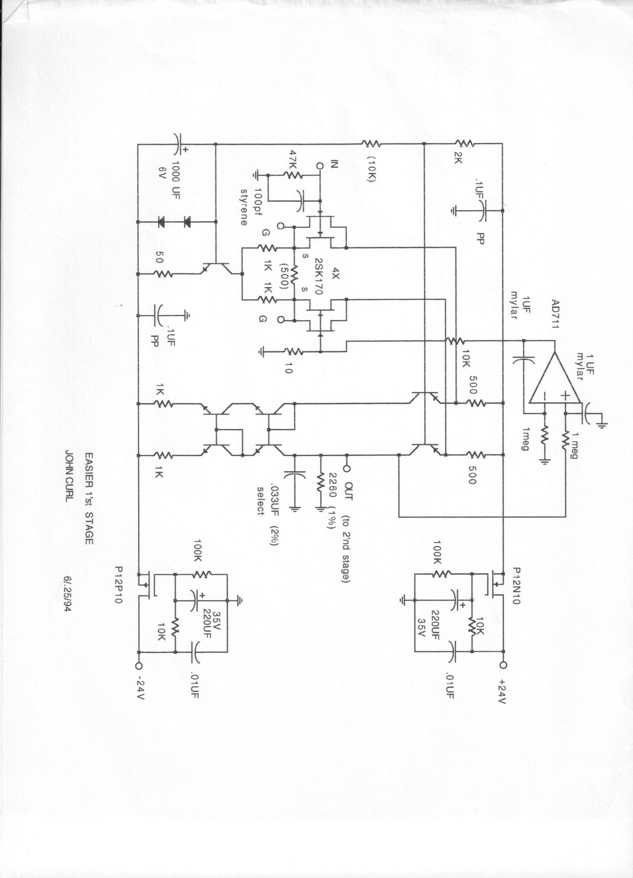

I would not have used the AD844 in any case, because my designs are usually based on complementary jfets, but I know that Charles Hansen of Ayre, used the AD844 for a time.
If anyone here would look at the schematics that I have put forth on this thread in the last year or so, they would discover a number of designs that use a dual jfet input and bipolar transistors for the rest of the design, unless I can also use mosfets instead. I have been designing this way since the Levinson JC-2 phono stage. It is not my 'best' effort, but it is easy to do, and works pretty well.
