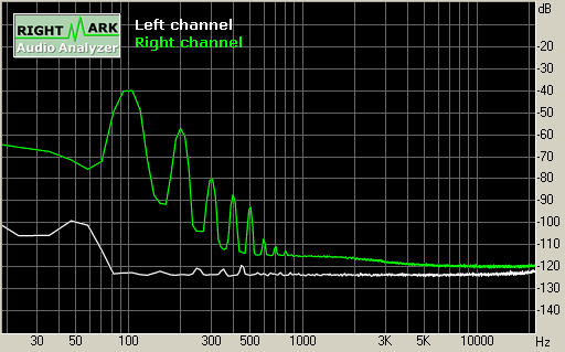

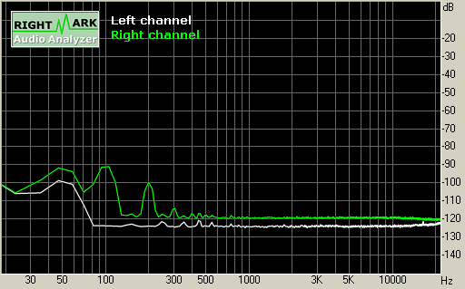

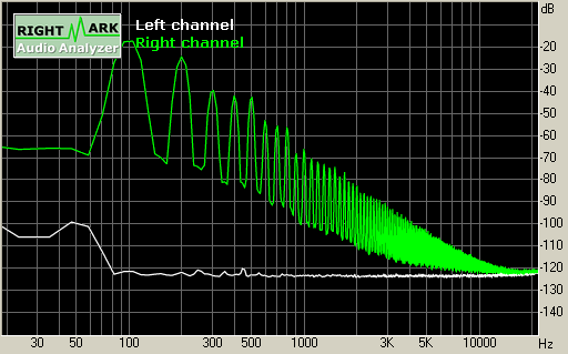

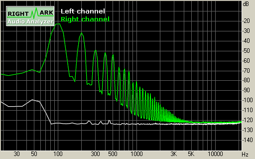

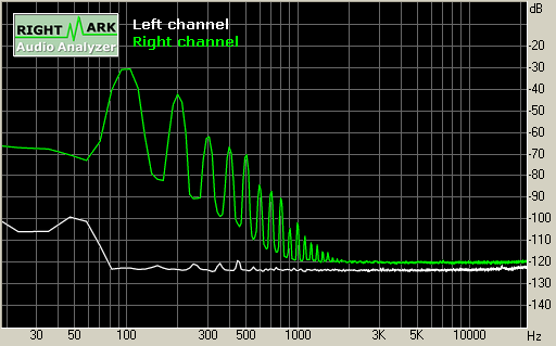

Attached are some spectrums from a sensing coil output, which was placed close to the x-former that was feeding the bridge/smoothing/regulator PCB.
I was recording the signal picked up while moving the coil, starting closest to the x-former and moving toward the circuit inch by inch.
George
>Edit: 1 inch, 2 inches, 3 inches, 4 inches, 6 inches
