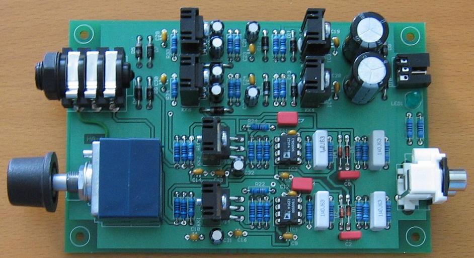

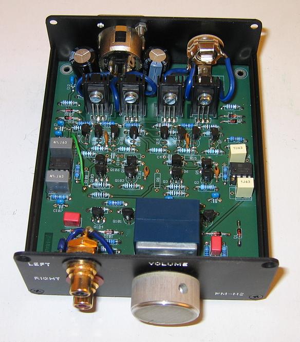

This is another one, a 2 box design prototype. Discrete sounds better.
What did you do differently on he discrete design?
What about this: http://www.ti.com/lit/ds/symlink/tpa6120a2.pdf 100 MHz and .0002% THD? The 7th harmonic isn't much less than the 2nd, but they are both in the -110 dB range with no load. Almost no external parts. The plots below I just measured.
Good to see TI reads the audio forums. I can't believe the tilt in figure 23 is real. Microphone preamps??? I guess it does everything.
