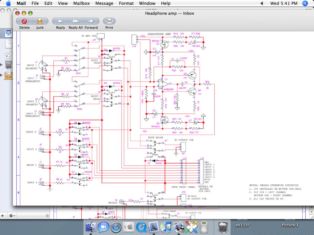

The circuit put up, was a test run for circuits drawn on my computer in future. The schematic shown is NOT completely accurate and the mosfets in the power supplly buffer are drawn backwards. This is a conceptual schematic, it has never been built, so it can have a number of problems. However, it served as a TEST, and as an example of the ACTUAL COMPLEXITY of even a simple circuit such as the headphone amplifier, in actual design in a product. It also answers how we sometimes use relays in general and how we hook them up, etc. However, DO NOT ATTEMPT TO BUILD this design as shown and expect it to work, unfortunately it won't, and even if the mosfets are properly turned around, this specific circuit has not been built or emulated.
Still, it has useful concepts, perhaps more than I normally show, as how we do things commercially.
