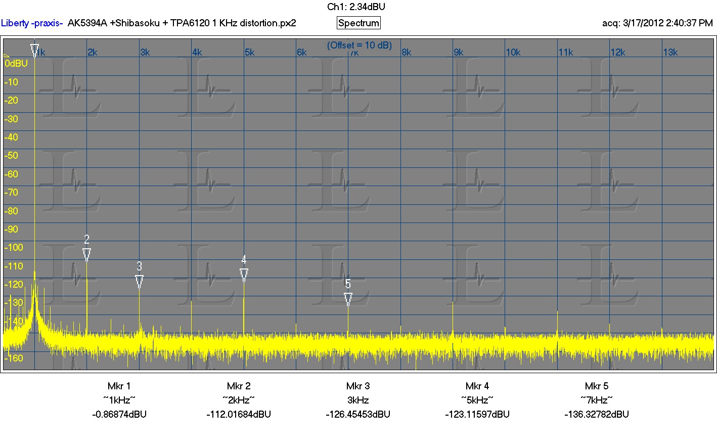

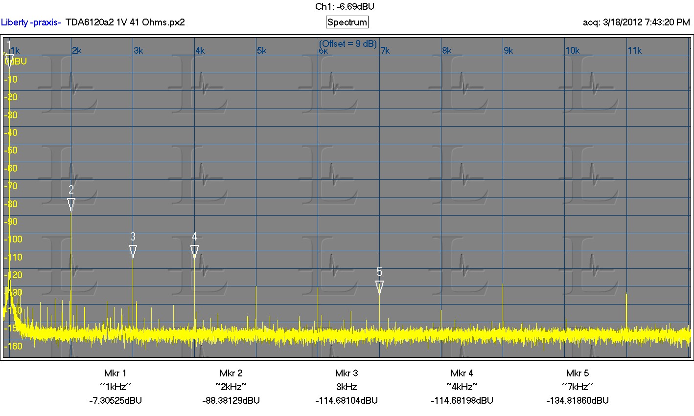

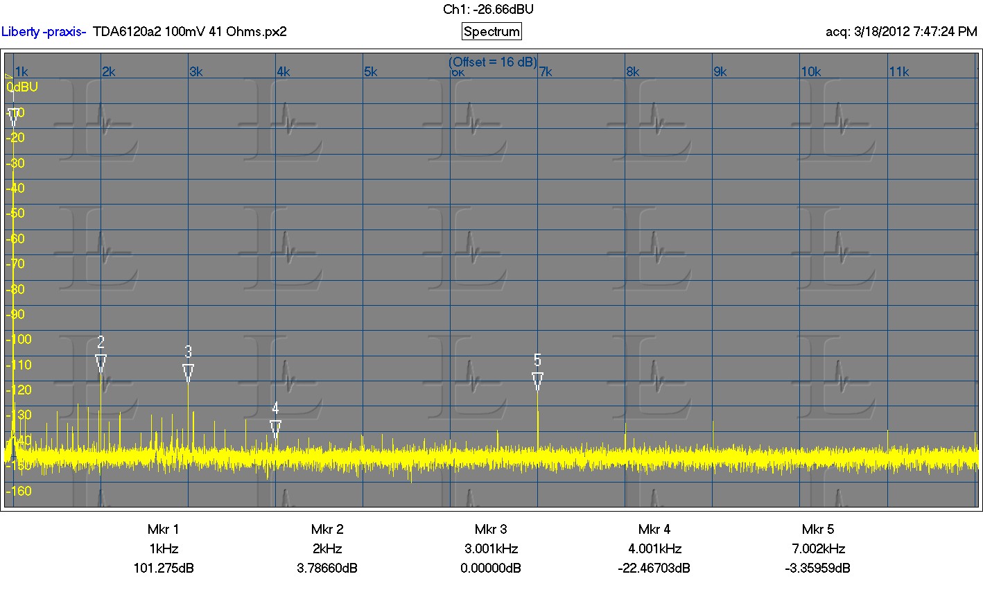

What about this: http://www.ti.com/lit/ds/symlink/tpa6120a2.pdf 100 MHz and .0002% THD? The 7th harmonic isn't much less than the 2nd, but they are both in the -110 dB range with no load. Almost no external parts. The plots below I just measured.
For what its worth except on the most insensitive headphones (Audeze? which is what I used as a load) even 100 mV is ear splitting loud. With a load the distortion increases but still really low.
This may not be the last word in headphone amps but you can't ignore it now. At least you get a lot for $2.00.
I have also found that a series resistor never seems to help. A voltage drive always seems to sound better, unless the bass depends on major resonance, which will usually sound pretty woolly in a headphone.
