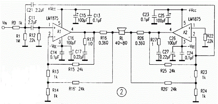

Hi Joe,
Please, any comments on this? I have some LM1875 in my draw. Shall I try this? Your comments highly appreciated
Yes, they should work nicely, just scale down the power supply and all that will be different is the less power to the speakers.

Hang-on, - I was under impression that you wanted to use some LM1875 for the original schematic I posted in #1 .
The schematic you posted in #83, I cannot vouch for as I have not built it. I note that it is a bridged version and that the "-" (inverting) input has an effective 2K input impedance and would be hard to drive - certain not a tube preamp.
Where is this schematic from and what is supposed to drive it? It is like having an incomplete picture.
Cheers, Joe
Why are there two feedback paths in each half of the amplifier?
Why are the two feedback paths set to the same values?
If you are referring to the schematic in #83, it is bridged - this doubles voltage swing with a lower rail voltage power supply.
Hi Joe,
you are right, it looks like the input impedance is too low for my tube preamp. I actually got this circuit from the site below. Any way I will try your single ended version. Many thanks

the bridged arrangement has two halves.If you are referring to the schematic in #83, it is bridged - this doubles voltage swing with a lower rail voltage power supply.
Each half has two feedback paths. Both of these feedback paths have the same values.
Why and why?
first time i've seen such a feedback arrangement..
i can only hazard a guess, that the 0.39 resistor is being monitored for current,
any tendency to run big currents decreases gain, how effective this is, i don't know..
Post 83 looks like it is arranged for low voltage use, such as when using a 12+12vac transformer at the power supply and getting 26W into a heatsink as well as 26W to an 8 ohm speaker from your bridge amp. At that voltage (about 17vdc rails), the LM1875's speaker output wattage is very similar despite load variance.
It is a current drive amplifier, so it could be used for guitar amp, old style classic design of full range driver (and other speakers made for correct response with tube amplifier's output transformers) and for more bass extension with ordinary sealed box speakers.
However, duplicated feedback loops isn't required for current drive amp, so there's an extra function of some sort??
