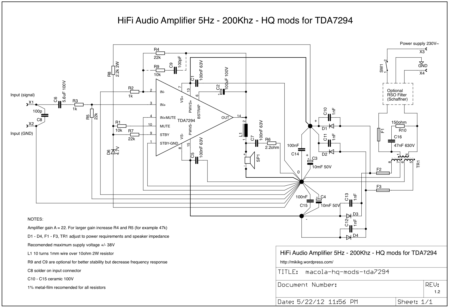

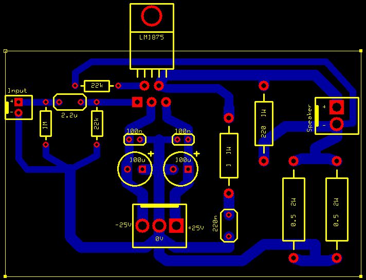

Here is one similar approach published in 2012, not exactly transconductance amplifier but similar in a way of wiring in order to reduce DC offset as some components in input/FB stage are removed in order to get better performance.
Wiring is very very import and need to keep it as shown on schematic.
Same rules apply and for Joe's version.
More info about this design here (use Google translate):
HQ modifikacija za TDA7294 – HiFi Audio Amplifier 5Hz – 200Khz YU3MA
Yu,
all the Signal wiring should not be taken to that star type Power Ground.
All the Signal wiring should remain close coupled Flow and return Pairs with low Loop Area.

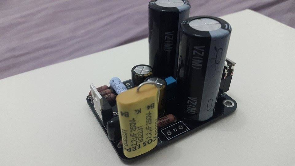

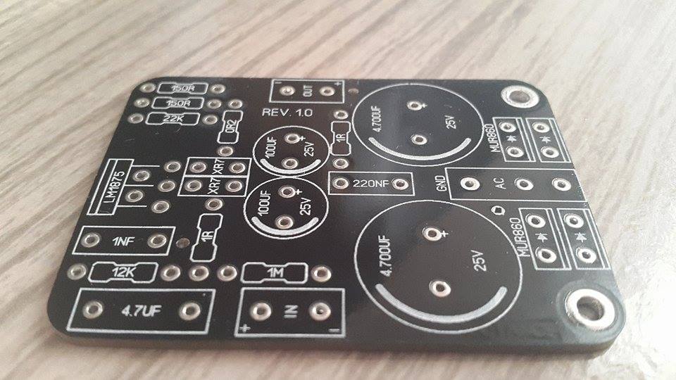

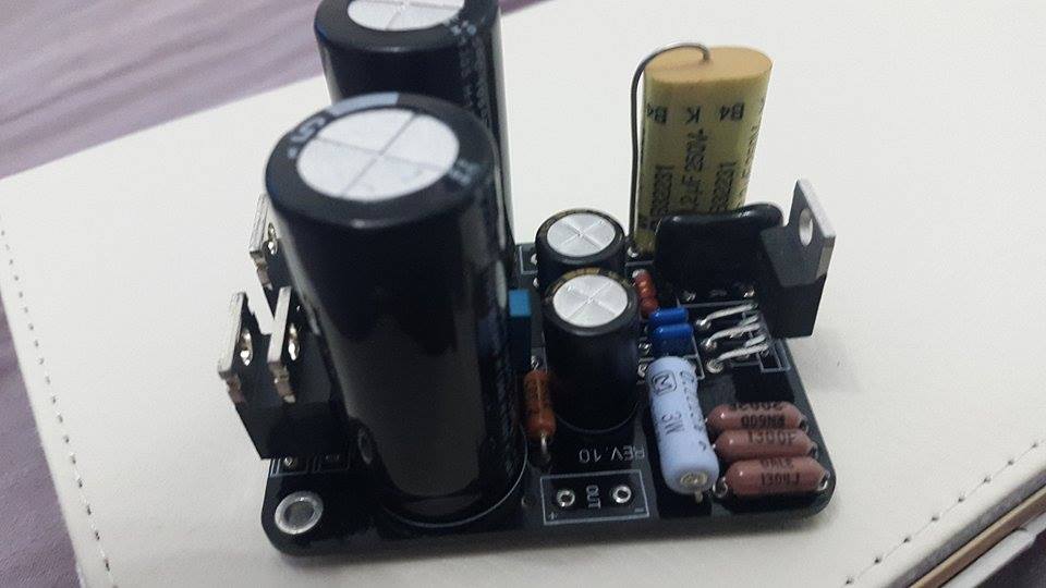

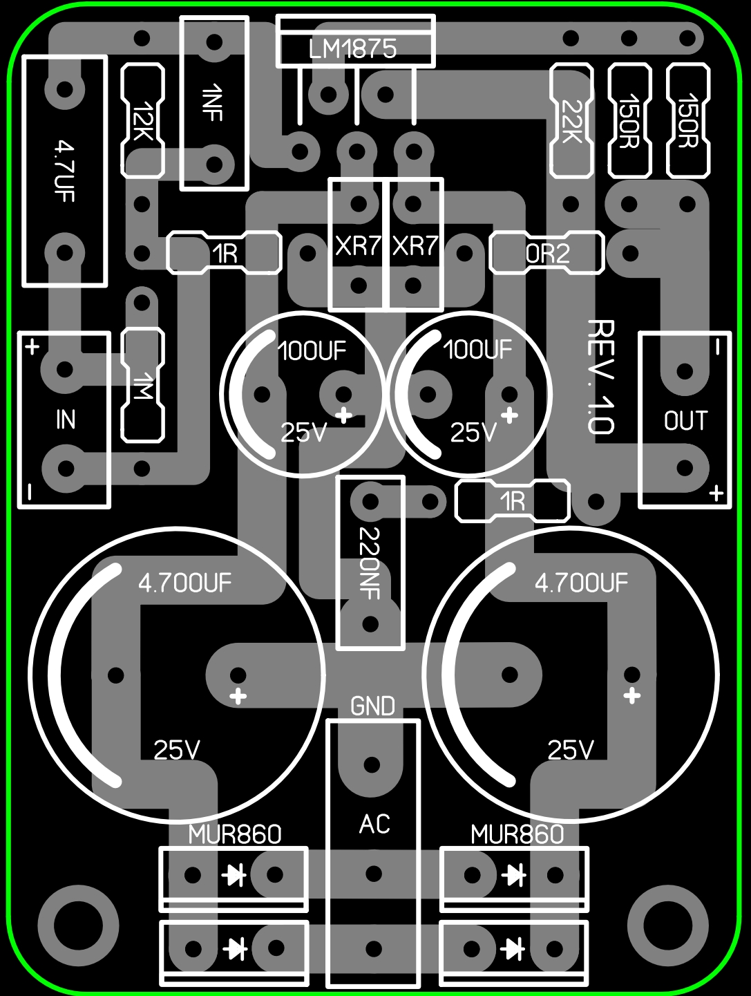

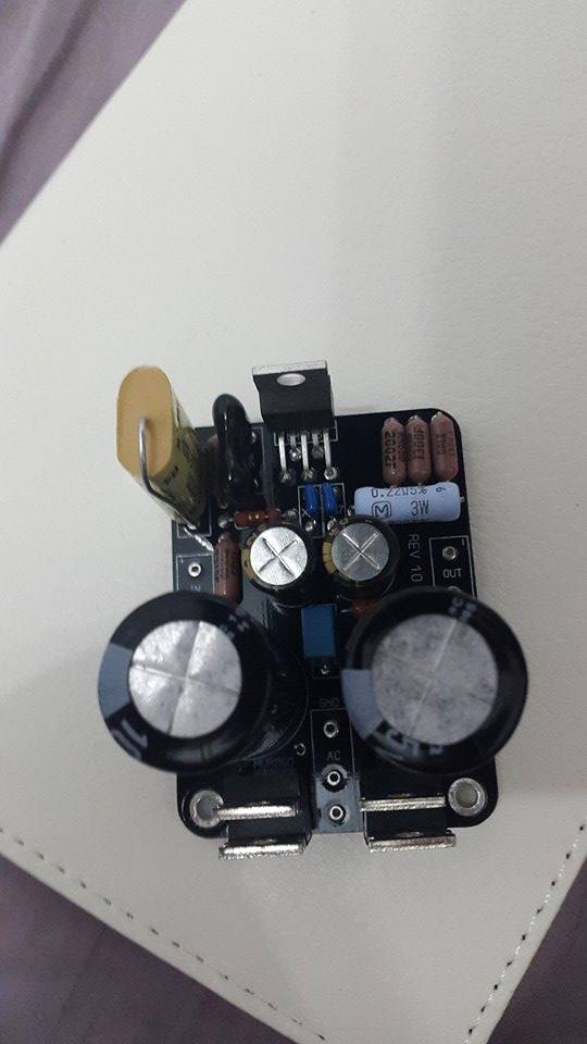

My friend had the PCB made for us to experience this current amp, I am using the Power supply board from PD's chipamp with a 300VA 26VAC x 2 R-core transformer and it is working nicely. I have been using it to drive a pair of the CHN70 for 2 weeks already and it sounded much better than my class D amp. No speaker protection yet, I don't think it is needed, no power on/off pop.

Can you post a picture of the amp ?
Can you elaborate on the sound signature of the amp ?
what size heat sink ?
Any dc offset?
I have send you a PM
thanks
kp93300

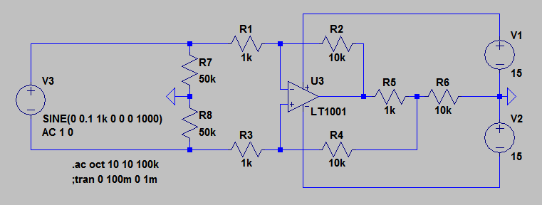

I looked into this design a bit more and completely forgot that it is an "Improved Howland" current pump. This app note from TI does a nice job of explaining things: http://www.ti.com/lit/an/snoa474a/snoa474a.pdf

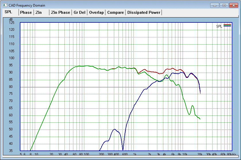

The Elsinores from Mk5 onward (current is Mk6) are the only speaker designs with crossovers published that are capable of doing this. Yes, I could be accused of big-noting myself as I am the designer and the only designer who has done this, but it is an accurate statement. Indeed building this 40 Watt design as per this thread, the very reason for designing this amp was to prove it to a few people who effectively accused me of being a liar. It was also to disprove the notion of "Damping Factor" as a complete myth. And I got that from speaking with non other that Richard Small (as in Thiele Small) way back in 1975 who mocked the idea and basically stated that an alignment can work with any source impedance provided that Re (the total series DC resistance) was adjusted. For example if Re of the driver was 6 Ohm and you added a 6R series resistor, then adjust Re to 12R and design your alignment and use the equations (and plotting) using that amended Re = 12. If you do that and you can find a well-damped alignment with the chosen driver, then hey, the fact that "Damping Factor" is only one means nought.
But when you use a current amplifier, then you end up with less than one (negative?) Damping Factor. Well, not quite. 😀
Let's say you have an 8 Ohm speaker and you are driving it with a current amplifier with a source impedance of 240 Ohm, then what is the Damping Factor? It is either 0.0333 or -30 (minus 30), well this is just being silly with numbers. Damping Factor is nonsense and one of the two guys who came up with the numbers treated the idea with total disdain. Good enough for me.
As Dave indicate, the resonant peak in the bass and the crossovers, they are all working while dependent on being driven from a voltage source (low impedance) and just won't work when driven from a current source.
The crossover will not track, especially the Tweeter becomes hopeless exposed. You will get a large boost in the crossover region and the Tweeter will typically be boosted by 10dB.
What the Elsinores do is to equalise (EQ) the current and keep it to a zero degree phase angle, and then something remarkable happens. I won't describe in detail yet, but look at the two plots below
The Red has the EQ and the Green does not.
Red is zero Ohm and Green is 240 Ohm.
One will simply not work (and likely to sustain damage) and the other works very well with both current and voltage sources, indeed that means it works with any source impedance.
Cheers, Joe

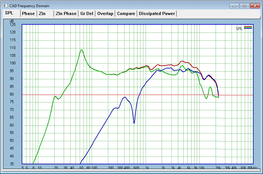

Let's take it a step futher, again using 240 Ohm as the source impedance versus near zero impedance that is "current" versus "voltage" sources.
This is the Elsinore Mk6 driven by a "voltage" source or zero Ohm impedance:
Now compare this with the Elsinore Mk6 now being driven by a "current" source, which is 240 Ohm:
Look very carefully - they are NOT the same. But both bass alignment and the crossover hold together quite well.
Can we see that both the bass alignment AND the Crossover still tracks quite well, irrespective of the source impedance, right.

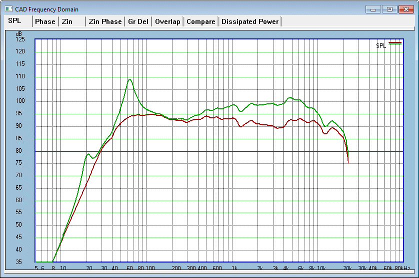

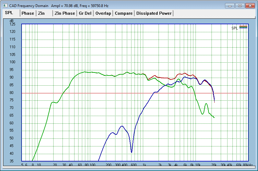

Now let stay with 240 Ohm drive, but this time take away the current EQ that Mk6 normally uses:
Again, this is 240 Ohm "current" source.
Both the bass alignment and the crossover are now no longer 'tracking'.
Now we can see what Dave was alluding to so briefly but quite accurately, that BOTH the bass alignment AND the Crossover have gone out of wack.
We can also now see just how horribly the Tweeter is now exposed, would produce dramatic distortion and possibly get damaged very quickly.
Why go through all of the above?
Because this 40 Watt amplifier described on this thread was designed to prove the Elsinores could be driven by an amplifier of any source impedance AND that so-called Damping Factor is a myth.
