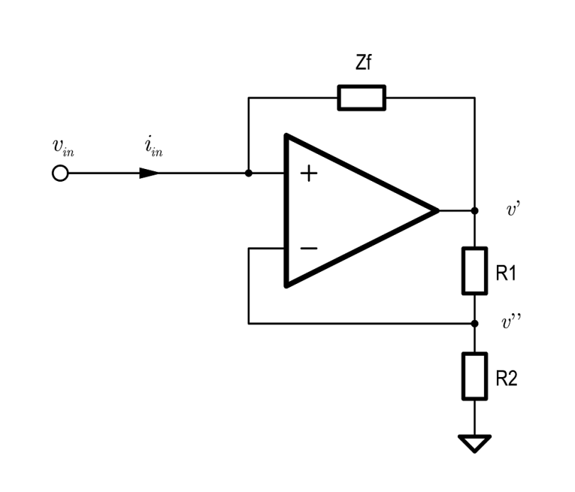

In terms of output impedance this may be of interest:
Negative output impedance:
https://circuitcellar.com/resources/quickbits/negative-impedance-converter/
