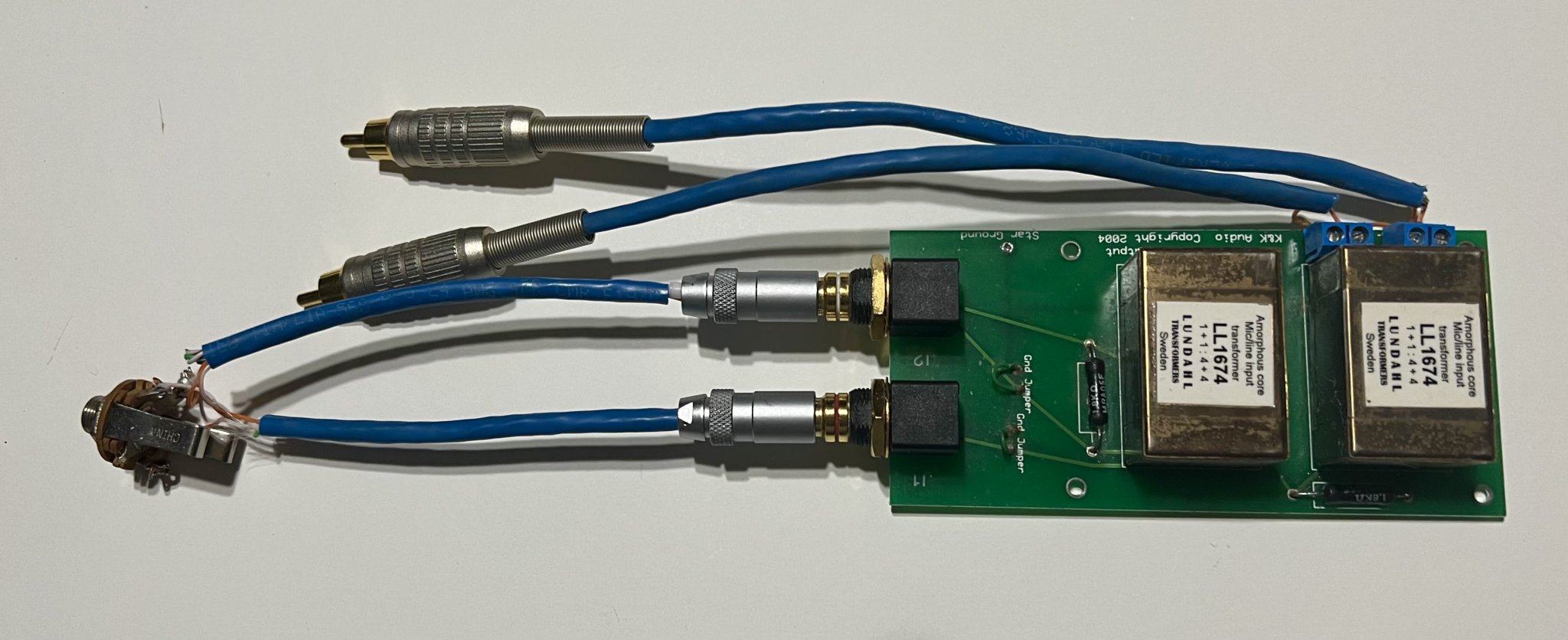

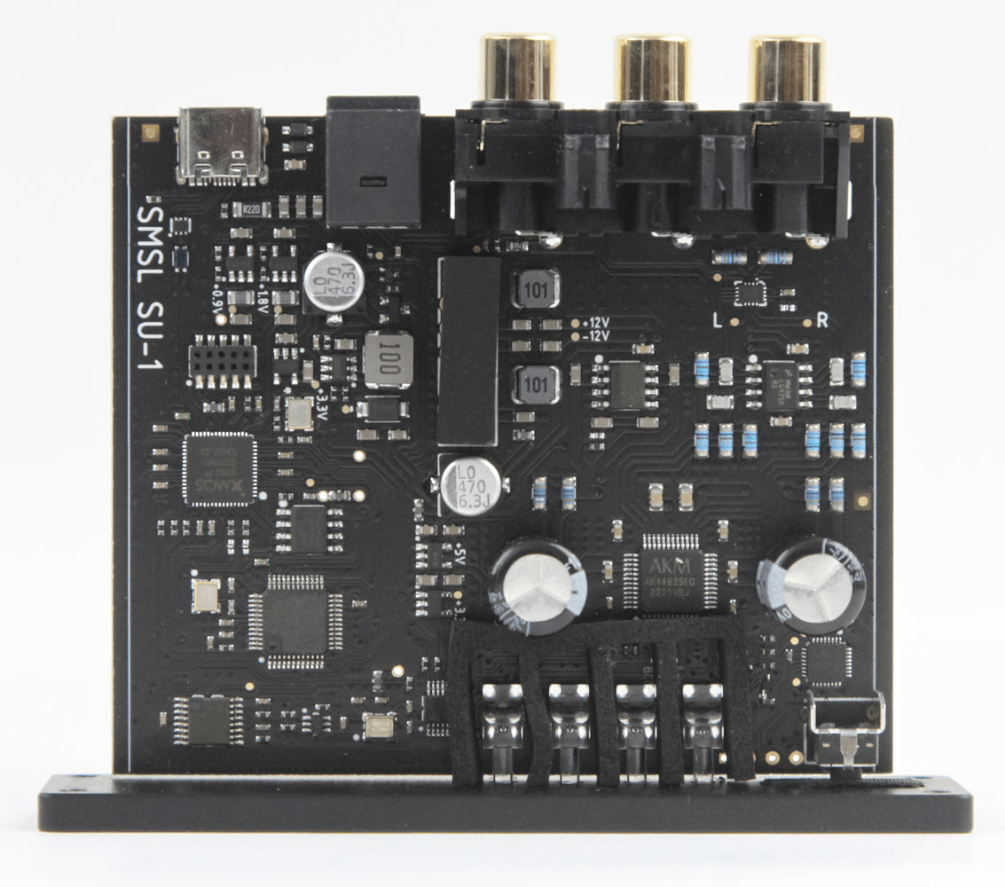

My viewpoint is purely subjective listening. I have been listening to the HD 600 for almost 20 years on basically the same headphones amp (micro ZOTL). but a month or so ago I bought a new inexpensive DAC (SMSL-SU1 ) which led me to disassembling my old DAC units(K&K RAKK DAC) which has a transformers(LL1674)output circuit board in 1to8 configuration.I decided to hook them up directly to SU1 output then to HD600,astonishingly it had enough volume to sound correct for me , a much improved base response, clarity that I’ve never heard before, all instruments seem to be more spaced out than before. l’m just looking for new avenues for headphone amp and I have a quantity of LM3875 chips. Below is a photo of new listening rig , passive headphone amp?
The DAC SMSL SU1 DAC has what output? I suspect it has ICs to buffer and filter the AKM DAC.

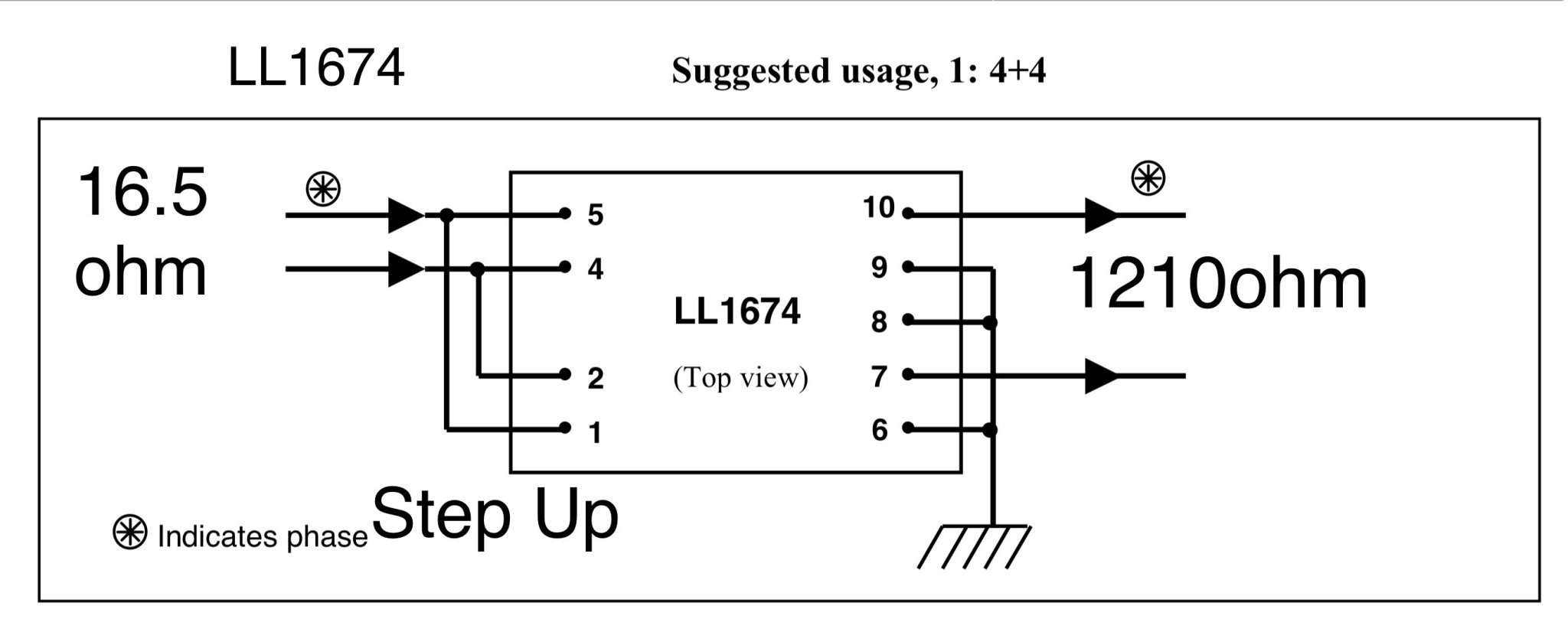

Transformers can be used on the outputs of the AKM DACs, but generally that would be 1:1 and for line level. I have done this and really good results. But headphones? That's different. Maybe set the the LL1674 as 4:1 step up rather than down. Will be DAC be able to drive headphones via step-up? Just thinking aloud though. The AKM DAC has a 32bit volume control, I believe. In the Oppo 203 with AKM DAC it worked nicely. Again, just thinking out loud. Are you using the AKM DAC's volume control?
The primary are wired in parallel at one, the secondary are wired in series 4+4 . The secondary have a parallel resistor, which is 1500ohms.I measured at the resistance with the headphones plugged in which is 208ohms.The output impedance of SU-1 is 47ohms. below is a photograph of how the transformers are wired.
The trick here is that it is single ended power supply and I see that you have two blocking capacitors, so it looks OK to my eyes.
