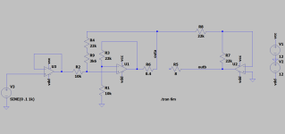

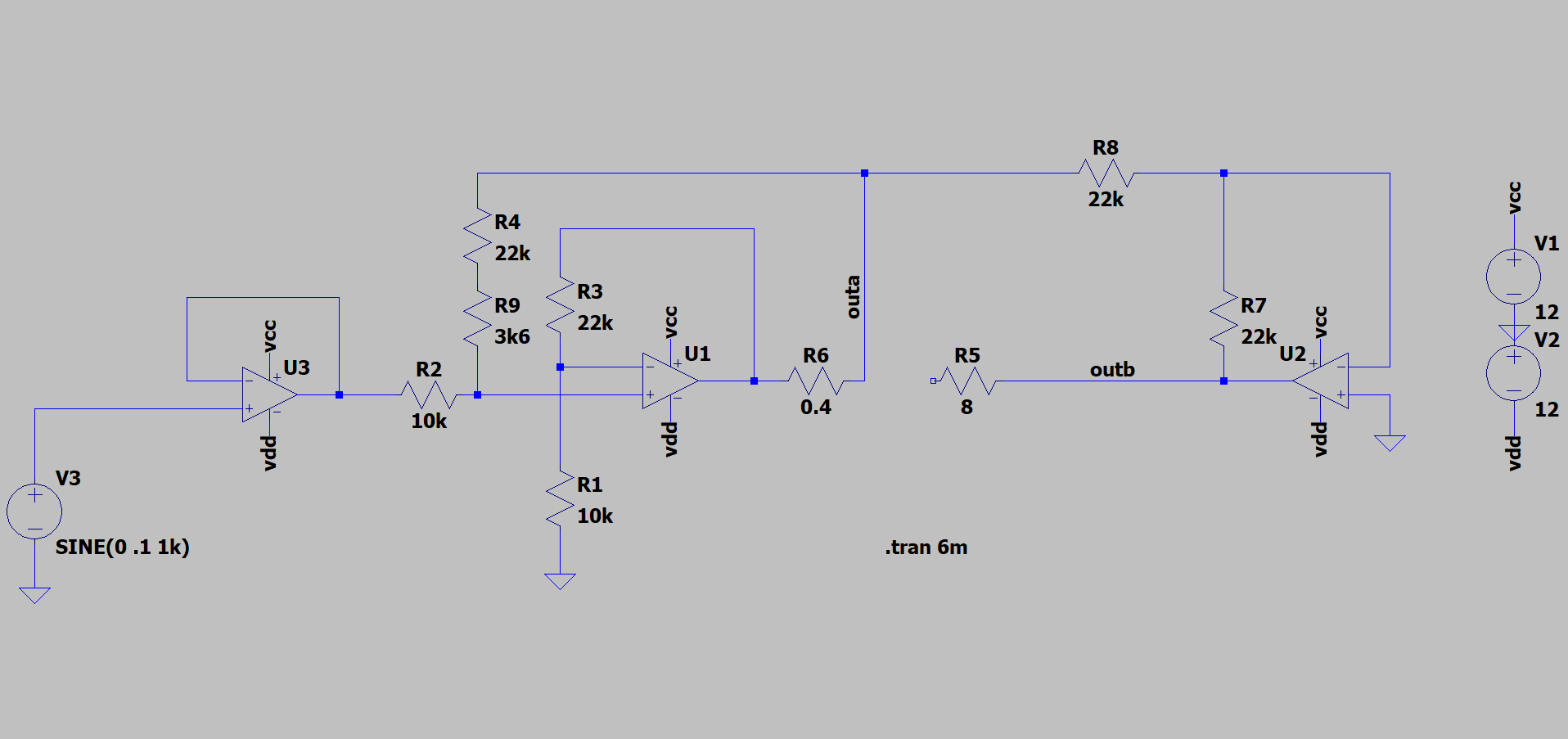

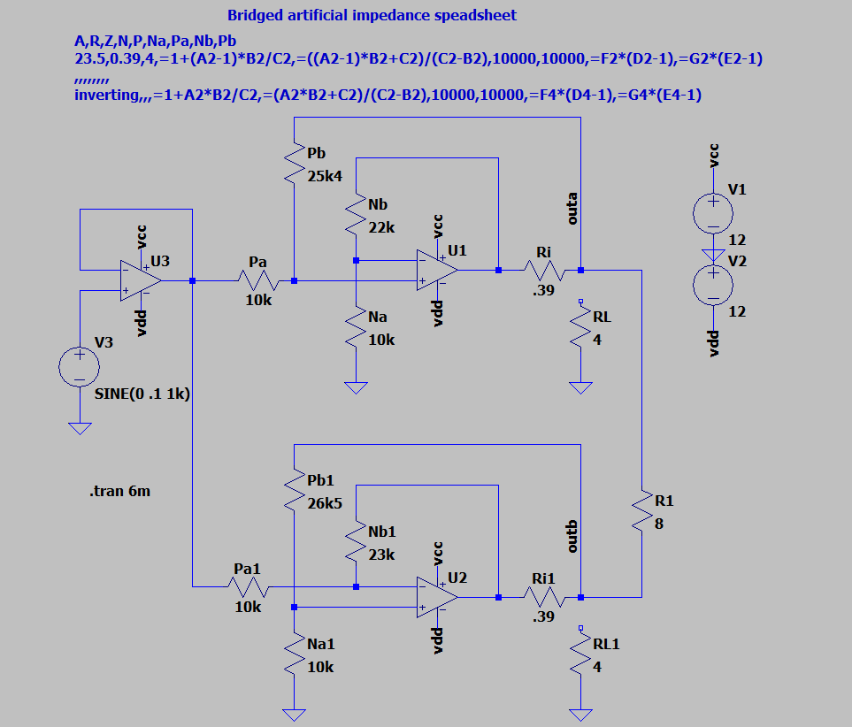

I posted this before, to program the output impedance to say, 8 Ohms. The non-inverting circuit is a bit different from the inverting circuit. Both require an input buffer because the feedback requires a ~zero impedance source. Let me see if I can find the simulation and feedback resistor spread sheet:
CSV file:
A,R,Z,N,P,Na,Pa,Nb,Pb
23.5,0.39,4,=1+(A2-1)B2/C2,=((A2-1)*B2+C2)/(C2-B2),10000,10000,=F2(D2-1),=G2*(E2-1)
inverting,,,=1+A2*B2/C2,=(A2*B2+C2)/(C2-B2),10000,10000,=F4*(D4-1),=G4*(E4-1)

Oops, wrong png file:
This is just two 4 Ohm outputs. It was made to address the bridging issue, but you just need the non-inverting part. You can copy the text into a CSV file and adjust the gain, sense resistor, output impedance and one part of each feedback divider (Na,Pa).

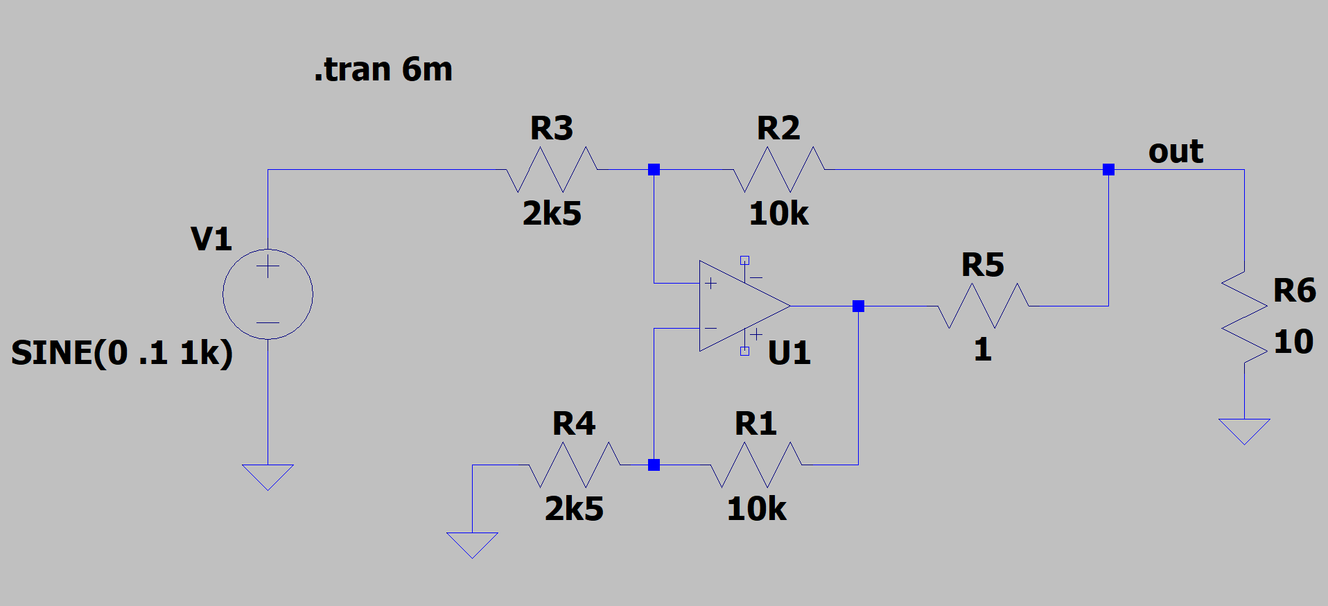

The constant current "Howland" circuit is simple because both feedback dividers are the same. The Voltage gain is the product of the feedback divider ratio and the load/sense resistor ratio. Here 4x10=40, 10k/2k5 * 10/1. (The amp still has the same clipping voltage as a voltage output.) The input source impedance has to be (near) zero, ie buffered. There is a potential issue with chip-amps that have a limited common mode input voltage.

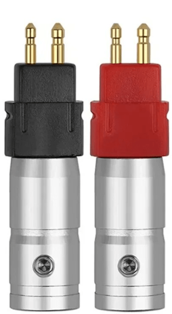

Having said that, current driving 300 Ohm Sennheiser headphones, that's an interesting proposition. I have a pair of HD650 (they have been around for many years and still around) and they are 300 Ohm. You can buy the separate left and right connected and make your own wiring/cable back to the amplifier I have got.

It would be great to see your graph And I could make up a cable also that would work .

When I get those connectors, yes I ordered them on AliExpress, it will be easy to measure the impedance, it should be interesting. Will EQ be required? Yep, we need to see. Re HD600 vs HD650, I have heard some prefer HD600, but I managed to get HD650 around 1/3rd of their current retail price.

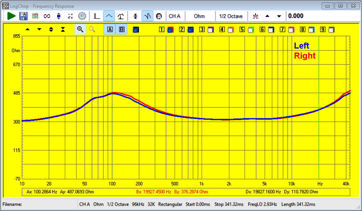

I did measure both channels of my Sennheiser HD650 headphones:
In my opinion you could use a current source to drive these headphones. But there are a couple of things to keep in mind.
1. Yes, there will be an emphasis centered around 100Hz. I am not saying that it won't be audible, it will. But it may still be acceptable and some might even like it that way.
2. The measurement goes up to 40KHz plus and the impedance is almost be flat to 10KHz and so will the response. Here I suspect it will be much less audible as a difference.
3. And this one is easy to overlook: To get real current drive with this high an impedance, the source impedance needs to be huge. The minimum requirement that bot Esa and I agreed upon is 5:1 and that means a source impedance of 1500 Ohm. If the impedance is lower than that, then the boost discussed in points 1. and 2. will be much less.
Any other thoughts?
