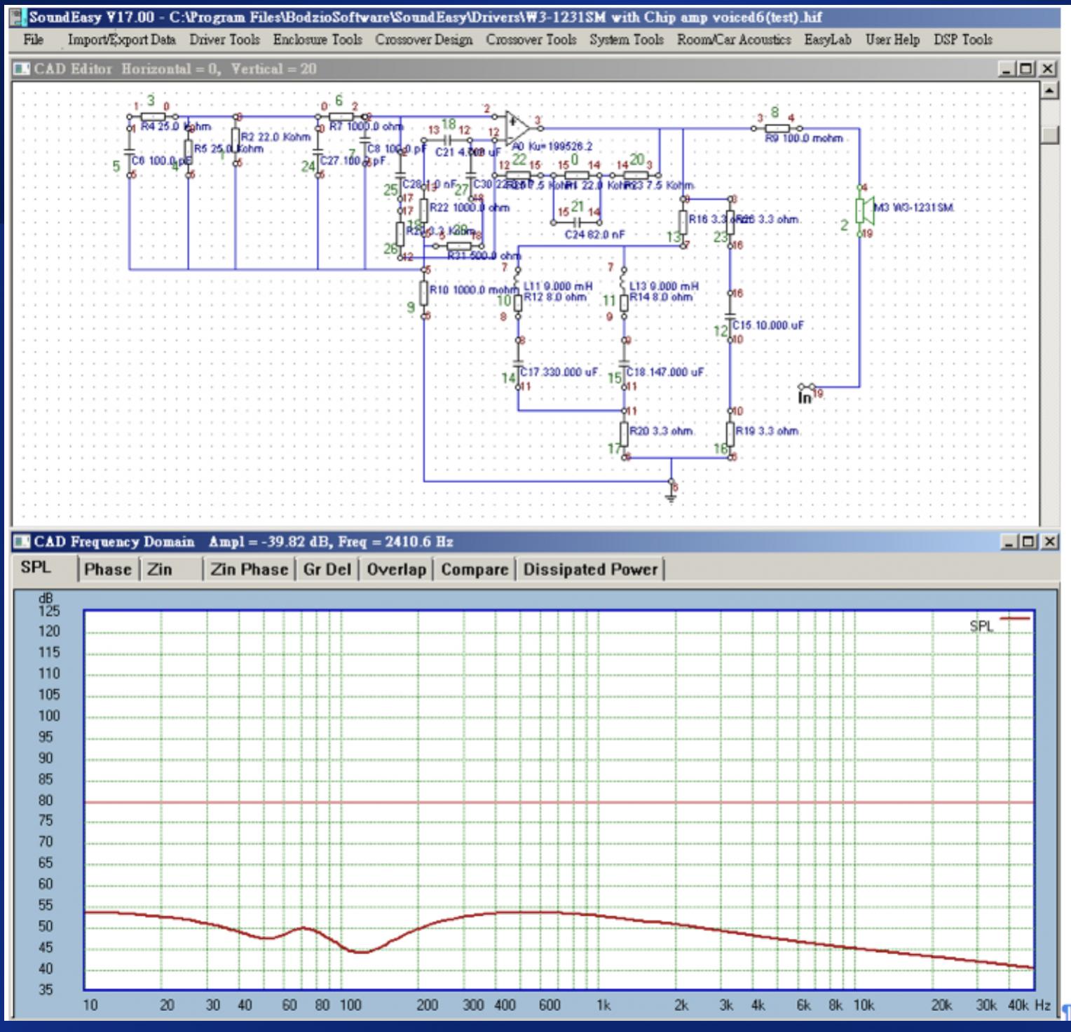

I can understand what is being said, but I fail to see any measurement that relates with improving sound quality?

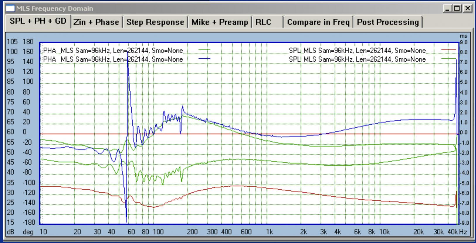

This is an example of how I would do a measurement (red curve data taken from the point after the 100mohm resistor at the opamp output)
Basically, the lower the red curve is, the better clarity in sound. The shape of the curve would be somewhat at inversion of the driver impedance. Sometimes the higher frequency end may have an upward trend deviating from the expected. This means some mod in the amp design is necessary.
