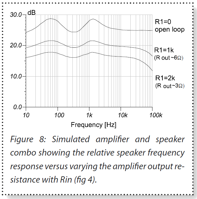

Joe, I hear what you say, but how does that figure with the known phenomenon that with higher amp output Z, the speaker starts to deviate from flat due to decreasing damping.
See attached graph, where the speaker coloration due to lack of damping increases with higher amp Zout.
Jan
Jan

Damping is usually thought of in terms of a resonator which is critically damped with a resistance equal to it's characteristic impedance Zo=sqrt(L/C). Mechanical resonators can be thought of the same way.
Resonators are also good antennas, so yes there is an aspect of interference.
For a parallel resonator, which is what the speaker's electrodynamic impedance is, a parallel resistance increases damping whereas a series resistance limits it.
Most speakers are designed so that they can never be overdamped due to what is driving the speaker, so the coil resistance is about equal to the Zo of the electrodynamic resonance at Fs.
