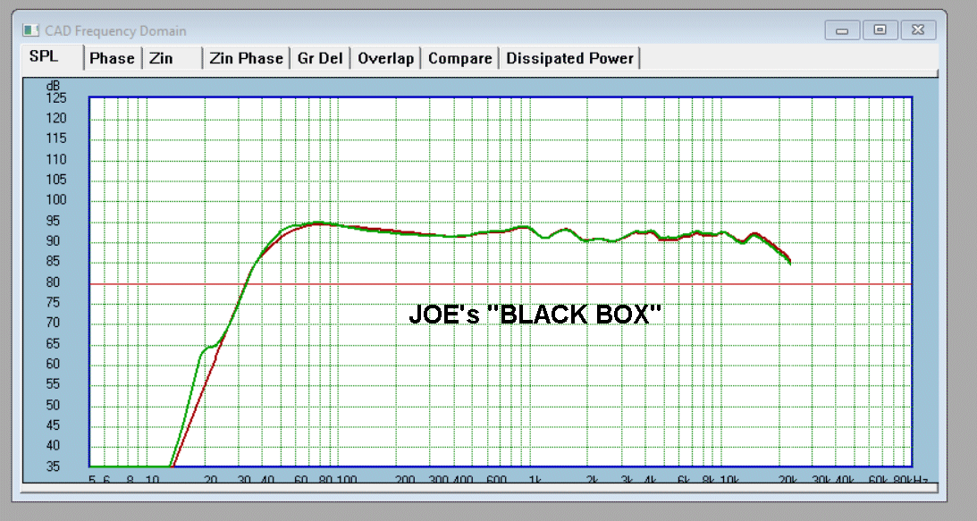

Now you have turned a whole speaker system into a 'black box' of sorts. It is still leaving a lot of stuff unexplained like my car is a 'black box' would not satisfy anybody. Maybe if we reduced it to only two wheels? Just kidding! 😀
Would anybody accept a loudspeaker system as a black box, after all, it only has two terminals? I think that is a fair question to ask.
Indeed, we should be able to ask exactly what a black box is!
Green = current source.
Red = voltage source.
Joe said:
"How about making the speaker draw the same current at all frequencies?
That way you cancel out the output impedance of the amplifier and it doesn't matter if it is a voltage source or a current source."
Of course the Zout is NOT cancelled! That Zout, together with the (frequency independent) impedance of the speaker determines the current delivered. Double Zout, you halve the current.
And what is the advantage if you make the driver draw the same current over frequency? That in itself doesn't give you anything; I believe what you'd want instead is constant acoustic output over frequency, a flat frequency response. (Possibly corrected for directivity and such).
If that leads to varying current draw over frequency, so be it - we are perfectly able to design amplifiers that have no problem with that.
