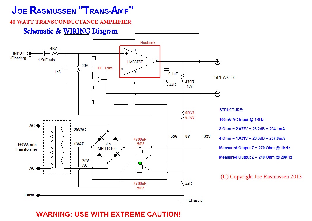

Joe, I know this is an old thread, but I hope you do not mind few questions before I burn few chips. I was recently experimenting with transconductance lm1875 amps, and they are all working fine and singing beautifully, so I feel the need to work with lm3886 next (because I have plenty).
Can one substitute lm3875 with lm3886, assuming correct pins are used, without any changes to the schematics in first post?
Can one put trim pot on the positive rail side if needed? Could one do trim pot between the rails, to make it universal?

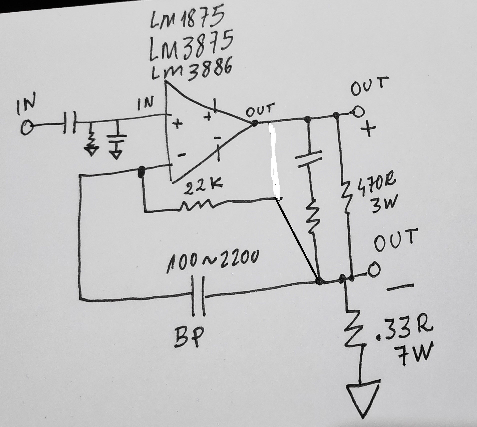

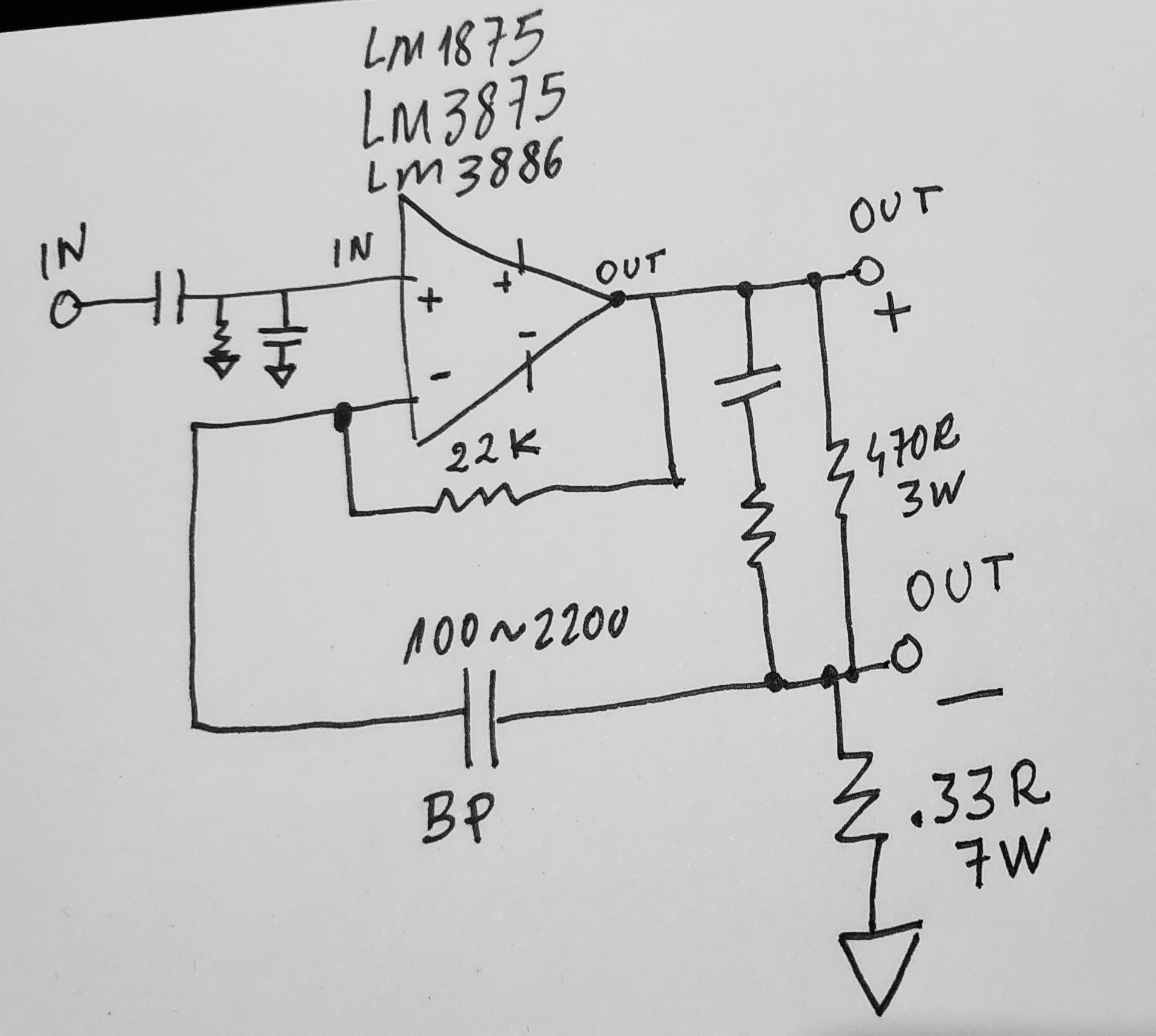

Thanks, i got that one up and running. Sounds sweet and musical. Now i am working on lm3886 and have some dc on the output, in some cases positive, in some negative, hence i was asking about universat trim.
Any specific info about that cap mentioned few posts back would be nice, but schematics would be ideal.

Dear adason and all,
Sorry for the delay, I need to use google translator. This scheme works for the three LM chips. Two I tested, 1875 and 3875. Other components like the schematic Mr. Rasmussen. I already asked for your guidance for these current amplifiers: they sound great.

Thanks! Now the cap placement is clean as a whistle.
Your schematics is different than from Joe in the first post. Yours is using 22k feedback resistor from output to noninverting input. His feedback is not from the output, but after 470 shunt resistor from the output.
Lots to test!
Lots to test!
Hi adason,
It can be just like you drew. But look at the link at Loudthud @ 06: 30h, when JMFahey teaches how to make a current amplifier for guitars: Transconductance LM1875. You can also see a good article by Mr. John Lenard Burnett at the link Amplifiers: Solid State amps verses Valve amps. Forgive my bad English again.
No. The DC feedback shall come from the output to have unity gain there (and then no need for a DC adjust). Your schematic is fully DC-coupled with the 22k which is simply shorted out by the cap at higher frequencies.augustoriodosul, would this make more sense to be true transconductance amp?
feedback needs to read after the speakers
The "true-ness" of the amp is governed by the 470R parallel resistor and the parallel "snubber" R+C but it is way good enough the way it is for speaker driving. True current drive from DC to 20kHz (Z_out >> 1kOhm) is neither actually required nor a good design requirement to start with, and would be very hard to obtain anyway.
No. 470R resistor does no create 'true-ness' of any kind. Its just there to protect wild voltage swings when speaker is unplugged while running.
When one is careful, it can be omitted, its shunt by speakers impedance anyway.
No. R+C 'snubber', otherwise known as zobel has nothing to do with current drive, its used to shunt high frequencies in any amp.
True key to current drive is 0.33R resistor.
