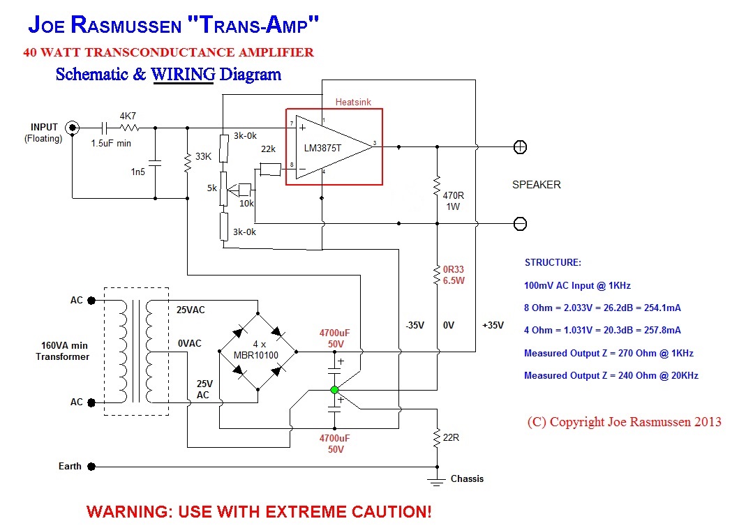

470 ohm resistor: current amplifiers, the higher the impedance of the speaker, the greater the power. The equation is 8 ohm / .33 + 1 = a gain of approximately 25. BUT if you turn off the speaker, the impedance is infinite, burning the amplifier's output. This is the role of the 470ohm resistor: ballast, in case the speaker is turned off. Interestingly Mr. Esa Meriläinen does not mention this device in the book.

Esa Meriläinen shows you how to turn any voltage amplifier into a current amplifier. There may be an exception that doesn't work.

There's another error in that schematic in #489 - the speaker current is supposed to be sensed through the 0.33R resistor, but as drawn the speaker current is not going through it. As drawn it is a voltage drive/voltage feedback amplifier.

Actually I think it is correct. Feedback is taken from the top of the resistor and input ground is on the other side of the resistor so the input voltage is imposed on the resistor which determines the current through the speaker.
