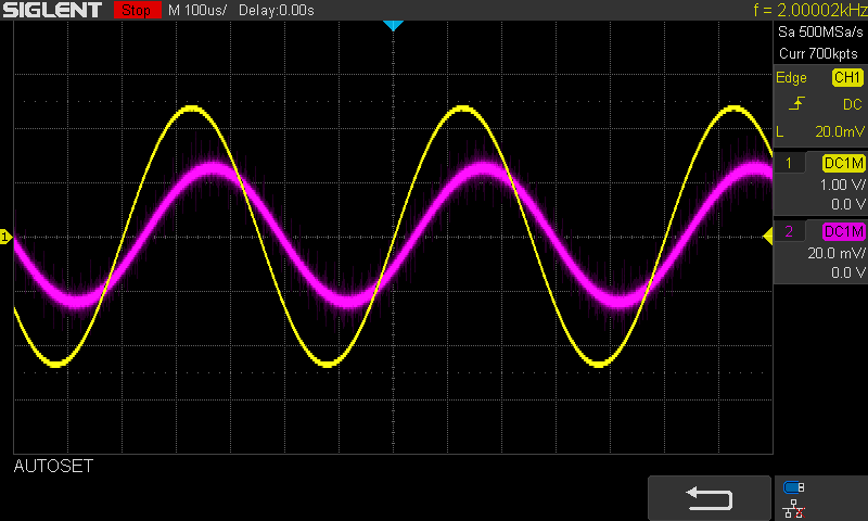

And 'current measurements' is the key and right now looking at a series of such measurements that will show results that will be surprising: That amplifiers can have two different distortion profiles at the same time, one on the voltage side and another on the current side - and the current side will have more distortion than on the voltage side. The first two measurements have already been done, not just by me but also by somebody else. Take a typical 2KHz sinewave into a single driver, put that on Channel 1 on your scope. Now fit a 0.1R current sense resistor on the return side, a small voltage that represents the current. Now put that small signal through a low distortion amplifier with a gain around 60. Since the DC resistance of the voice coil is 6R, you have now the Vre of the driver. Multiply the Vre by the current of the amplifier and you will have the dissipation of the voice coil. Only this part of the impedance dissipates heat, the rest of the impedance above 6R does not. I have been attacked for calling this part of the imepdace the "back-EMF impedance" and yet I stand by it. Now put Vre on Channel 2 of the scope. It's amplitude will be less that the voltage of the amplifier, but typically delayed by 30 degrees with most drivers.
Since we now have the voltage sinewave of the amplifier and we also have the current sinewave of the driver, and that there is a difference in time, the question must be asked: WHICH sinewave are we listening to? We cannot be hearing two sinewaves at the same time and we are not. The answer is simple, we are listening to the current, as represented by the Vre of the driver.
What if I was to tell you that you will measure distortion on the Vre (putting it through an analyser) that you won't measure on the voltage side of the amplifier? Well, I am here to tell you that there is, And since we have admitted that we are listening on what we see on Channel 2 is the sinewave we hear, then were are listeining to that distortion.
What causes this distortion? The multitude of imperfections of the driver, that distorts the "back-EMF impedance" and hence corrupts the current of the amplifier. And it can be backed up with measurements.
