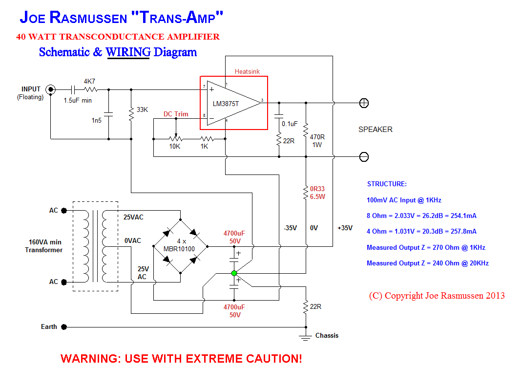

Dave, what has happened to all my links/graphics from my website?
Go back to Post #1 and the schematic has disappeared and so has others, not just on this thread but also on the Elsinore thread. Seems to have happened between June 12 and June 15.
Some kind of Dutch server "weserv.nl" is involved and have no idea why. Got any idea? It's beyond me. Is it some diyaudio.com is doing behind the scenes? Or is it the host of my website where these graphics are stored and recalled from? Hope you can help.

I can't see any of the graphic posted at the beginning of the thread, the main schematic in Post #1 can't bee seen, it comes up as:
Joe Rasmussen "Trans-Amp" - 40 Watt Transconductance "Current Amplifier"
All subsequent measurements and graphic have disappeared. Are they gone forever?

Joe,
The images are there but seem to be buried inside a “strange” URL.
This is the URL behind the image on the 1st page.
< https://images.weserv.nl/?url=http://www.customanalogue.com/diy/Trans_Amp_Schema_Wiring_Caution.gif&w=800&t=fit>
If it chop off the part of the url before the 2nd http, and remove the &w=8… after gif i get the attached image.
Here the direct url in between image tags (same as the attached):
The extra bits could be stuff Jason had to add because your website is not https:

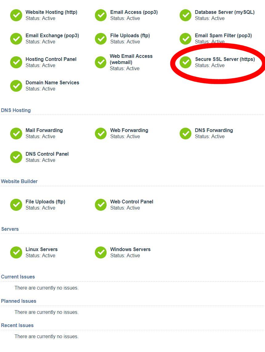

I just got the phone and initially they just fobbed me off and I had to persist. I know that my own website comes up as "http://www.customanalogue.com" and so there is no "s" when I look at the URL address in the browser.
Is this the source of the problem. The lady with the Filipino accent said that would cost me extra money, so I asked why I had to pay extra for something that seems free to everybody else. She said that I had to pay an extra $70 and I asked why for something others had for free.

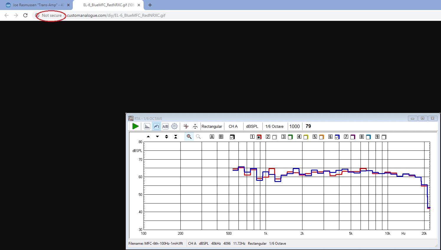

I just shortly ago went on the Elsinore thread and tried to upload:
http://www.customanalogue.com/diy/EL-6_BlueMFC_RedNRXC.gif
When clicking on link inside
If this is a HTTPS problem, why does it say, see below attachment, that HTTPS is "Active" and yet the Filipino lady wanted an extra $70/year?

Your website is not secure, it does not use secure socket layers and your visitors are not safe then. Some hints on
