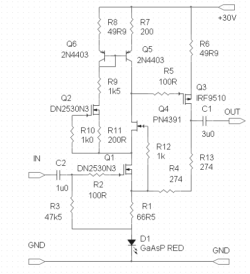

The "Liniac Inspired" circuit has been working in my living room setup for the better part of a year now - no complaints about the sound. I'm thinking of trying this variant using one of the Supertex depletion mode fets. Most likely I'll need some sort of compensation cap, but I'll find out when I fire it up. Since I don't have any models for the Supertex fets, I'll be building this one up on perf board first. It'll probably almost work with the values shown in the schematic posted here, with some tweaking for the biasing current source. Another possibility would be to use a PNP Darlington rather than the P-channel mosfet for the output circuit - the higher transconductance may give lower distortion.

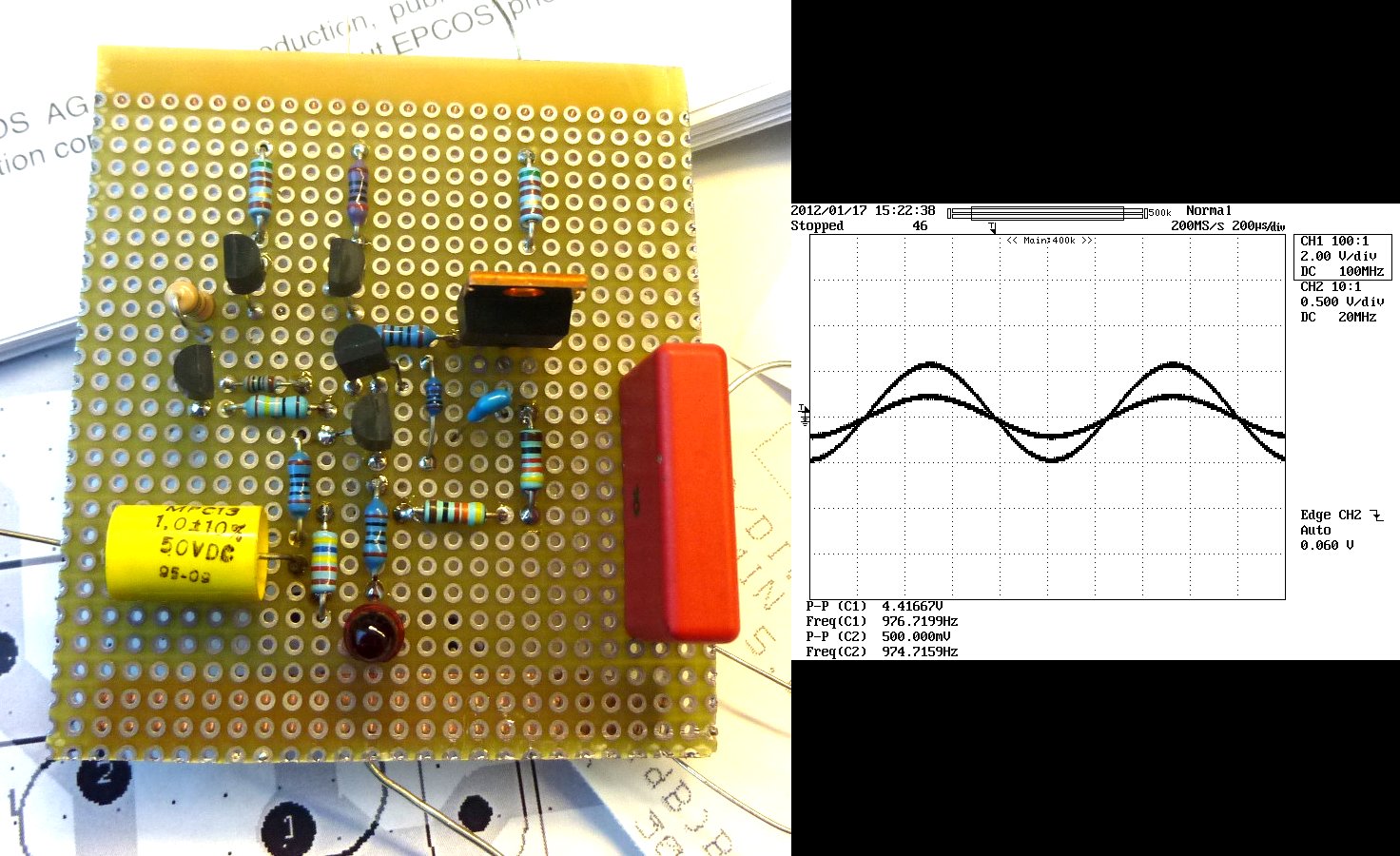

I have all the components spotted in place on the perf board. Tomorrow might see this baby all hooked up and ready to test...
Things are easy to build on perfboard, and this ocircuit makes a fairly compact module, even with no real effort to make it compact - the board is ~2.5 X 3 inches. Attached is a picture of the breadboard and response scope picture. I'm going to need to add bypassing to get real HF behavior, but from inital observations, the circuit might need 10-20pF of compensation. I'll need to add the power supply bypass and carefully calibrate both my scope probes for flat response before I can look more closely. I can say this - the thing is fast....

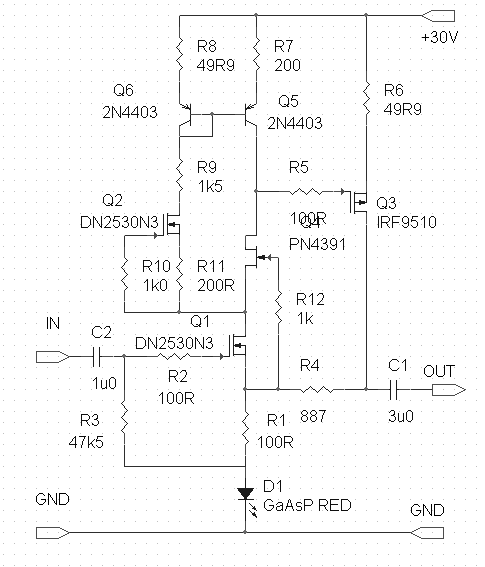

This is the latest schematic to center the output voltage and up the output fet quiescent current to 20ma. I think it'll stay this way for a while. I'll want to look at the square wave response again to set up the compensation, which will be somewhere around 20pF, I think.

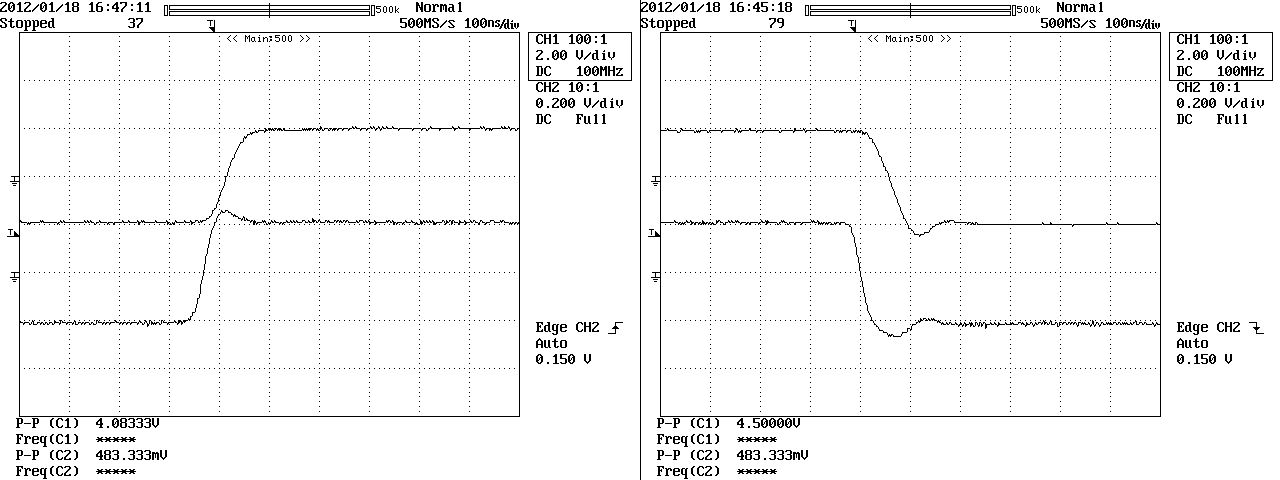

Attached are the rise and fall times of the previous circuit with a 33 pF compensation cap. It looks like the line amp is following the input without any extra garbage. The ringing on the waveform fall time is due to ringing from the source - plain and simple. Next up might be to throw it at my HP 8903 to check THD. I suspect it'll be low.
Edit - for the sake of clarity, the top waveform is the output, and the bottom is the input.

Read the posts - I'm now calling it "Liniac Inspired", as I'm sick and tired of all the quibbling that really has nothing to do with the circuit. The idea I stole from the Liniac articles (besides the basic feedback pair) was stiffening up the drain of the input device with a current source. This is all explained in the thread.
The problem this particular circuit addresses is to get a low gain buffer (gain <10) with good output centering and low distortion . A similar circuit with a current source at the source of the input device makes a heck of a unity gain buffer, and I used said buffer until I came up with this circuit. The first incarnation of this circuit is in my living room system. The second one will be possibly getting some measurements with my 8903A this weekend.
