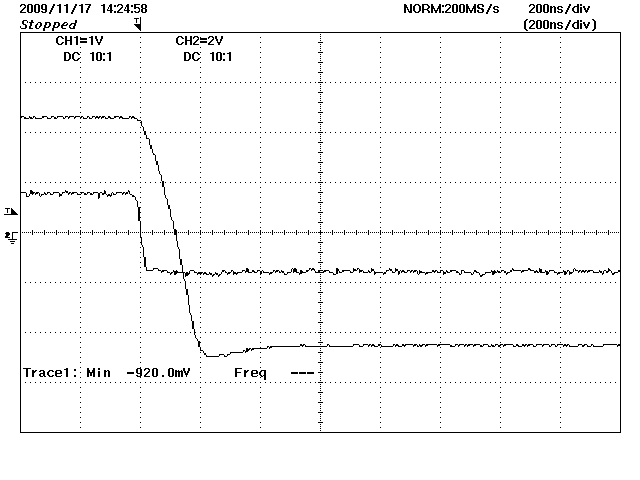

As promised, I looked at the line amp square wave response with 6ft of cable terminated by a 10k resistor. The cable caused a small increase in output undershoot. I have some nice IMB 270 pF polystyrene wrap and fill caps at home, so I tried the equivalent amount of capacitance as compensation, and the response is nice and slightly overdamped, the way I like to see it.

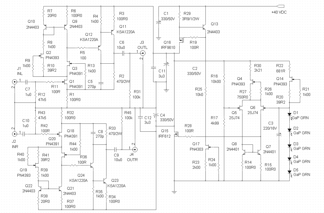

Attached is a schematic representing the current state of affairs. For anyone trying to duplicate this circuit, Q2, Q4, Q14, Q17, and Q19 have source resistors selected for the proper value of drain current (10mA for Q2, Q14, and Q19, 1 mA for Q17, and 5mA for Q4. These values will need to be different depending on the FETs you have on hand. Q3 and Q20 were selected for Vgs > 5V at 2mA drain current. Q1 and Q18 were matched for Vgs at 10 mA draiin current. Q5 and Q6 were matched for Vgs at 2 mA drain current.

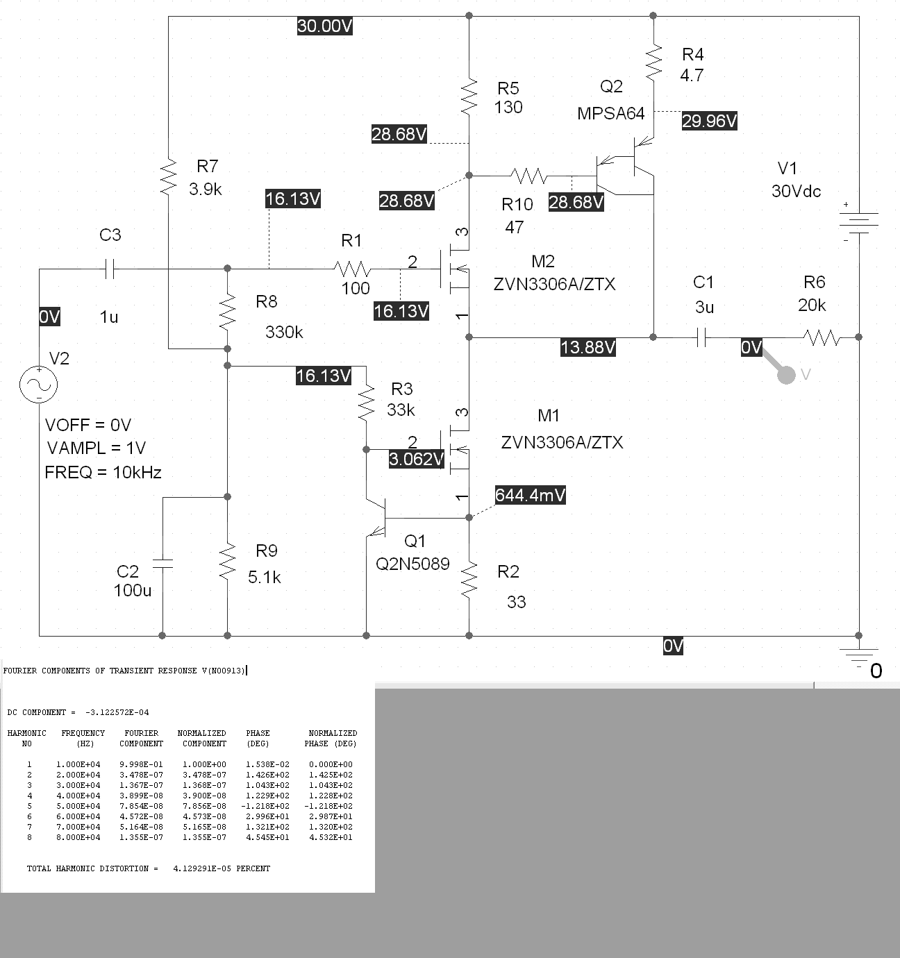

I had a little extra time today, and simulated a bipolar cascode with the base circuit referenced to the summing node. THD is slightly better than with the PN4391 JFET cascode - 0.0041% vs 0.0044% or thereabouts. Distribution of harmonics is about the same, with the overall levels on each harmonic in the JFET cascode just a little bit higher. This says nice things about the PN4391. I may try the bipolar cascode down the road, but I will have to use a clean current or a heavily filtered split resistor to drive the base so that I'm not injecting any nasties directly into the summing node.

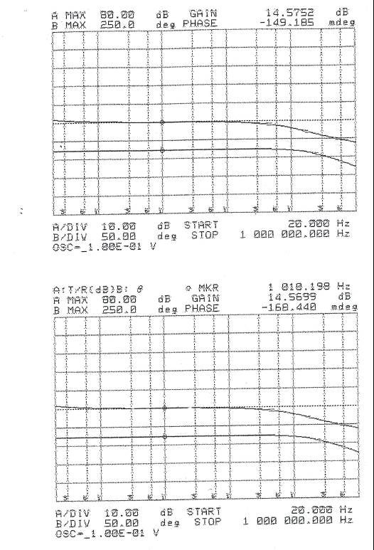

I finally got this line amp into a box with an RIAA preamp along side it, with the intention of bringing it to this year's Burning Amp. Fate intervened, and I'm still working on the preamp box. Here's the response curves for the "Liniac-Like" lineamp. Tonight I get to hear how it sounds (maybe).

It's not all that complex - you're seeing both channels plus the regulator in the schematic. When I get some time, I'll talk about what's going on and dissect the thing into its functional blocks.

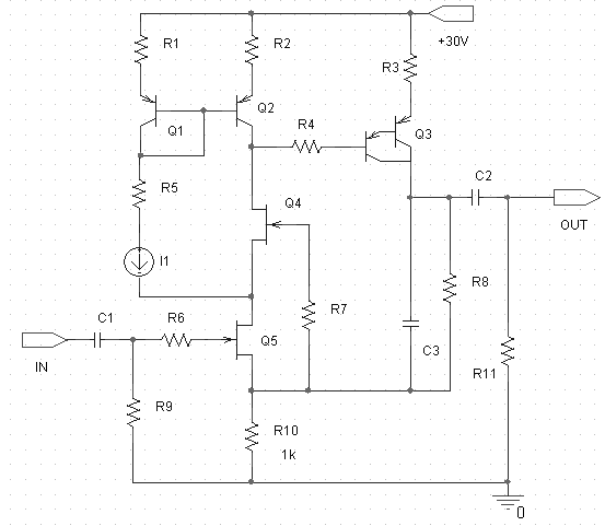

This is the basic skeleton of the "Liniac Inspired" (try to quibble with that) line amp. This satisfies several requirements I set forth 1) single-ended 2) single supply 3) non-inverting 4)output quiescent point is fairly close to 1/2 Vcc for good signal swing 5) gain between 5 and 10. It turns out that it's fairly difficult to satisfy these requirements without something that looks a lot like an opamp. It's easy to do with an opamp, but that's not the point of this exercise. Other attempts I made at a line amp with gain got abandoned quickly because that didn't sound so nice, so I've been getting by with unity gain buffers of various types until now. This is actually a variation on a unity gain buffer circuit I've been using that has 100% feedback - more on that later.
The main gain element in the circuit (the boss, as it were) is jfet Q5. jfet Q4 cascodes Q5 and pins its drain at a relatively constant voltage. So far, this is like a common source amp with cascode. Q5 drives PNP darlington transistor Q3, which is fed back to the source of Q5. Originally, I used a circuit like this as a unity gain buffer, so that the drain of Q3 was fed directly back to the source of Q3 with no intervening resistor. Small changes in the Q5 drain current get fed directly back to the Q1 source, in effect multiplying the effective transconductance of Q5 many times. This results in a really good buffer, especially when Q1 source resistor (R10) is replaced by a current sink. At any rate, I've used a circuit based on this principle for a unity gain line amp for quite a while, but I wanted something with a bit of gain.
Back to the chase - the inspiration I got looking at Hood's Liniac circuits was to replace resistive loading at the Q4 drain with a current source. Now any changes in the drain current of Q1/Q4 are resisted by Q2, so that any changes, no matter how minute, are shoved directly into Darlington Q3, where they are multiplied tremendously (a good Darlington has huge current gain) and fed back to Q5. Resistors R8 and R10 set the gain of the circuit. Current source I1 provides additional bias current to Q5 that is not directly in the gain path, boosting the transconductance of Q5 and reducing distortion. Biasing Q5 with a current not directly in the gain path allows it to be cascoded with a simple jfet, as only a small portion of the total drain current of Q5 (~ 1/6 in the actual circuit) is flowing in cascode fet Q4. An asymmetric current mirror(R1-2, Q1-2) provides a scaled-down portion of current I1 to the drain of Q4, and acts as load for Q4. Resistors R4, R6, and R7 act as stoppers. C3 is a compensation capacitor. R11 grounds the other side of output coupling capacitor C2
