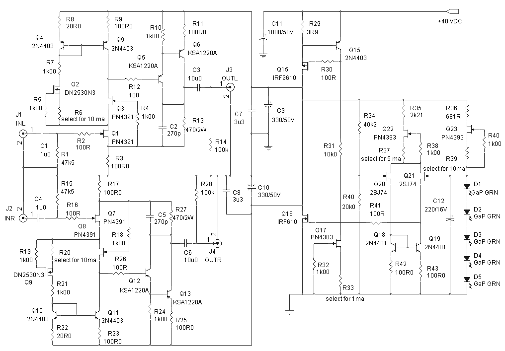

OK, some more dumb queries:
PN439x series is not always available here without placing large parts orders, cost etc.
I understand the "x" is same as in J111 for PN4391 and the characteristics are cross-
referenced in some supplier cats. Is this so and applying also to J112,3? If OK, I presume
straight substitutions might be acceptable....or not?

I did some looking around, and at least in the Siliconix catalog, the J111 series and the PN4391 series come from different process families (NC vs. NCB), so they aren't necessarily a real cross. This is not to say that the J111 won't work in place of the 4391, but it's probably going to act a bit differently. You might try looking for the PN4091-4093 series. I tried simulating using the 4093 in place of a PN4393 in one circuit yesterday, and the result was ok. The PN4091 and PN4391 series (at least when made by Siliconix), came from the same process family.
Thanks for your assistance, I also sorted through Fairchild's JFET clones and found that all their switching N types are process 51.I tried simulating using the 4093 in place of a PN4393 in one circuit yesterday, and the result was ok.
That's PN409x, PN439x, J11x, 2N5639 and probably others too. They seem to go in threes everywhere through the number systems. GP amplifiers and RF types are likewise standardised to just 1 or 2 processes each so I guess their process capabilities were considered good enough to cover all types. Makes you wonder about what you really have as a product, though 😕

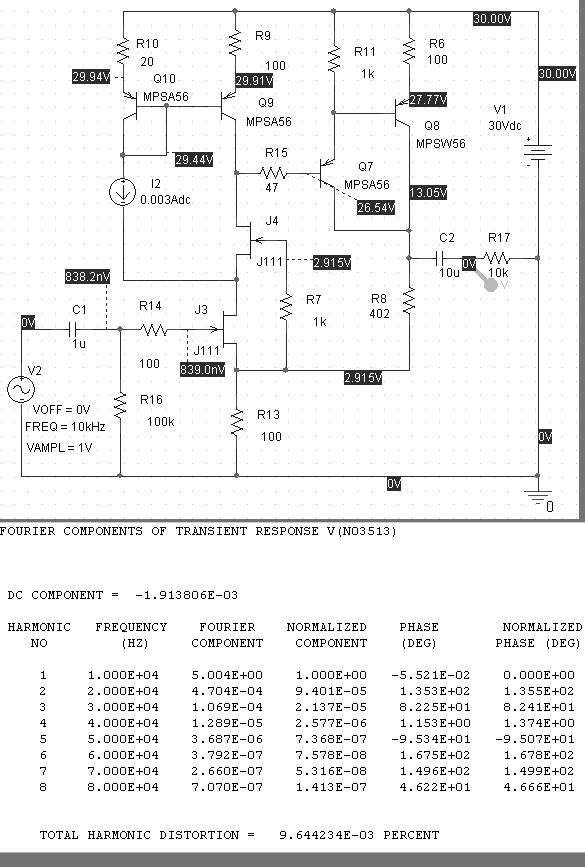

As to the suitability of the J111 for this application, I'll have to do a simulation to see. If I recall, the IDSS specs for that series are on the low side compared to the PN4391 series, especially in the case of the J113. This may not matter all that much as you can cherry-pick in a bunch of parts to find what you need. It will make a difference in the simulation, as the cutoff voltage for the J111 model will likely be lower that that of the 4391. The part will work anyway if you bias it right. The distortion will probably be higher, but likely still quite good.

I've been wrestling with the J111 in a simulation, and it indeed will need a lower bias current to center the output voltage properly, resulting in higher distortion (I'm not entirely done yet, but that appears to be the general trend). Electronic Goldmine is selling NOS National PN4391 at reasonable prices, and I noticed that they do ship to Oz. This may be an alternative. A padded postal envelope may not be all that expensive. Avoid UPS for international shipping.
These are the results I've obtained so far with the J111. It needs lower bias current as dictated by the model in PSpice, so the distortion is higher. One could possibly cherry-pick devices with higher IDSS /cutoff voltage to fix this. Knowing Fairchild, they might take the devices with higher IDSS in that family and call them PN4391s, leaving the also-rans for J111 duty. It's hard to say.
Thanks again for that work, it's instructive to see the circuit operation with different devices. It seems that to do the design justice, the PN4391, among all the available low-cost TO92 parts, is the only suitable one. 'Seems 100-off prices are around 25c US so I'd better get an order together and pursue this properly.These are the results I've obtained so far with the J111. It needs lower bias current as dictated by the model in PSpice, so the distortion is higher.
There are quite a few other semis but most seem common, low cost types. Do you have any comment about selection of the VFET regs (IRF612 doesn't seem available). Will any complementary low power TO220 VFETs work there? 2SA1220 and PN4303 are unusual, but I guess every DIY has a stash of 2SJ74s somewhere. Are the FETs both just there as GP amps?
My apoloogies to others reading the thread and finding a bit of a parts-fest. However, I hope we'll also get a feel for circuit operation this way. Thanks for your patience. 🙂
The PN4091 looks like it would also be a suitable substitute for the PN4391. The PN4391 is more common, at least in the US. If you were lucky enough to happen on an NOS stash of the original TO-18 part, the 2N4391, these would work as well.
I had a close look at the schematic, and there are a couple of mistakes. I willl clean it up and repost.
The KSA1220 is a TO-126 case fast bipolar suitable for power amp VAS duty. Comparably fast devices with a VCEO of >40V would work. The KSAs are cheap, and in stock at Mouser. I use them for VAS stages in my power amp experiments. I used the same part number for both parts of the discrete darlington so that I could mount both transistors on a common heat sink. It may also be possible to use a device in the TO-92L case or one of the Zetex E-line package devices and ditch the heat sink. I'll have to stare at the simulation and calculate the power dissipation to be sure.
In the power supply, I used the IRF612 because I have a couple of tubes of them. IRF610 or 510 would work just fine. An IRF9510 could be subbed for the IRF9610 - again, I used what I had on hand. The PN4303 in the power supply is nothing more than a current source set up for ~1mA. A 2N5457 or J202 could also work. In the case of the 2N5457, you'd need to increase the value of the dropper resistor in series with its drain (R25) to 20k or so.
I'll post more comments about the circuit as time allows. The most important will be how to select the jfets used in this circuit, as you can't just sling the preamp together from a set schematic and expect it to work, unless you get lucky - all the jfets need to be selected, and some resistor values may need to be tweaked depending on the results of the selection.
