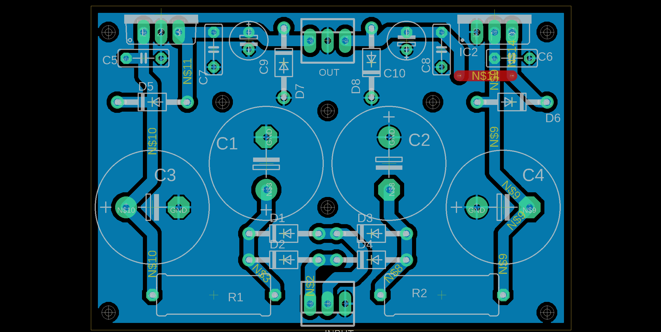

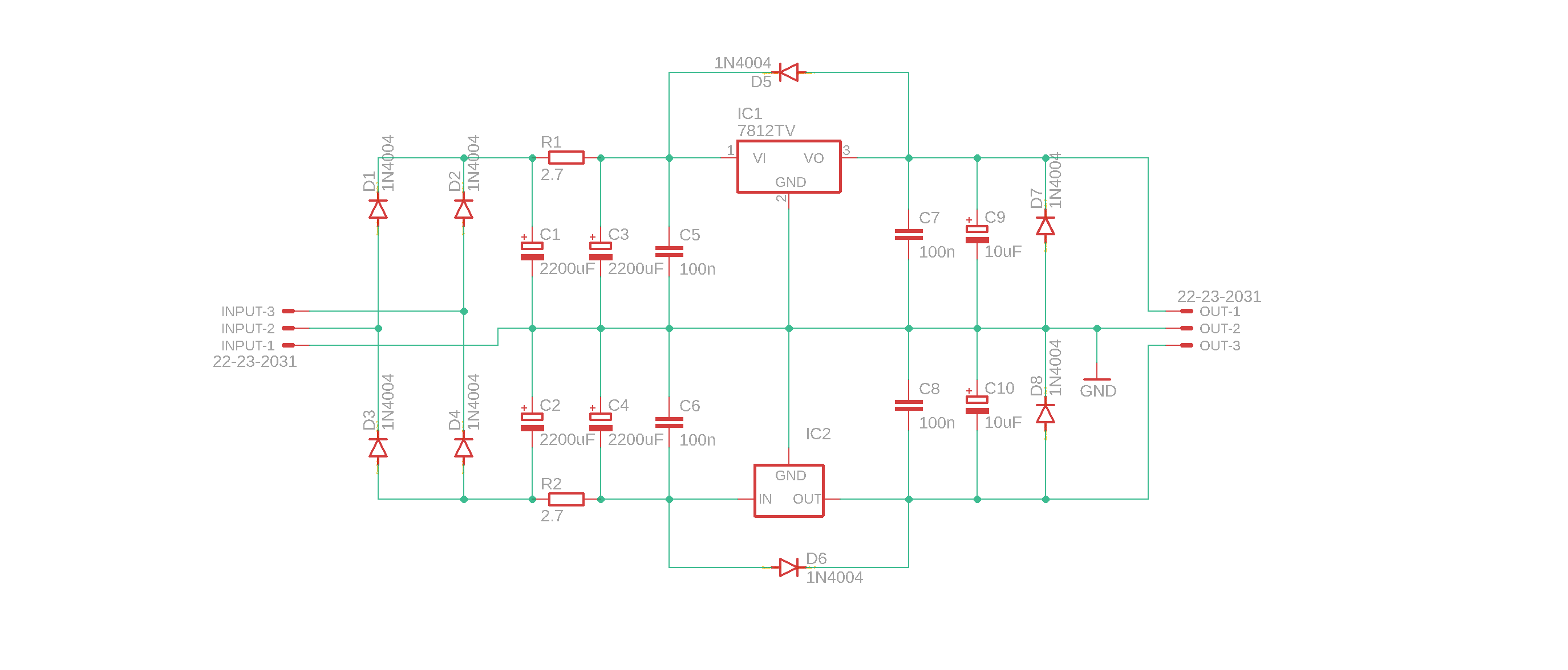

Attempt at my own PCB
I would like to make my own etched PCB.
here is the power section
please give your suggestions , as i am totally new to this stuff.

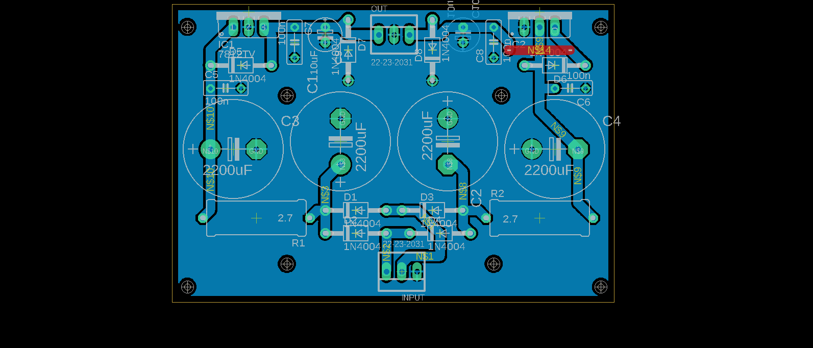

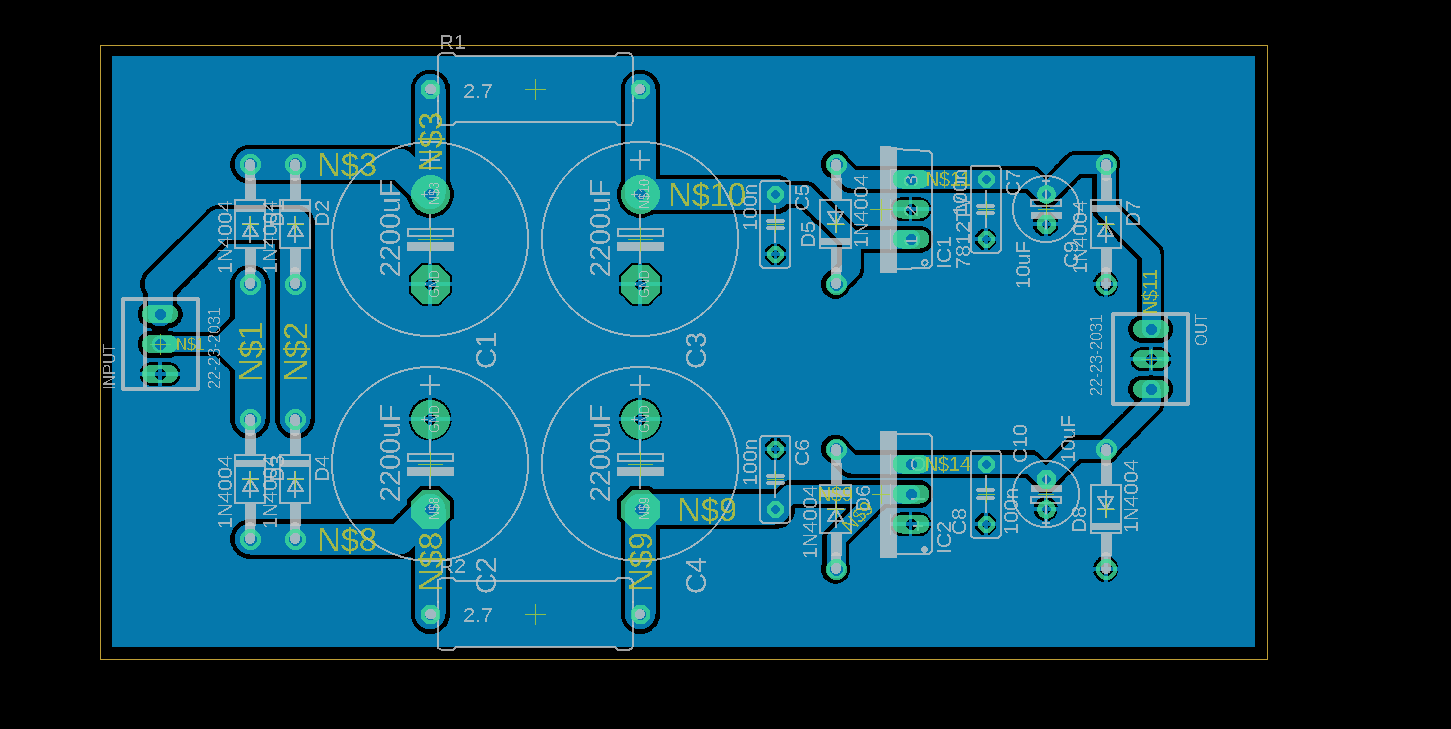

Thanks for reply,
as this will be diy type so will be using salvaged heatsink.
Can someone please check the schematic
is the schematic correct ?
also i have rearranged the pcb layout so can use old huge heatsink if needed
the previous one was attempt at layout used in mini psu by ESP.

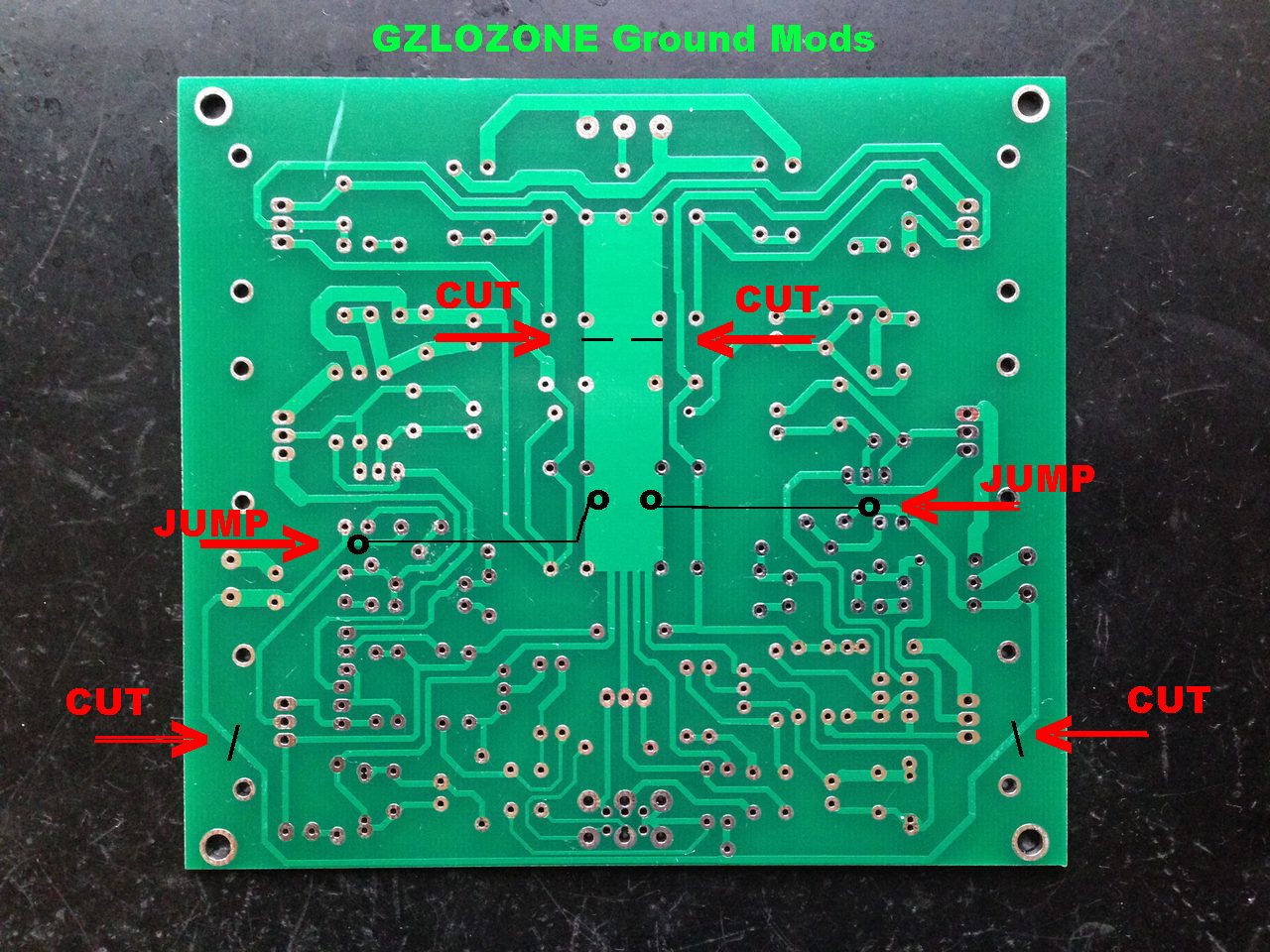

Since no input was received, I tested and selected the transistors prior to assembly. BTW, the board in question is the "GZLOZONE ZERO ZONE V:2015 JLH1969H.P." board that has pretty much taken over the offerings on eBay and Aliexpress.
Before getting into the results, the grounding scheme needs looking at. There have been reports of a "ground loop" on the board that causes hum in some cases. There is, in fact, no ground loop, but just a very poor grounding scheme that can result in hum. (I think the reason these kits sell for so cheap is that the power and ground layout sucks and limits its performance, not something you want in a power amp...).
Worth mentioning, the fill on the component side of the board looks like a "ground plane", but it is not connected to ground anywhere. It's just a floating layer of copper.
Now see the attached pic of the solder side. The rectangle in the upper center is the "ground plane", just a pad, really. The xfmr center tap connects to it at the top via a short jumper. All of the post-rectifier smoothers and post-regulator filters are arrayed around the sides. At the bottom, three fairly thin traces connect separately to signal ground, the volume pot and filters, and bias networks. And then one thin trace fans out to the output and shunt feedback resistor on both channels. This is not a good idea. And it's about 100mOhms end-to-end - not a quality ground. That's the trace that is the problem.
Any impedance imbalance in the AC transformer and bank of capacitors generates a standing current on that ground pad, and develops a voltage across the impedance of the trace going to the feedback shunt R's. It's one of the worst grounding schemes I've encountered. There is no way it can "sound good" like this.
The fixes are marked in red.
: Cut the thin trace that connects input to output ground points on both sides.
: Cut all but a 1/4" of the ground "pad" right after the rectifier smoother caps, forcing the currents to mix before passing on to the regulators' end of the ground pad.
: Install separate ground jumpers on both channels from the output to the regulator side of the ground pad.
This puts line freq harmonics just a few dB above the noise floor, and makes the output dead-quiet.
It also helps to add jumpers from the ground terminal of each regulator to the regulator ground point on the pad, to lower their impedance. But that's not necessary for fixing the hum.
I'll go into the rest of the unit next post.

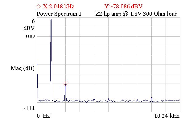

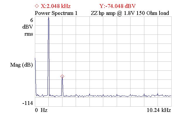

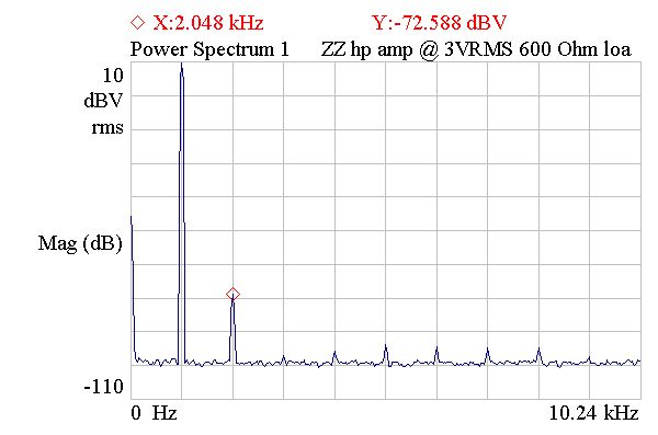

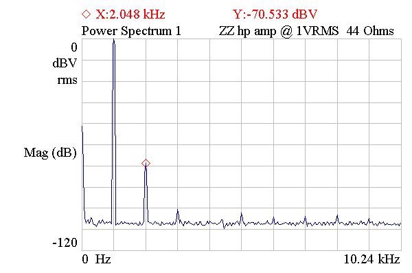

So I did 1kHz distortion measurements with 10k, 600, 300, 150, and 44 Ohm loads (see attached). Levels were adjusted to reflect the difference in sensitivity of the headphones.
The noise floor is clean in all cases. The H2 difference between 10k and 600 Ohms @ 2.8VRMS was only a couple dB of H2, roughly -82dB. At 1.8V into 300 Ohms, it actually improved to -84. At 1.8V into 150 Ohms, it started to increase, to -80. And at 1V into 44 Ohms, it was only -70dB.
So, this headphone amp does not drive low-Z phones well. And it is not best-in-class by any stetch.
I've learned a lot in my two excursions into JLH land. I've come to agree with sgrossklass's assessment; that they were very good in their day, but have been outclassed since then.

What an expert post - I wish I knew this when I tried to get rid of hum issues on my build for months on end (changing components, resoldering, metal shielding etc, etc). Succeeded to get it almost silent in the end, but not to this extent.
Sorry to hear that so much time was lost to this. It seems to be the nature of the beast, at least in this form.
It would certainly be interesting if someone did a layout that optimizes the power and grounding schemes, i.e. like one would do with an actual power amp...

I should say: I don't think my fix is "optimum" from a design POV. It just fixes the hum problem on this board. I would rather see "signal ground" treated like a separate low-impedance trace that follows the signal flow from input to output, with nothing PS-related on it, with signal gnd tied to pwr gnd at the regulator side of ground only. Maybe use the ground plane for power gnd. This is a pretty simple circuit, so that should not be too difficult.
Also, IMO, the regulators should not be spread apart like they are here. They should be right next to each other.
