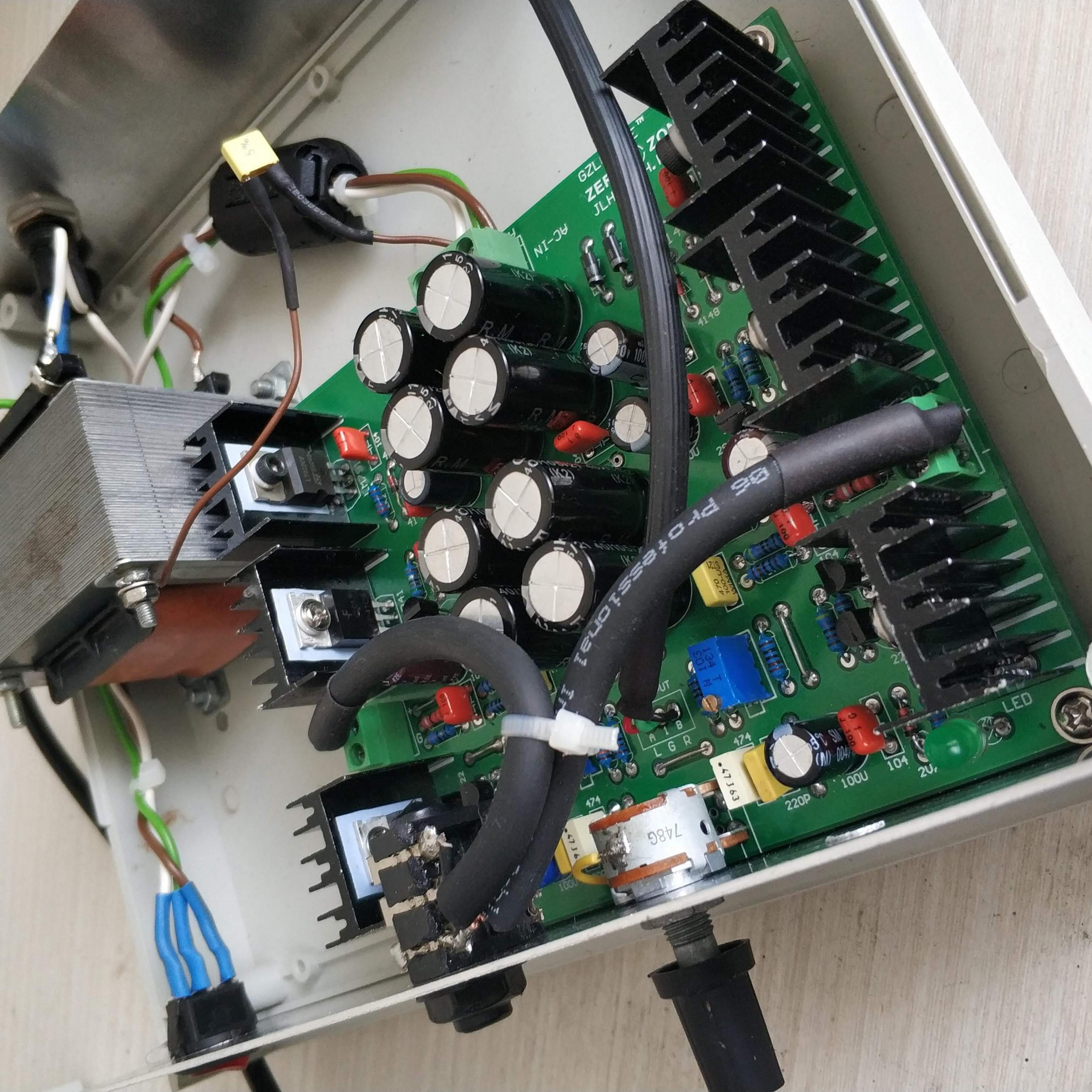

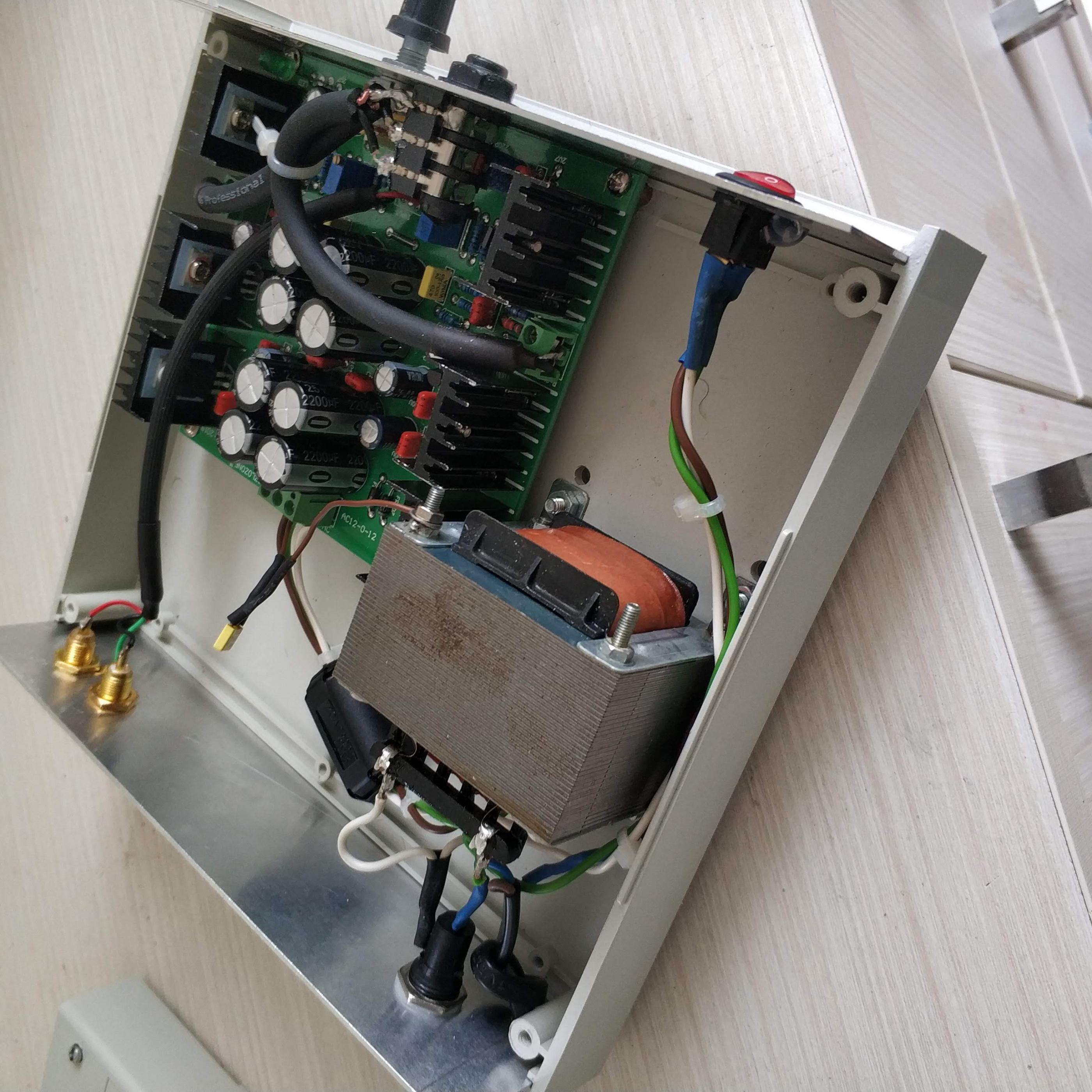

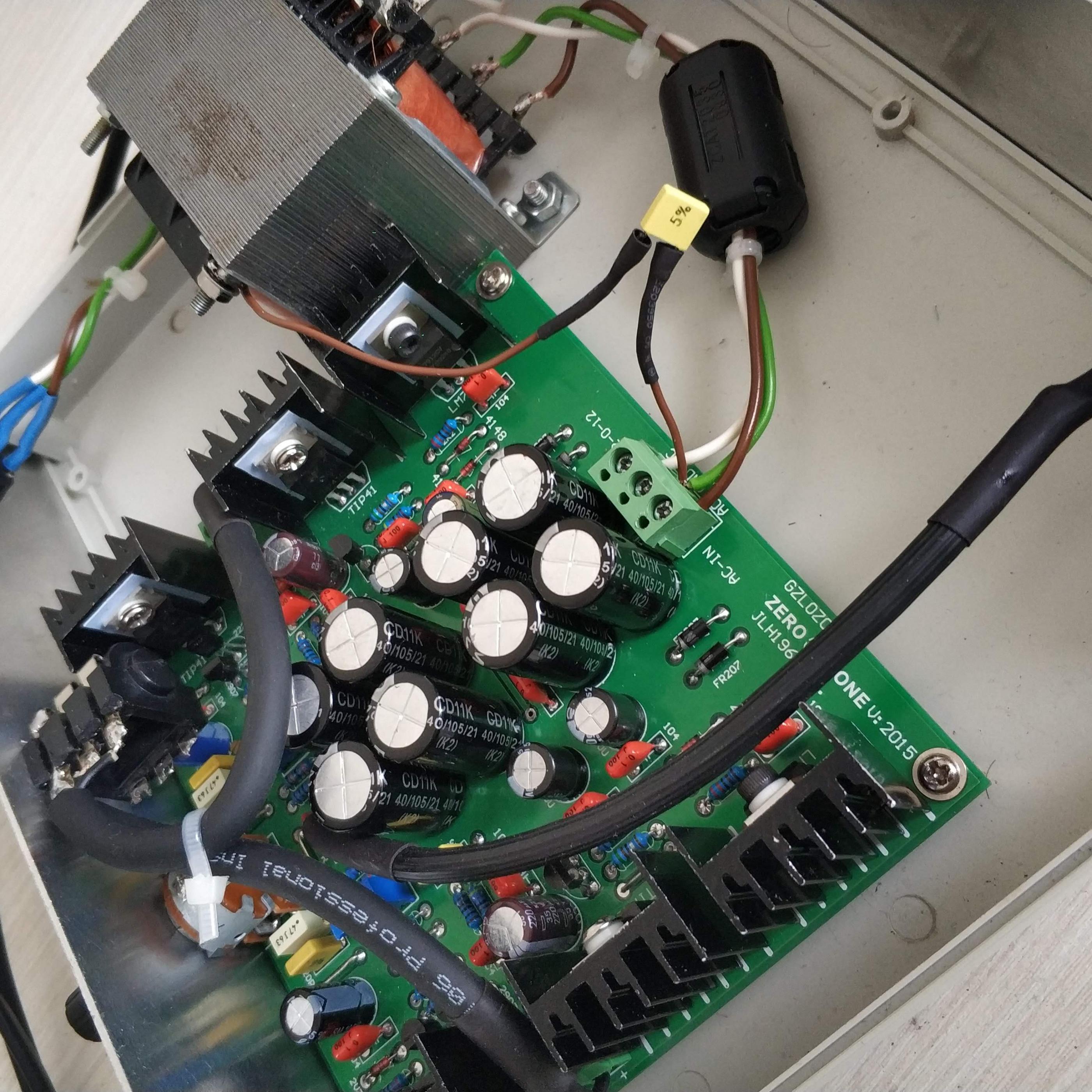

thanks for reply, now here is the situation;
i built exaclty the same amp but the (probably) driving to-92 package 2907 transistor at the left side and placed face to face with the 2n2222 is too sensitive to finger touch and i have a dj headphone with a spiral cable, the amp again too sensitive to playing the cable, in both cases, i have an audible and disturbing noise hum
any help will be appreciated:)
Noise hum is gone
Thank You ! Thank you !
It works. Now working to get rid of grounding hum and have stereo separation.
hi bro, i made a star ground to output, potentiometer and heatsink (grounding only one of them is enough)
also i grounded the transformer using a 470pF film cap to limit the current in any bad case,
input and output cables must be shielded cables...
check the pics
i could eliminate the grounding noise hum in a reasonable level and i m satisfied now, try these, it s all about grounding
Have you tried to separate the transformer?
You have it stuck to the amplifier and this usually causes a lot of problems (HUM).
you re right, it is a classical transformer and magnetic field leak may lead noise, it d be nice to try a toroidal 50VA transformer but i dont have...
the last thing is that my spiral form dj headphone cable can pick long wave radio signals and it is resulted with temporal noise depending it is position, if i insert, e.g, a 10 cm metal lead through the spiral cable, noise is completely gone regardless of cable form and position
