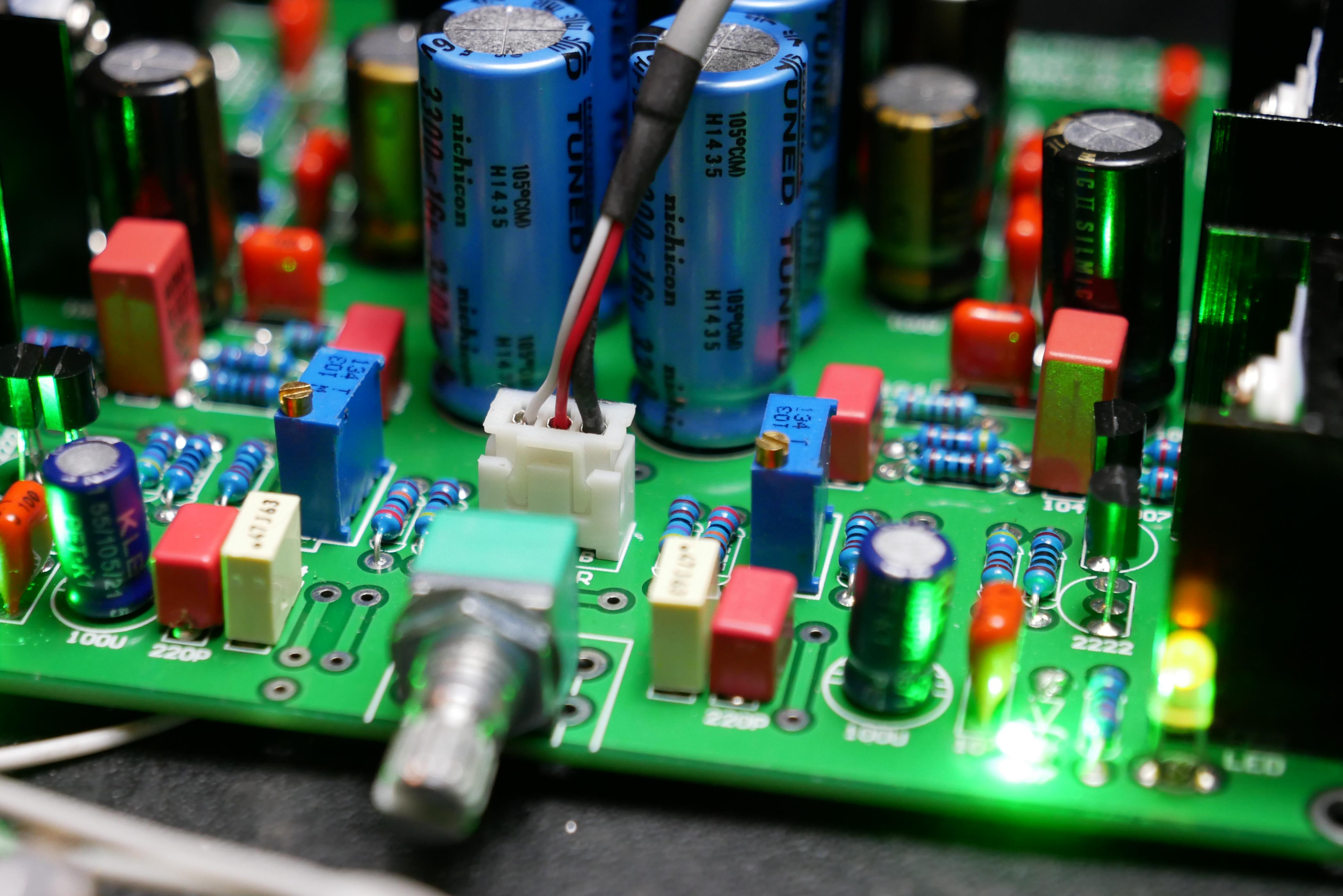

Well, with a little more time to experiment today I decided to try leds + diode instead of zener. I tested an smd green led with an FR207 diode thinking this would be about 2.8V, but I was surprised to find the led on its own was 2.85V. So I fitted the led alone and that worked like a charm. It starts up faster and the offset is more stable. Noise doesn't seem to have reduced significantly though, but again, that might be the source - a 16 bit nos dac. Anyway, here's a pic to show off the blue "individual tuned" Nichicons.
BTW if anyone has run SIMs or tested this amp with different bias current, please let me know if 10R is worse than 5.1R for a 300ohm load. Thanks!
Following sgrossklass advice, I increased R21 to reduce the current through the LED - 2k2 resistor drops the voltage across the LEDs to 2.67V with about 4.5mA passing through it. From cold, it took 90 seconds for the offset to drop to 40mV with the zener - with the LED and 2k2 it takes 22 seconds from cold. :) Noise does not seem to be significantly different - full volume on the amp, Foobar muted, there is a tiny faint hiss - quite hard to hear but it's there.
These are the LEDs if anyone is curious. ??????? 0805 LED ??? ?? ?? LED?-???

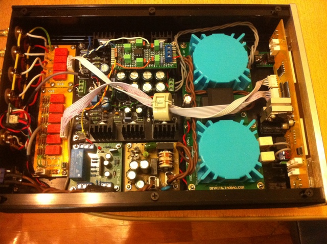

сделал свой худ с релейным регулятором громкости - коммутатор входов , интегратор не влияет , все ок , 1 мв , температура 30-40 градусов

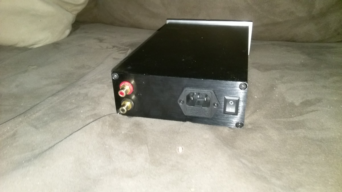

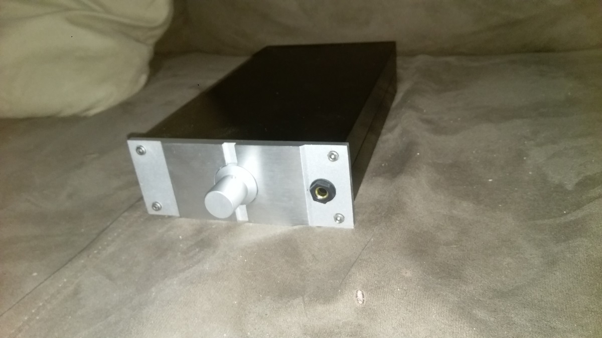

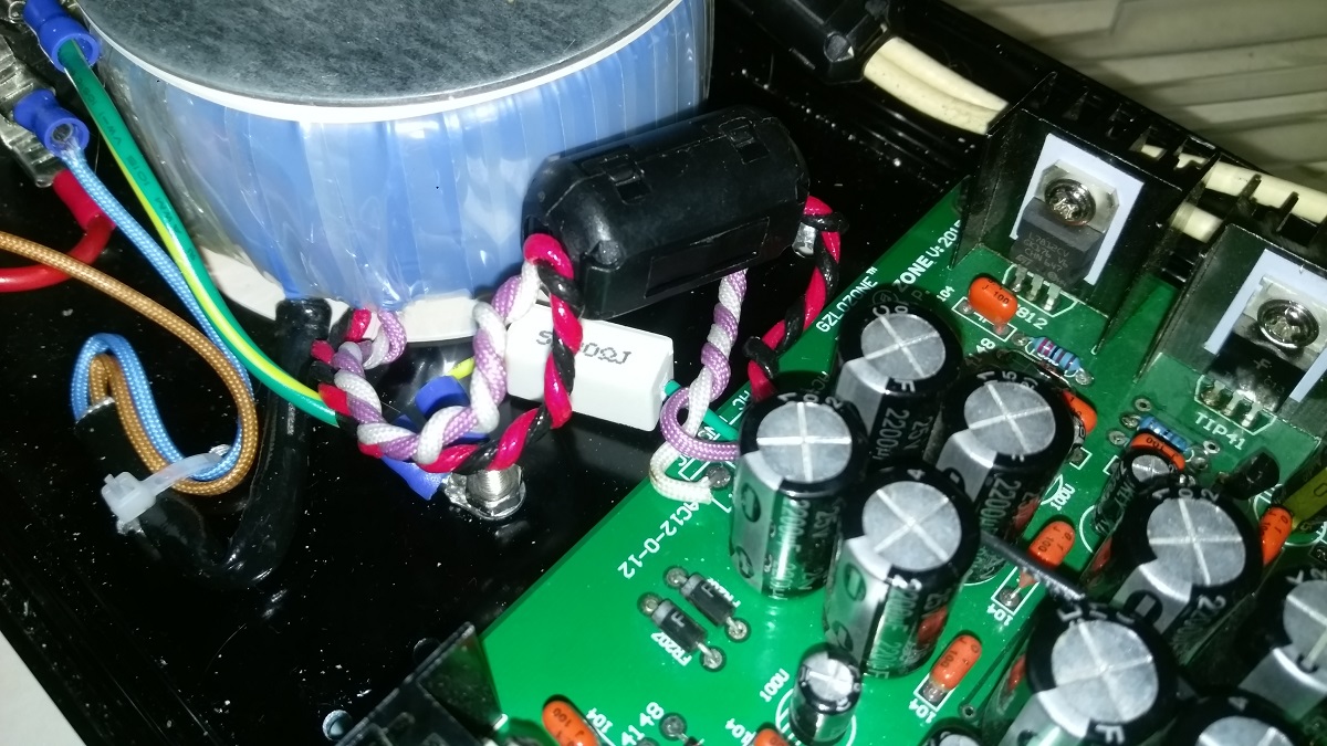

I would like to thanks Miles and every actors of this theard.
It helped me a lot to build this amp !
I had many troubles with ground noise issues in my first build. I finally get rid of those by isolating the fixation screw of my 100VA transformer from global GND and using a 30R link between circuit GND and case.
Now it works fine, the sound produced is not really high quality but it's fine when I want to listen some LP without waking up my neighbours.
I'm using the kit as it is supplied, no mod that we can see in previous replies. Offset voltage is starting at about 100mV and drops down to more or less 5mV after a few minutes.
Listining on AKG heaphones (K242 and K400) or Grado SR325.
Sorry for my bad English, I'm a frenchy frog :wave:.

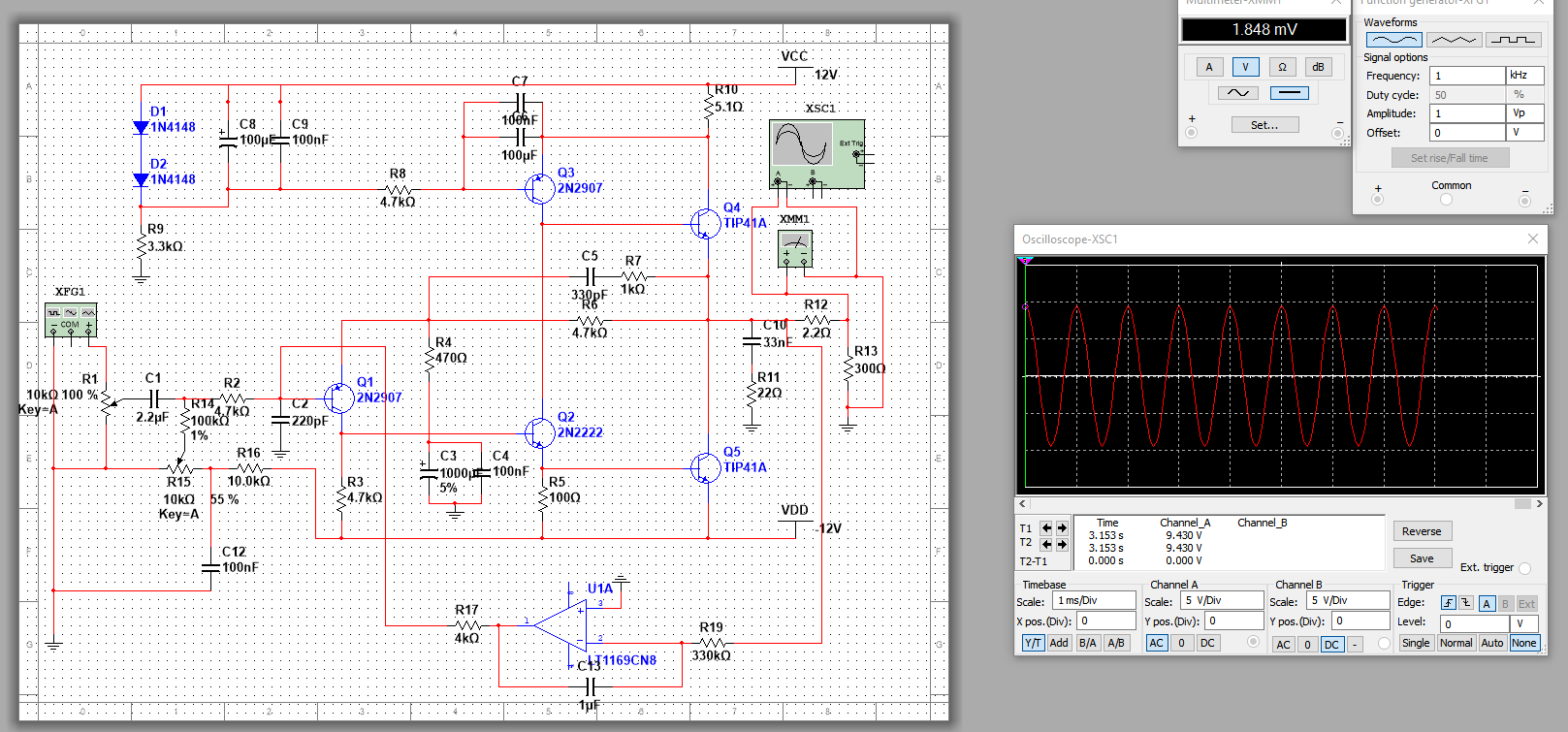

Sorry,you are may be not undestand me. I'm already builded servo dc, like on "shematic to change DC servo connection" on site "JHL" headphone amp | Rock Grotto
with BB OPA 2227. It's working, but dc offset about 62 mV on emitter Q1 ( on outputs left and right channels 24 mV) :смущенный:.
